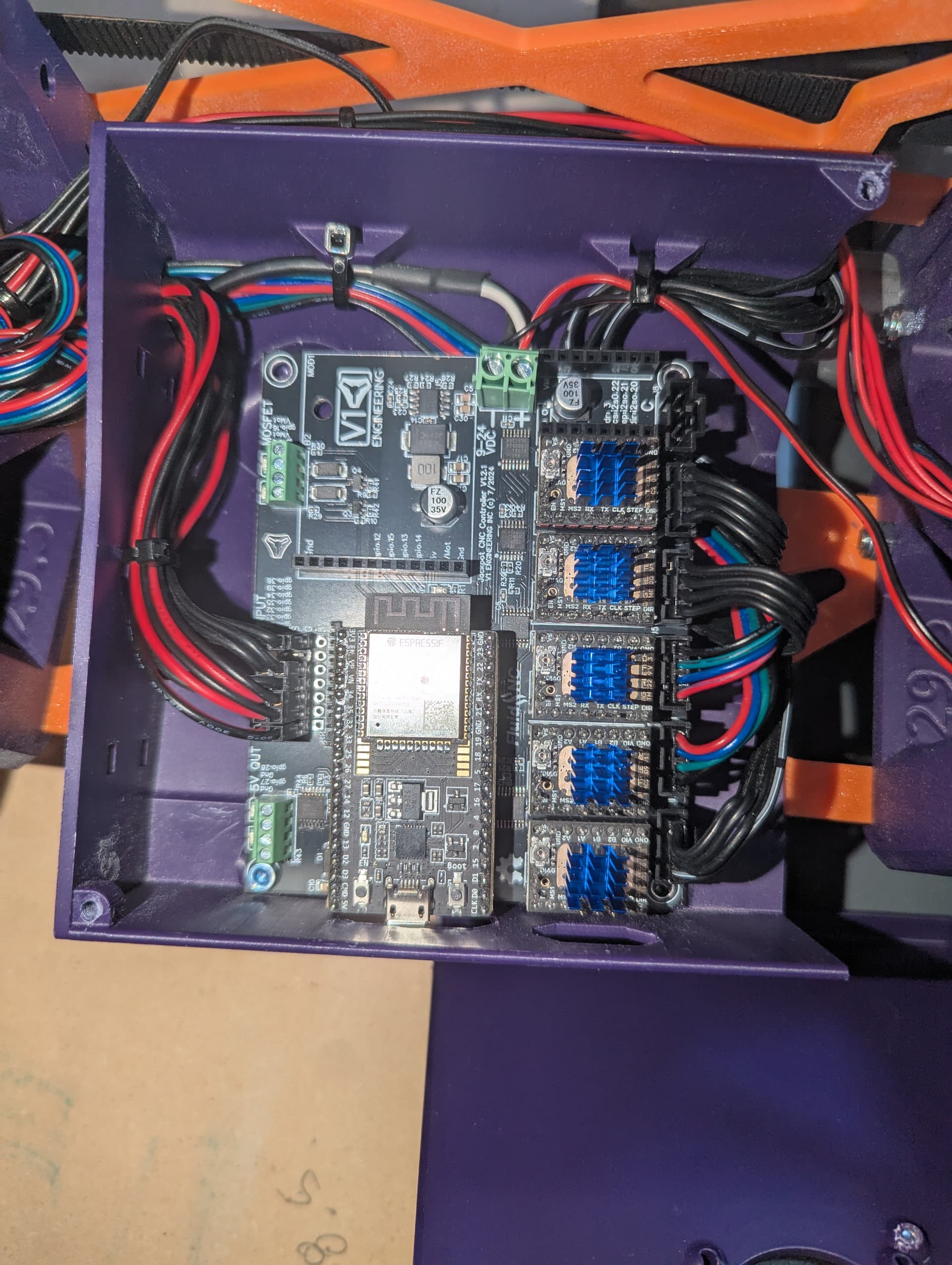

I’m trying to set up my lowrider. I ordered a jackpot with lowrider firmware but received a board with MPCNC firmware.
How do I change it?

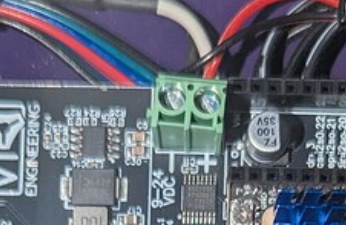

Also, the 24v power supply just flashes when I have everything plugged in. If I unplug any of the steppers, it powers up. Is there a way to fix this so it can power all five steppers?

And yes, it’s a white and black wire, it is hooked up correctly. It seems it does not have enough power to power all the steppers.
It has enough for many many many more steppers. Make sure the plug is in securely and please post pictures, of how you have things connected.

This is strange. I’m confident the power is secure.
It will only power on with only 4 steppers plugged it. It doesn’t matter what stepper I have unplugged, but it does need one of them unplugged. If all 5 are connected, it starts flashing.

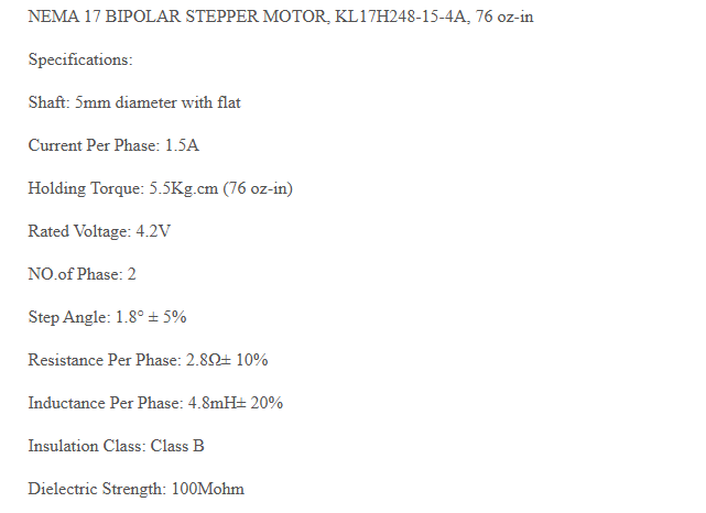

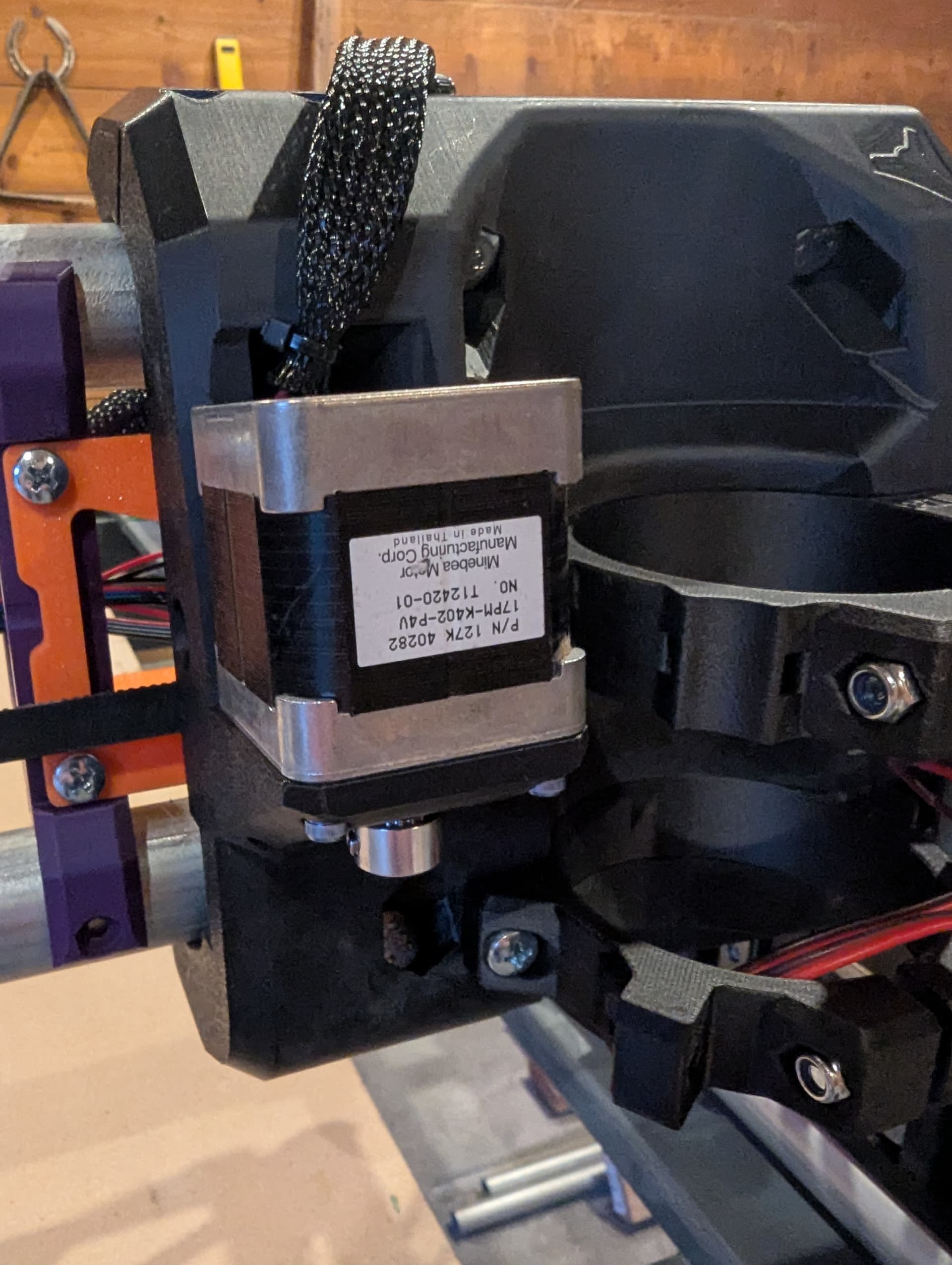

@vicious1 I’ve got the power issue isolated to the power supply. I’m using motors from a torn apart MPCNC that has served it’s purpose. I can’t find any info on the motors but assuming the power supply is putting out a full 2.5A, each motor only gets 12w. Doesn’t seem like many many more.

That is not how that math works. The steppers can not handle a sustained 100% current and the steppers run at like 4.2V. So no matter what your input voltage the drivers chop the voltage to match. We run them at about 70% peak power at best, plus we also run a lower hold current.
So at worst all the steppers combined would need about 26W, the 24V 2.5A supplies can handle 60W.

I spoke too soon. It worked once. Plugged it back in an hour later, same problem. Tried bending pins again. No luck.
You’ve tightened the power terminals so much it’s cranked the connector, might be worth checking you haven’t broke off the solder joint.
I know what you’re saying, I’ve checked it. This is not my first rodeo hooking power to boards. It didn’t take much to get the connector to twist, you can trust I’m not cranking down on it.

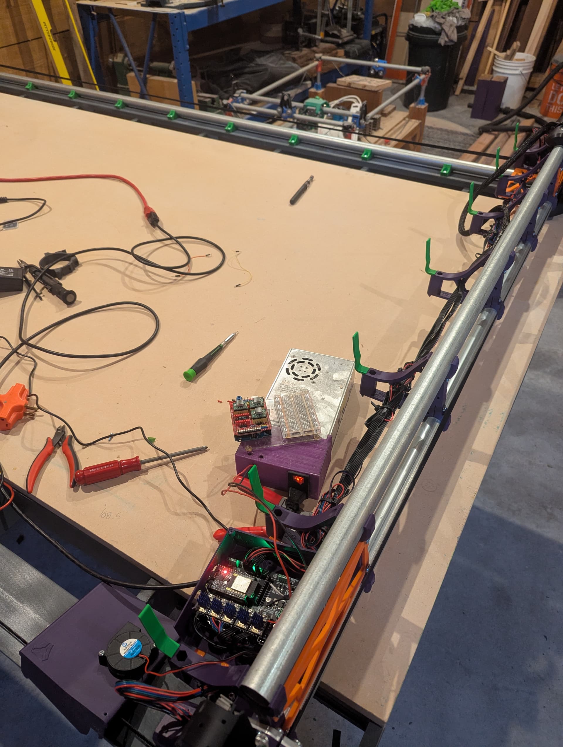

@vicious1, I have a known good power supply that I’ve used for years to power a strip of LEDs. It is rated at 60W. It cannot power the board either. I have another rated at ~65W. Same problem, but the flashing is faster.
Seriously, the only thing that I have that will power the board with all steppers plugging in, is my 12V 300W power supply.
I’ve isolated the terminals on the board and did the testing through a power connector.

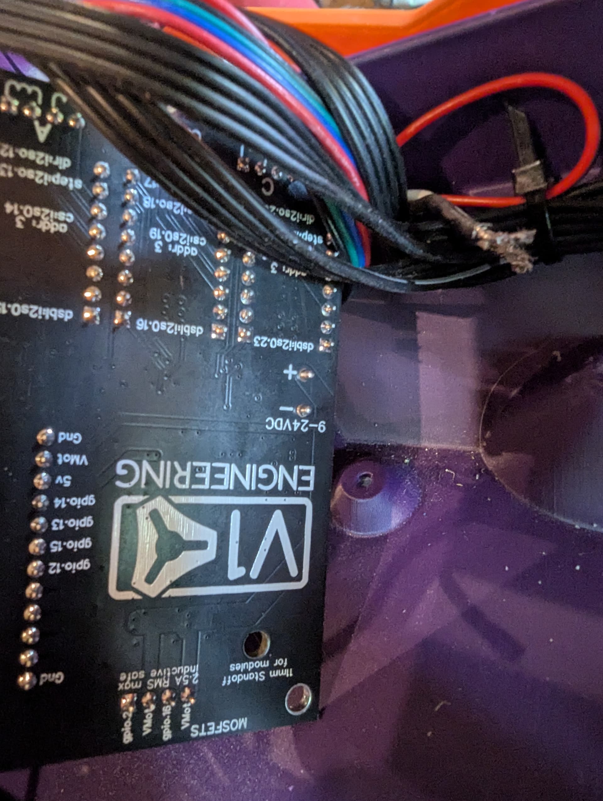

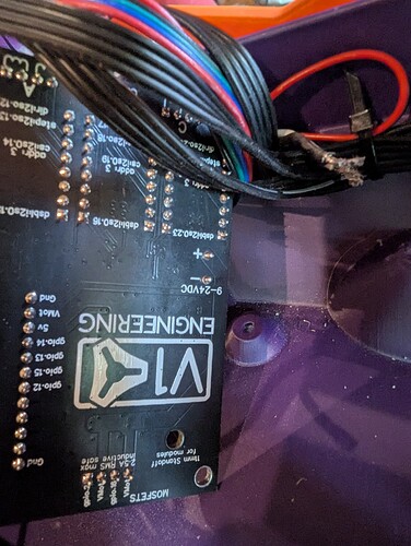

I agree with Dreyfus. This is now sounding like the solder joint broke. Look at the bottom of the board, the two large soldered pins under the power connector. We have seen this probably ten times now.
If you have a soldering iron, just give them a quick hit while you are under there. Those connectors are pretty weak and the reason I am working on another jackpot with new connectors.

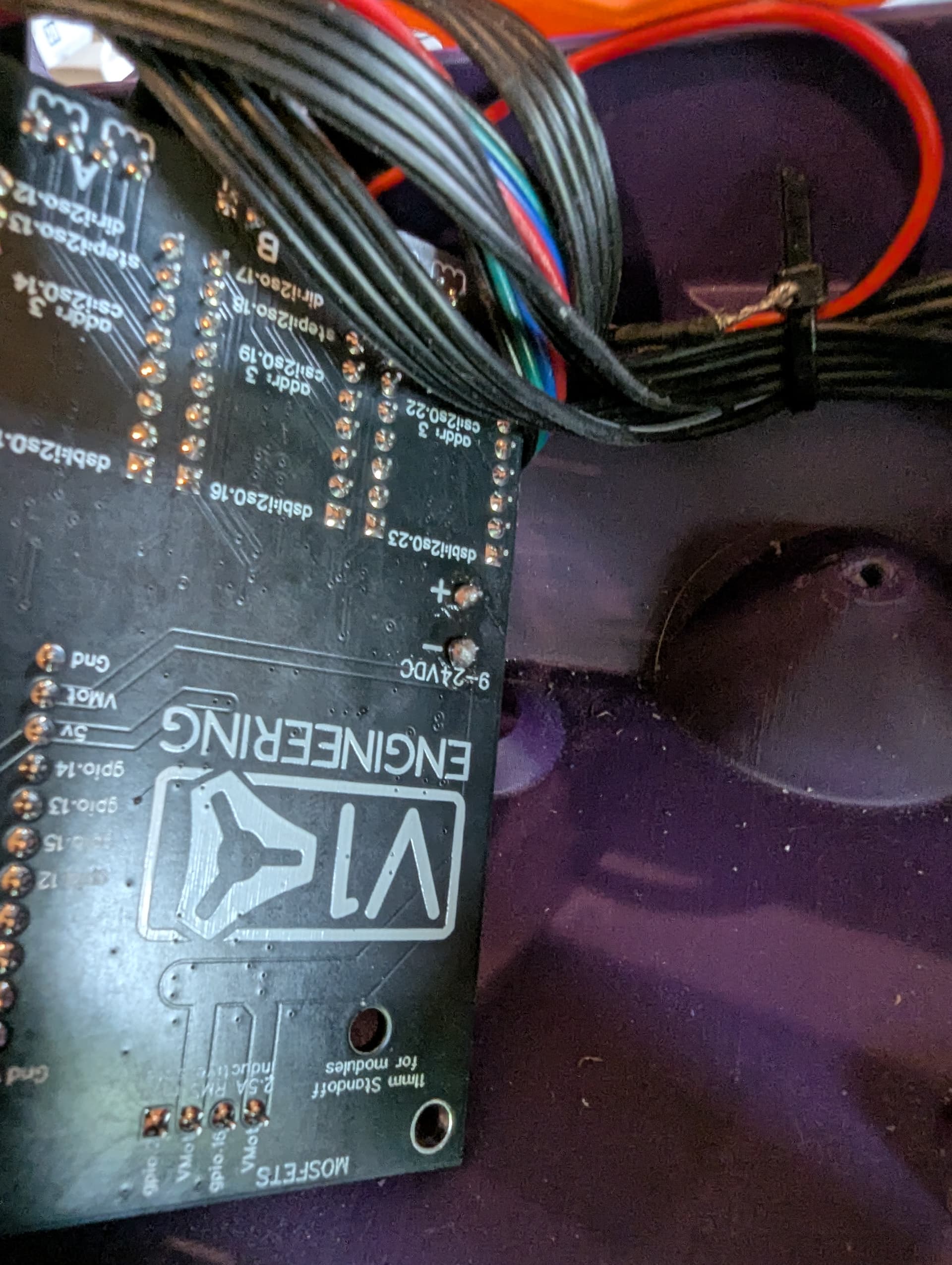

I really wanted your approval before I touched the board with a soldering iron. Thanks. I just did that. Problem still exists.

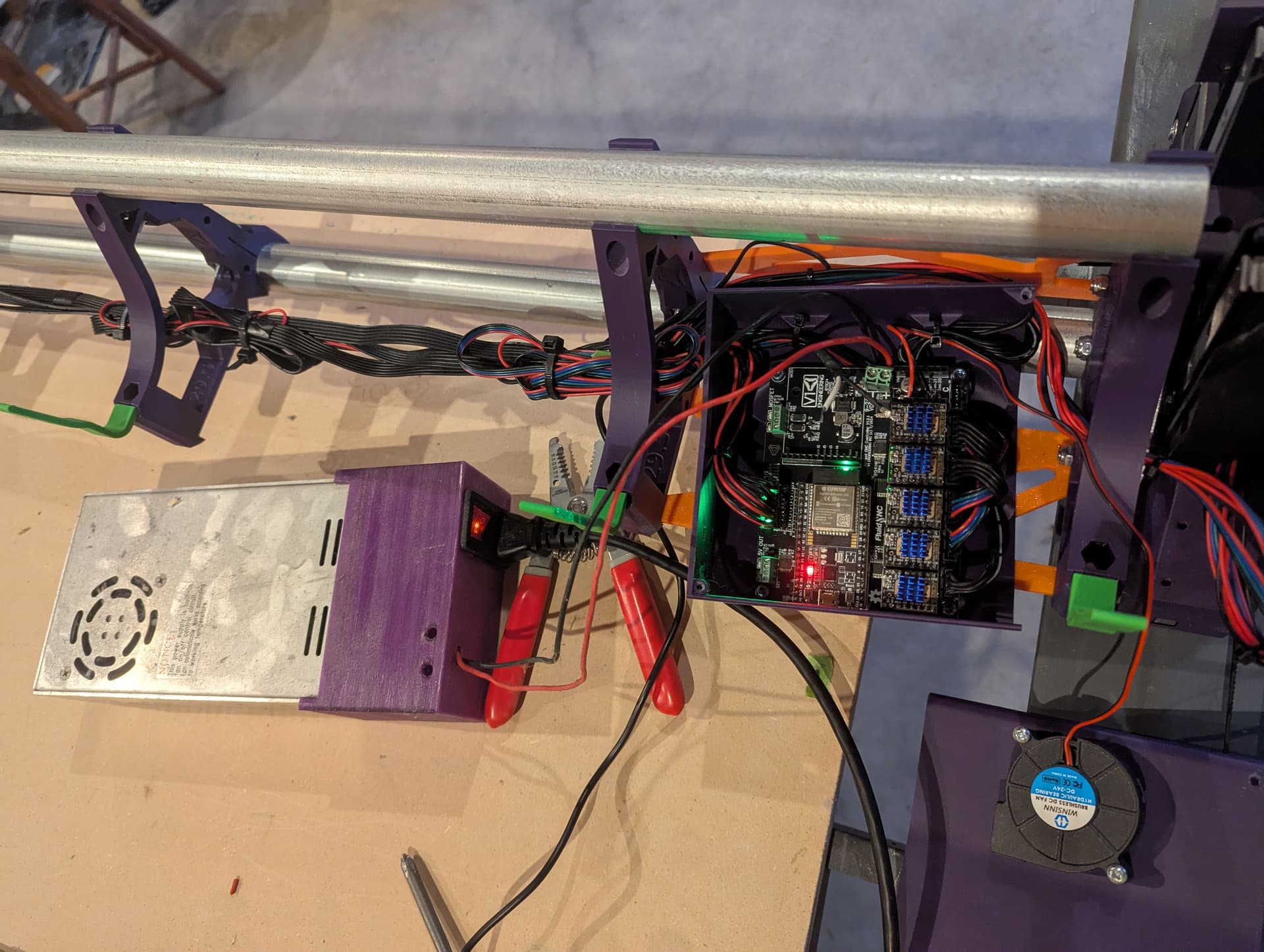

I did manage to find a computer power supply in a box that has 75w @ 19V. This power supply works.
So three of my power supplies under 65w do not work. At 75w we have magic.
Before and after soldering.

Let’s see if it keeps working, see if anything heats up, or quits. This is an odd one for sure.
I had the machine on for about 5 minutes. Everything gets hot, the motors, the drivers, and the power supply.
