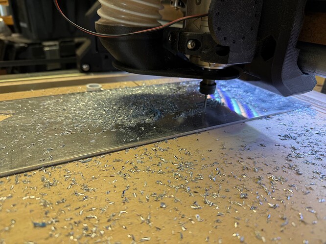

I’m a bit rusty but an online calculator suggests about the same moment of inertia for a 25mm, 2mm thick tube as for a 25x25mm 2mm thick L-section measured half-way up the centreline of the vertical web…
Its only about 5mm, but the LR4 does pretty well.
In the LR1 days, the MPCNC was better at metals. At some point, that changed. But it is always hard to compare when the LRv4 builds can often cut 4’ wide sheets.
