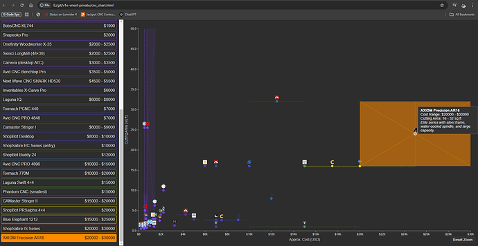

But, I think for this to start, you need to set goals
A) Pricepoint, what do you want
B) Main point to achieve, what do you want it to do.
B) is going to relate to a)
If you want it the most rigid small machine, like Ryan showed for 2500, then that will be a complete redesign, but what is the mpcnc missing? How does it need to be in the future.
Maybe run this like a Project Manager would run it. Goals, then design.
We are a VERY diverse group, Nothing satisifies everyone. I was very grateful to watch the LR4 proceed, although late in the project, and there were times were project creep really caused tough times.
