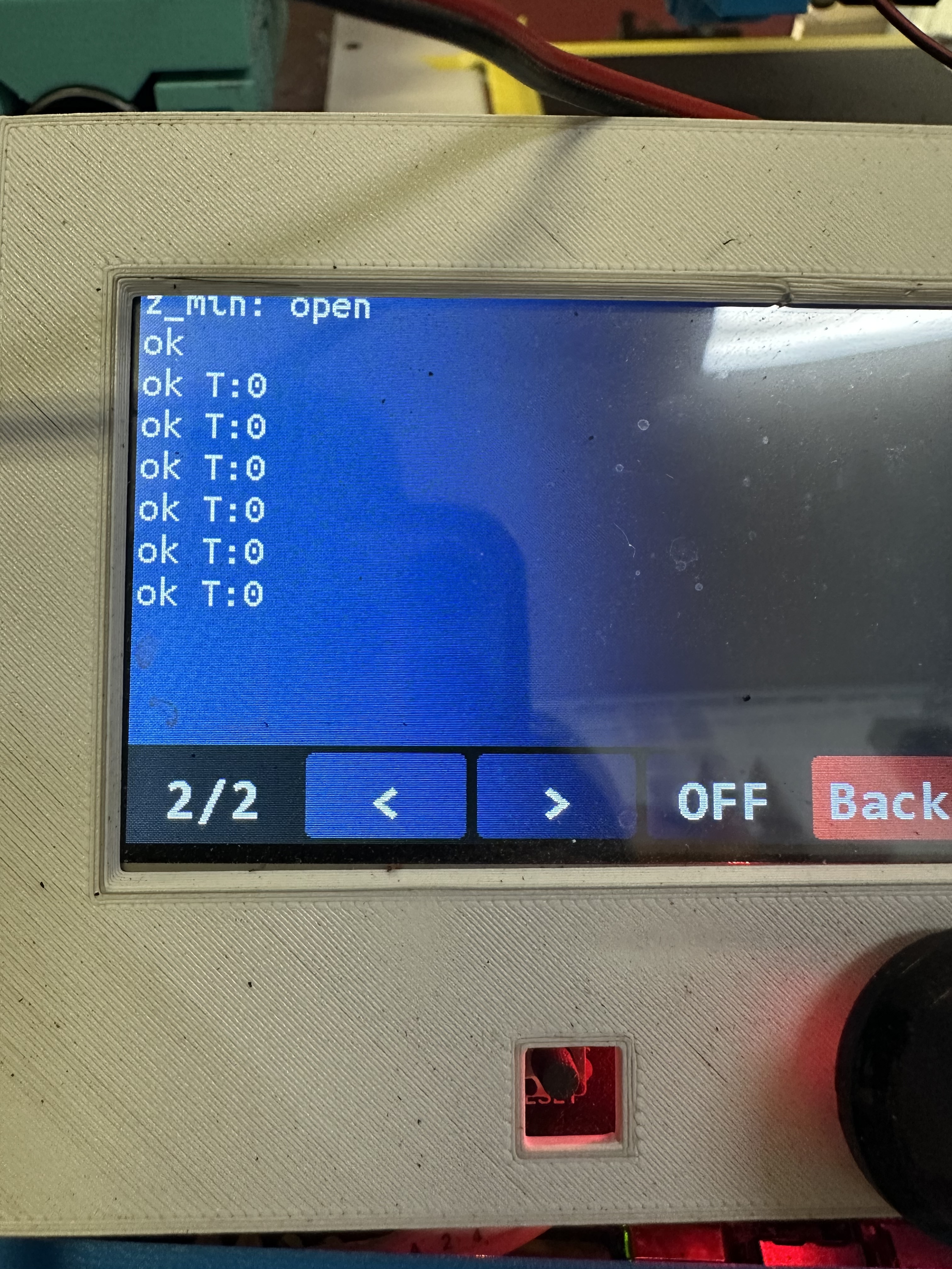

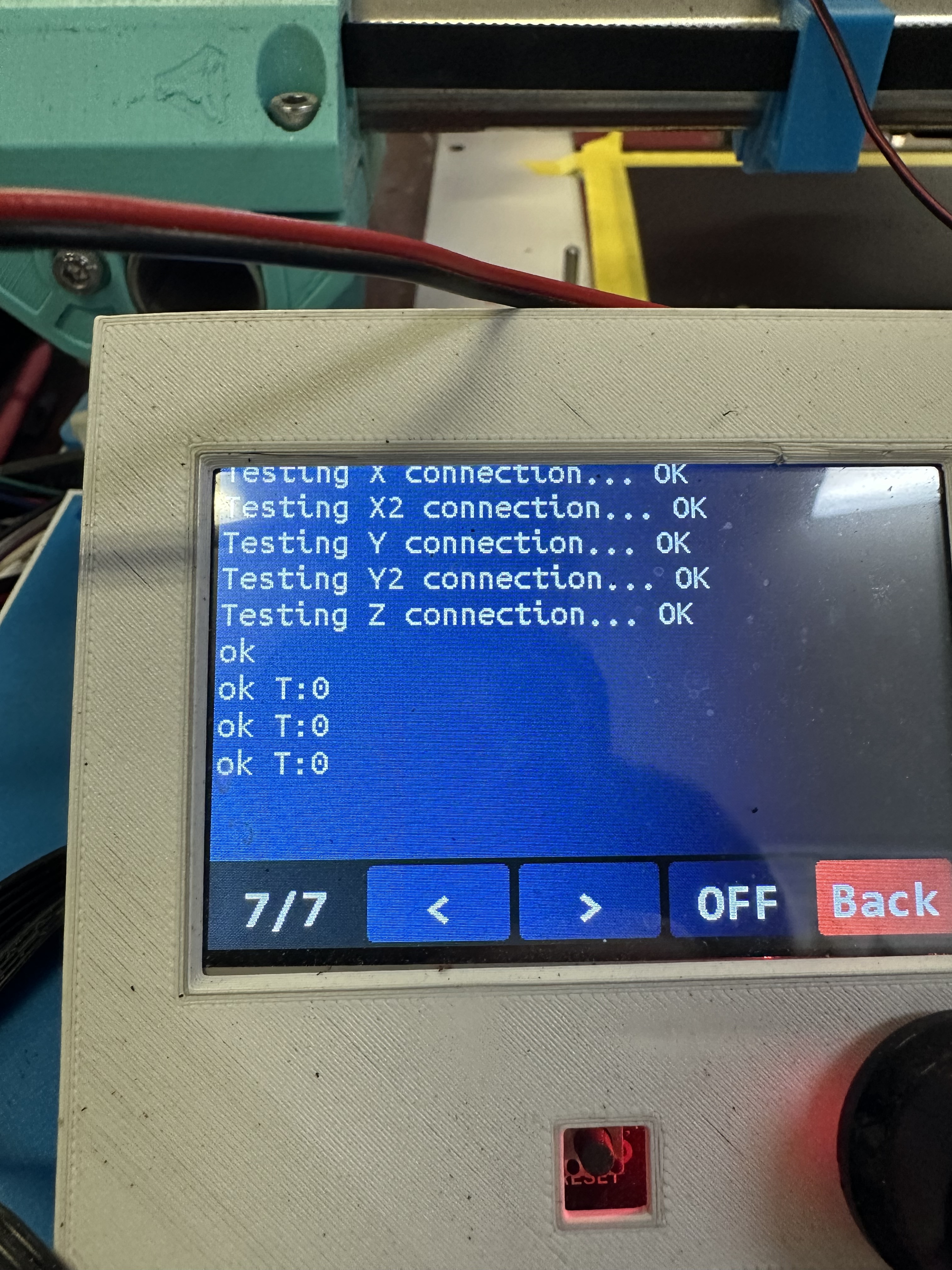

Whad to you see with
M119
M122
Do all of your endstops work correctly when you walk through them with M119?
Does M122 show any errors?
M119
M122
That’s what I got
You’re only showing a couple of the output pages, and are missing the section where the endstop status is displayed (except for Z_Min on page 2)

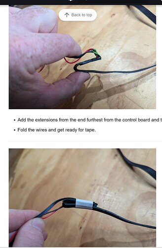

During homing (G28) when a stepper doesn’t move intermittently, 99% of the time it is because the endstop switch is already in the triggered position (switches are wired NC). This is usually due to an open in the wire at a connection point, often at the connection between the motor wire and the extension cable. Using an s-bend for strain relief can prevent this issue.
