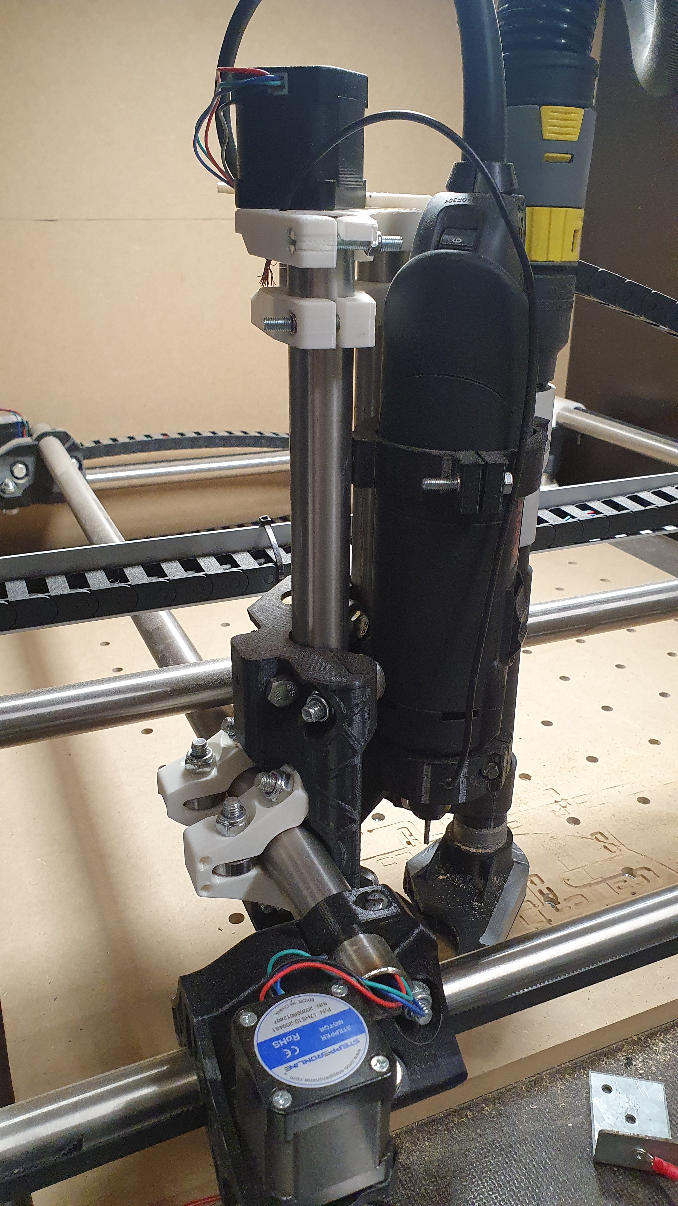

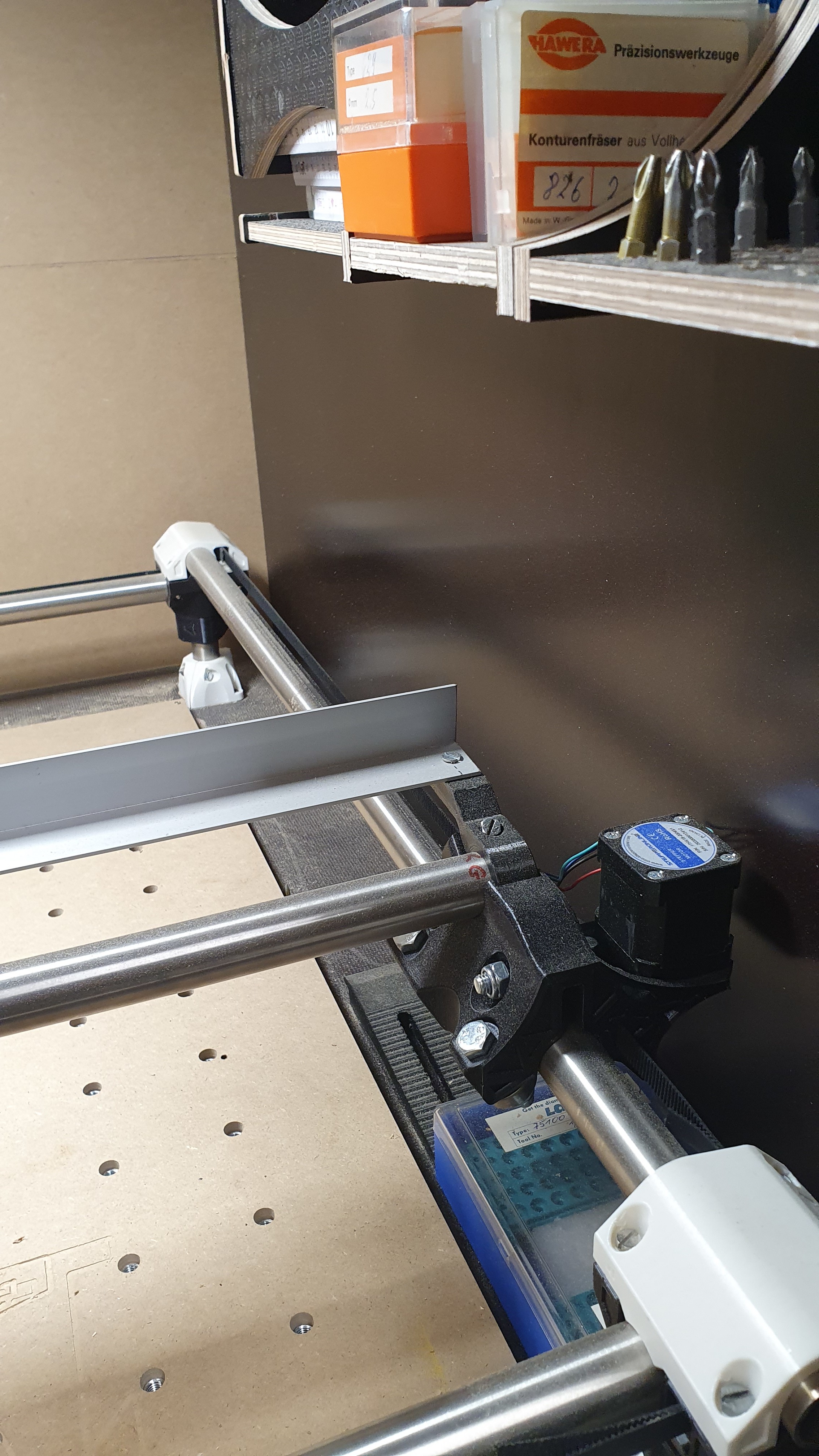

I assembled my MPCNC just over 2 months ago and i am really happy with it, with smaller projects i got no problem with squareness of the machine or skipped steps, but when i mill bigger projects the X axis skips steps and i have to stop milling.
i attached a few pictures to give you a better understanding of my built, let me know if you need more information and i will add pictures or a better description of the problem.

Sorry if I seem to ask silly questions but my habit is to look at the simple things first. Is the X position where it starts to skip consistent? Does it vary depending on Y value? I’d just try to eliminate the possibility of any mechanical interference which at times can be difficult to spot.
Be careful with the attachment to the top of the z it is a big lever on the x there. Actually the cable chain can be a problem if it catches also

Off-topic, which mount do you use?? I need this for my Kress router when upgrade to Primo.

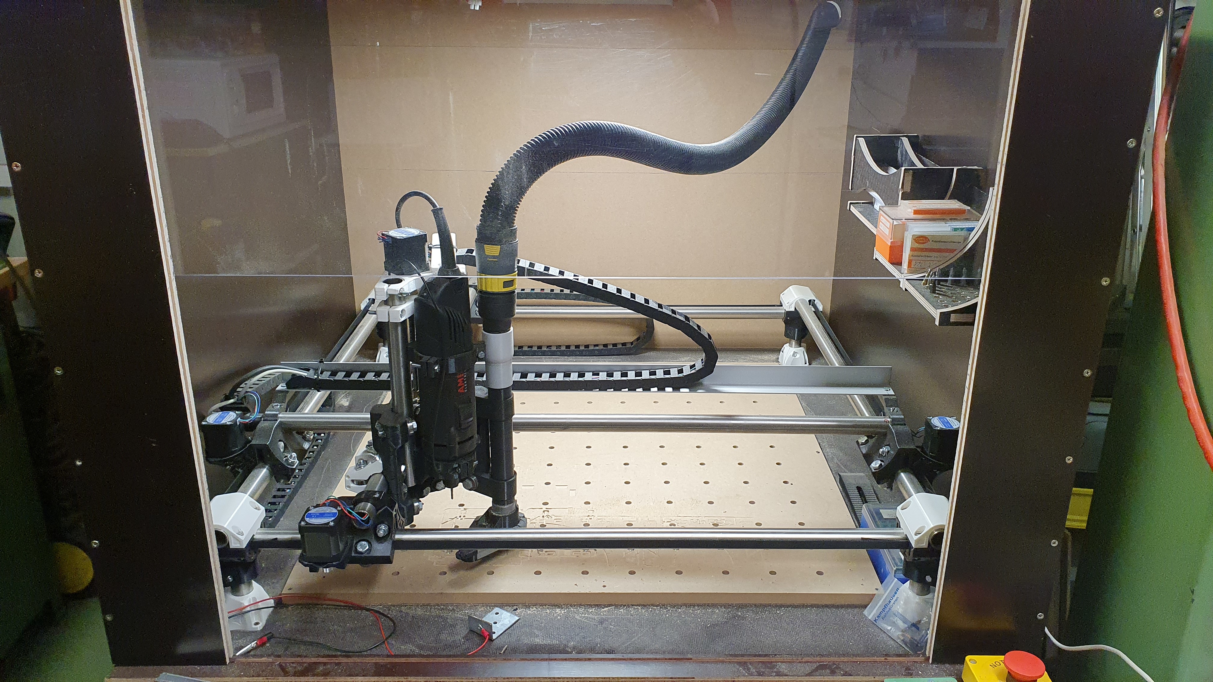

I feel like the error happens more towards the middle of the mpcnc, when i mill smaller things near the opening of my enclosure nothing happens. Thanks for the tipp with the attachment of the Z axis, i will do a testrun without the vacuum and see if anything changes.

@keeze thats the one i use, you have to drill new holes for the 25mm Z pipes. https://www.prusaprinters.org/prints/40842-mpcnc-primo-amb-1050-fme-43mm-tool-mount
Looks like in the middle your vac hose would be sitting a lot lower, maybe pulling more weight on the Z?

Not that it has anything to do with skipping step on the x… did you notice your z motor mount is cracked? Depending on the cut, that could slip and bugger up the z positioning. {edit: …of course if that happens then the bit could snag and x motor could skip}
