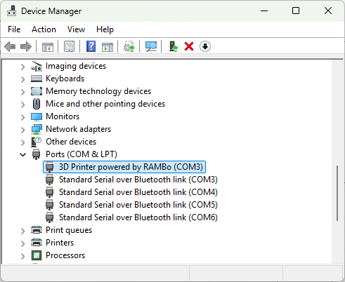

This is the port in device manager:

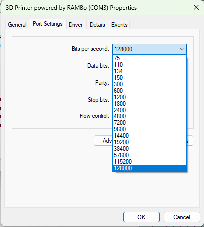

This is the settings for the port:
Note I don’t have a 250,000 option.
I’d been seeting the values to be the same in Repetier Host as the port settings and this was not working.

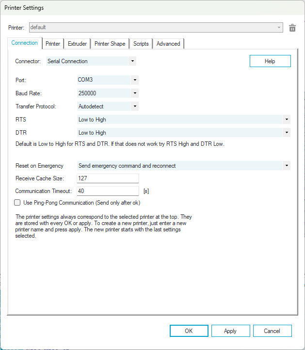

So in Repetier out of desperation I set it as below:
At which point the machine jumped, and now I have movement. I don’t think this is “correct” but its working. So I’ll run with it and see what happens.
I’m pretty sure that the Marlin configs have always used 250000 as the data rate.
Good to see the machine working for you again, hopefully back to full function for you.

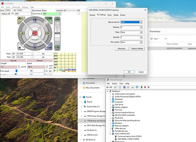

Windows doesn’t have 250000 as an option (I confirmed on my own W11 Home Edition), so you need to use the associated Serial communication program (Pronterface, Repetier, Putty, HyperTerminal, etc) to override the value in the Ports setting in Device Manager.
When you set the BAUD rate in a Windows program, it automatically sets the port setting to that value, but it DOES NOT necessarily change the value in Device Manager.
The following screen grab is from my Ender 3 3D printer, and shows Pronterface connected at 115200, but Device manager Port Properties still showing 9600.

Ryan’s configs have always been 250k. The default in Marlin is 115.2k. 128k has never been used afaik.
The setting in repetier host is all that matters. I bet this is completely fixed and I’m not sure how something changed. Let us know if it isn’t working.
