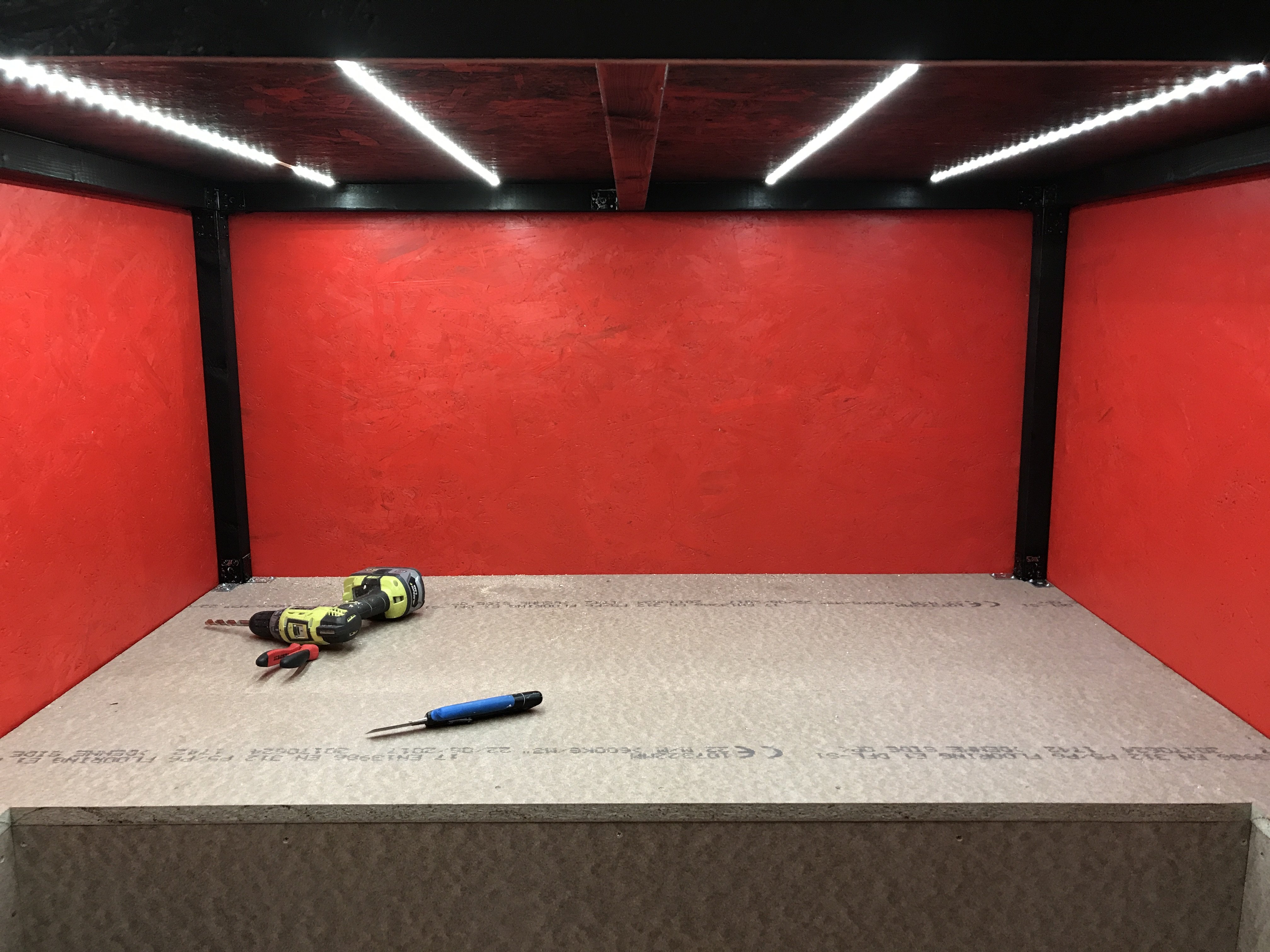

You doing a 4th axis in the deep part, or just so you can engrave on tall stuff?
lower part will be for extras like u say 4 axis, 3d printing if I want or just bigger material. On top of that it will be table with normal hight. then legs of the machine I can go almost all the way down.

Dude, that looks sweet!
Very professional looking. You’ll have to carve a sign for it.
Wow! All our mpcncs are going to be jealous that they don’t get to live in such fine conditions. If you’re 3d printing that will be a great enclosure. If you’re milling then prepare to get it dirty fast!
