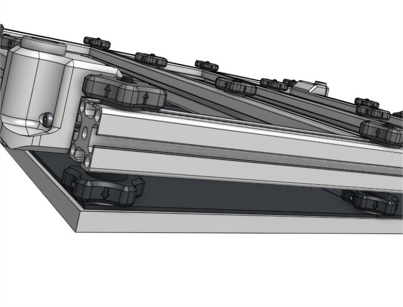

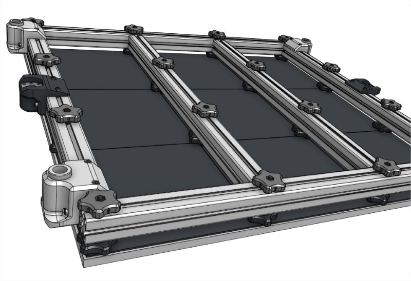

Ok I think I’ve got a design I could live with for my bed now. I just need to check the motors lift power in order to decide if I go with 10 or 15 mm for the aluminum plate, but other than this I’m pretty happy with this design.
So, the plate will be secured with 16 M8 screws, spaced at regular intervals. Then there will be two adjusting knobs: one for adjusting downwards, and an other one for adjusting upwards.
This way, I can adjust the general tilt of the plate, as well as correct some planeity defects.
Shoud look something like this:
I hope it won’t be too heavy for the motors, the whole bed might weight around 40 kilos, it’s definitely not light.
