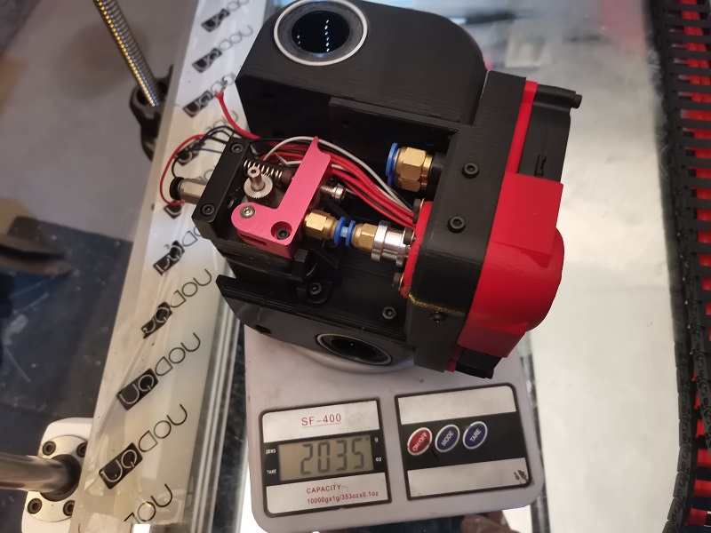

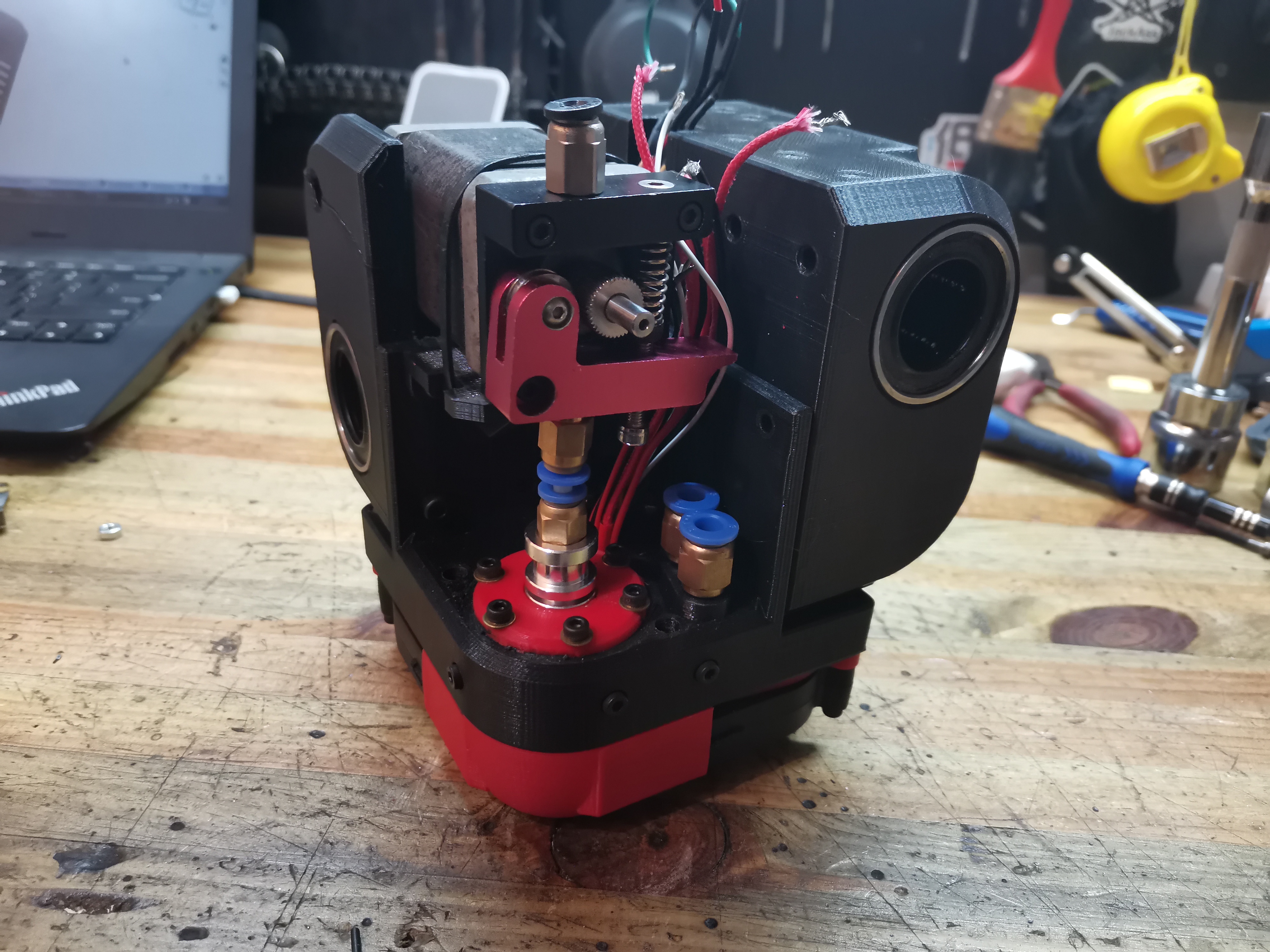

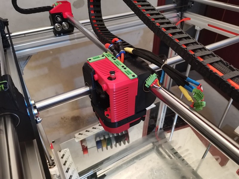

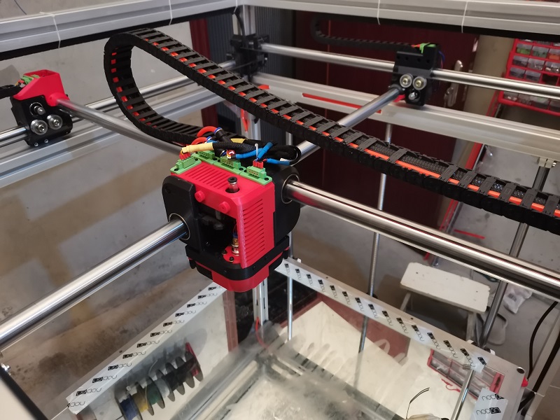

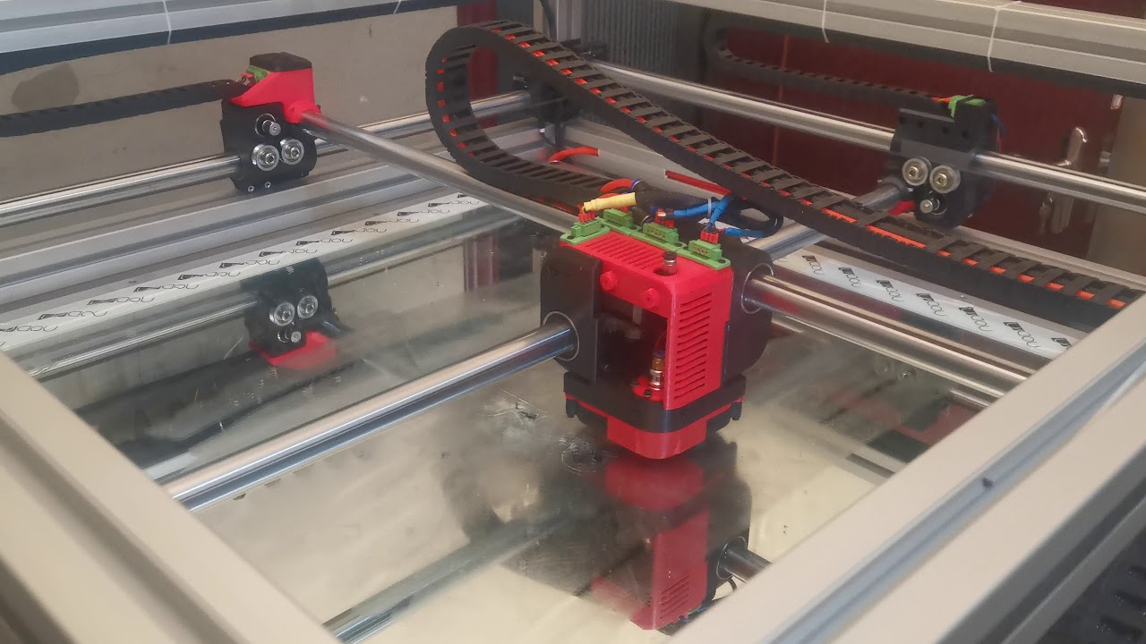

Anyway, I’ve made some really nice progress. I really didn’t want to, but I had to modify my carriage part. First, I didn’t like to have this giant extruder motor on top of the whole thing, it looked weird and moreover it wasn’t helping at all as to how to integrate the new plugs for all the wiring harness.
So… I found a way to have it fit inside the whole thing, by making some room in the carriage.
Wasn’t easy to design, but it worked so I’m extremely proud of that. Now everthing fits in this tight space and the print head can actually just slide into place and be secured with three screws. That means that I can drop a different print head in less than one or two minutes: just unplug everything, remove 3 screws and install another head. Can’t be happier, also it looks neat and clean.
Bad news is that I cracked the newly printed carriage while press fitting the linear bearings, so I’ll have to print a new one with slightly larger tolerances for the press fit… It’s already being printed right now so hopefully I’ll have it by tomorrow.
I managed to get it a lot lighter… But the whole assembly still weights more than 2 kilos! So that’s a lot of inertia, not mentionning that my 25mm metal rods are extremely heavy too…
Well, despite all this mass, the printer is just amazingly fast. It’s really crazy, the motors move the print head like it weights nothing!

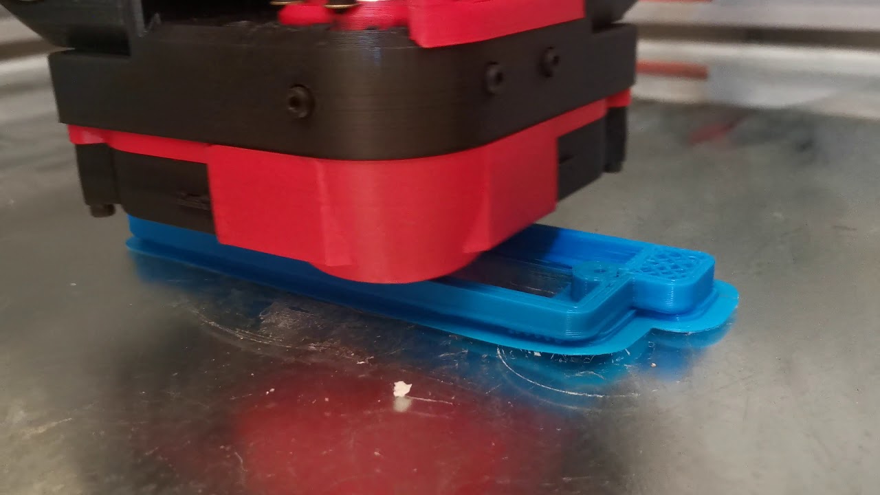

So here is how that looks like:
After that, I just tried to print a random part. But I’m missing a part for the extruder, I need a left oriented gearing for the motor because the one I have is right oriented and it doesn’t fit. So anyway, I just printed air, to see if everything worked fine, to check how reliable it is and also see the speeds…
Well, it’s crazy to see. Keep in mind that the print head weights 2kg!
On this video it is actually faster than my delta printers in both accelerations and speeds. Insane.
An interesting fact is that both X and Y axis are totally silent most of the time (except during super high speed travels). Most of the noise you can hear actually comes from the Z motor doing the active bed leveling during the print. I don’t really think it’s a problem, it’s just a fun fact that took me a few minutes to actually figure out.
Only issue I found so far is that the X and Y motors tend to get hot after a while, the roller’s plastic started to get soft after an hour. I’ll see if this turns out to be an issue during real prints, in which case I’ll think of some way to cool them down if necessary.
Everything looks very promizing now, it’s much better than I thought it would be.

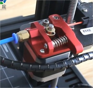

Was just referring to the feeder (sometimes aka extruder) itself and not the hotend. That looks like one of those bad clones we are often face failing.
I love the design of your whole print head! And I know it has to do lots of work on your big boy.
But maybe a geared feeder like the TriangleLab Titan extruder/feeder can apply much more force onto the filament strand.
Just my thoughts on that.

Yeah I tried to find a geared extruder but nothing really worked for me, either too big to fit, wrong orientation or some other problems. From what I see the one you’re referring me to seems a little bit too big and also it is oriented the wrong way (I’m not sure a mirrored version exists?)
Actually the one you saw on the pics hereabove isn’t the one I’ll use, if you look closely it is oriented the wrong way too right now, that’s actually the reason why I was not able to make a test print.
To be honest, I was using it for several years on the MPCNC and had not much to complain about, actually what I found matters most is the grab wheel quality itself, I’m alway using the finest ones which works best for me.
But I bought an different extruding system this time:
3DCR10MK8 1.75mm- - Google Chrome
I think it’s mostly the same, but this one should guide the filament a bit better after the push wheel, hopefully helping while loading filament and avoiding the rare occurences where filament scapes during a print.
It won’t fit out of the box, I’ll have to cut the handle shorter, but hopefully it’ll work fine too.
But yeah, if someone can refer me to a geared extruding system that can fit in a similarly small package while having the correct orientation I’ll consider using it for sure. I even considered a planetary gear reduction, but couldn’t find any system that would attach to it because the screw patterns are different.

Some good news and also some bad news.
The good news is that I received my new extruding system and after a few mods (cutting here and there, drilling and tapping new holes, etc) it does fit in the print head and seems to work really well.
I don’t think the extruding system will be the bottleneck on this machine, it was able to push a lot of plastic quickly after I increased a bit the current.
I’ll see how it will hold up after a few hours of prints.
One thing I really like about it is that it is well designed so that the filament cannot escape anywhere. That makes changing filament a breathe. I used to fight all the time with the old extruder, the filament needed to be very straight otherwise it wouldn’t go through the hole… it was a pain.
The other good news is that once I found the correct settings the printer worked really well. I had issues with the first layers because I tried to go too fast, but after that the layers were really good.
It is actually really fast, I think on this video it was on par, maybe even a bit faster than the ultimaker I’m using at work. But with a 0.8mm nozzle, so instead of taking 5 hours this print would have only taken maybe 1 and a half, two tops. Consistency between layers seemed perfect. It seems to me that the only thing I have to tweak are the beginning and end of each path, so that it extrudes and stops extruding at the right time. Hopefully linear advance should do the trick.
Here is how it looked like:
I did eperience layer shifting running at crazy speeds at the beginning of this print, during some very special infills when the printer was changing direction in a really fast zigzag patterns. So I guess I’ll lower the acceleration just a little or maybe try to play with the jerk settings, I’ll need to experiment.
Unfortunately, the bad news is that I had one motor disconnecting at some point. That’s really a bummer, the whole point of past weeks changes was to make the printer more reliable, but it failed miserably in doing that on its very first print. I hope it’s just a bad crimping on some connection and I won’t have to redo my whole wiring harness again, that would really suck.
Well… Very bad and weird news… Ihave to rebuild all my wiring harness.
For some reason I do not understand, all my motor wires seem to cut themselves one by one. I don’t know what’s going on at all, they work fine for a random amount of time, and then boom, the printer’s axis freezes, almost alway in the same spot.
Continuity test shows that a wire is cut, so it’s not the plugs nor my crimping. I’ve already replaced two wires so far and it just happened for a third time almost immediately.
Wire gauge is decent so I don’t really think that too much current would be the issue, but I don’t know.
Super disappointed, even the USB wires worked better. I can’t believe I’m having such a stupid problem after going through all this hassle, wtf is going on?
