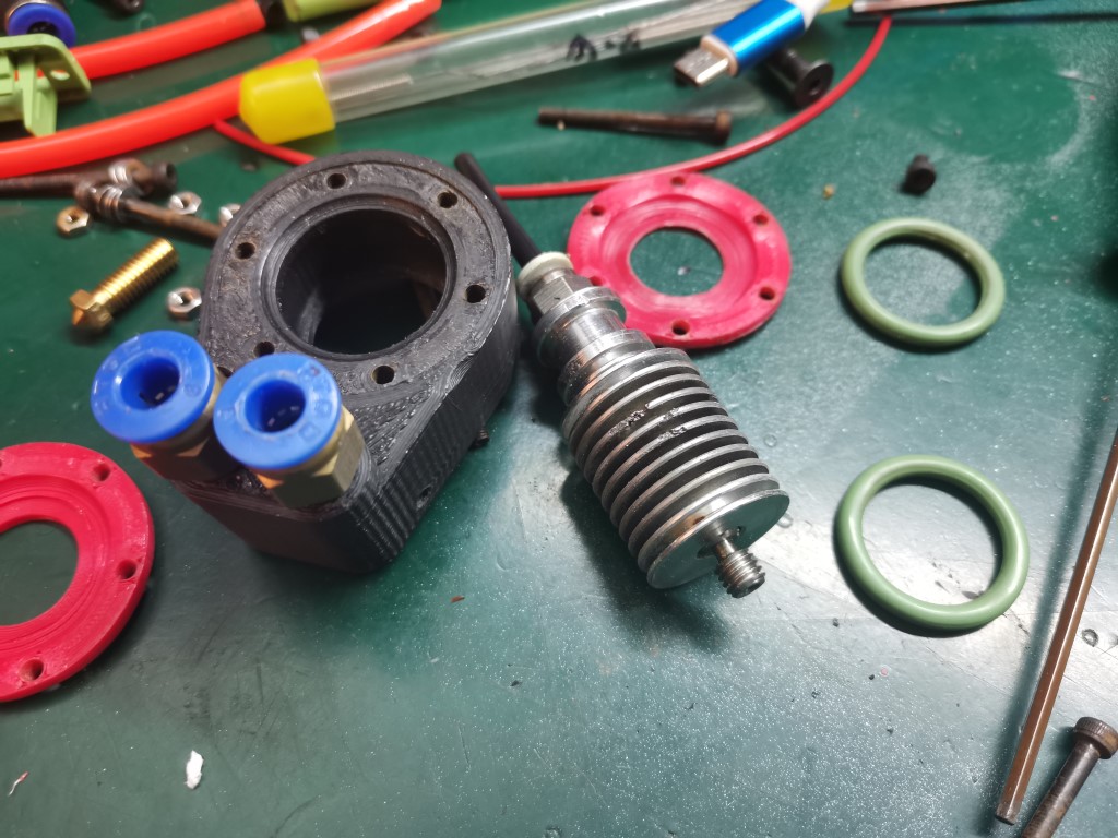

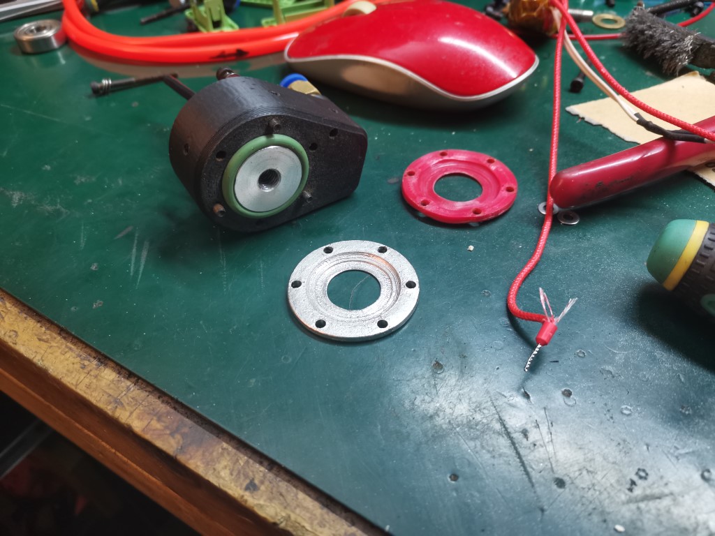

First I took apart the cooling block to check how it was inside:
As you can see, the red cover was severely bent and this is what caused the leak since it didn’t apply a uniform pressure on the seal anymore.
Also, interestingly, it seems like some fins corroded on the aluminum heatsink.
There was a little amount of white build up material inside, but nothing dramatic. I use regular water from the tap to cool the printer, nothing fancy, no anti bacterial stuff. Might be better to use some, but I’m a bit lazy.
Anyway, the cooling block was fine, the seals were fine. Seems like the only part who didn’t stand the prolongated heat exposure was that little red ring. Kinda exepcted because it sits very close to the heating block, i’ts already a small miracle that this part was able to survive for so many years and through so many prints.

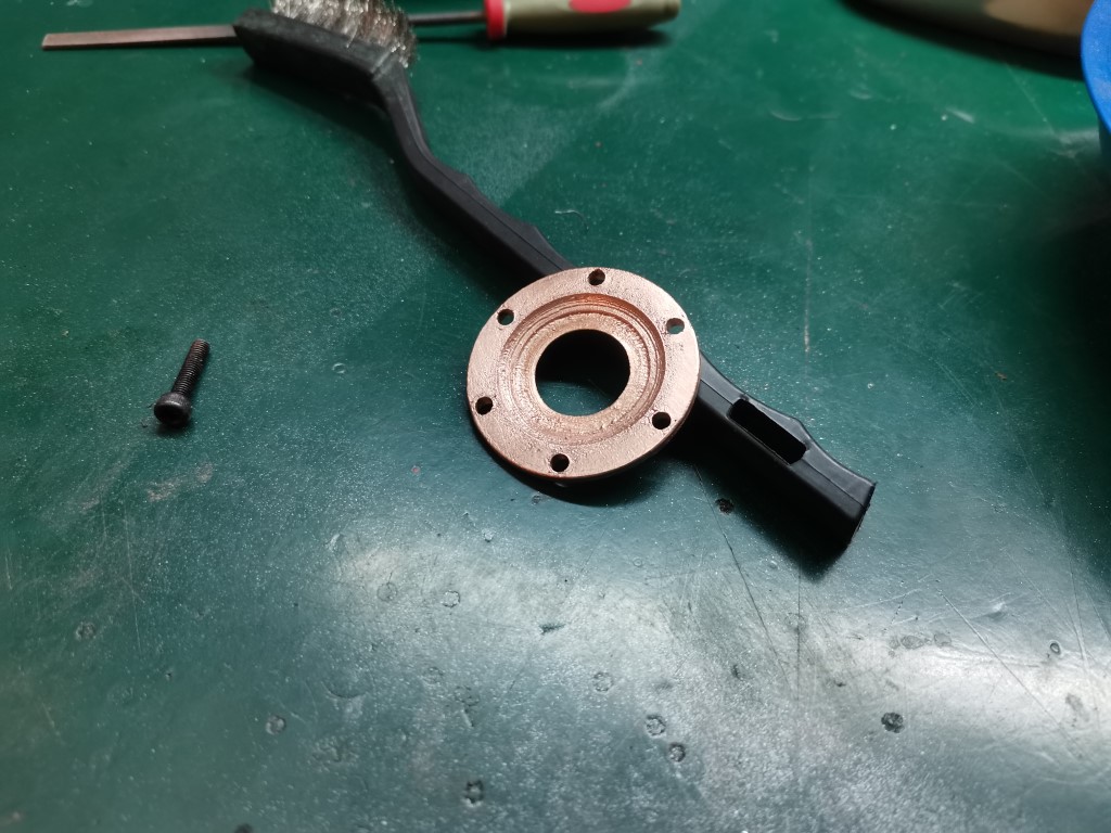

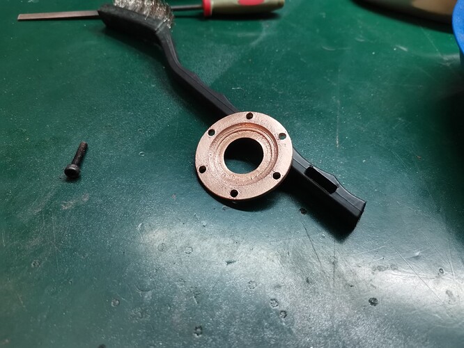

So first, I printed a slightly smaller version of this ring (to account for the metal deposition thickness, which was around 0.6mm). First plated it with a thick layer of copper:

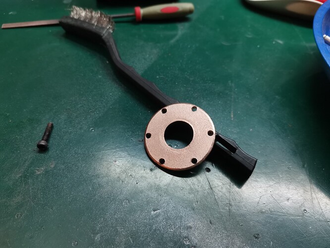

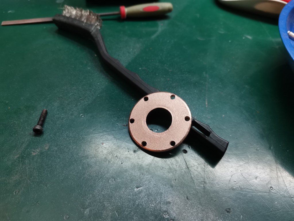

And then a small layer of nickel afterwards, which protects if from corrosion and also makes it a bit harder/tougher:

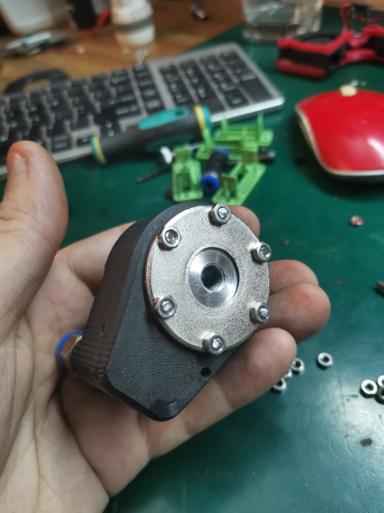

Then reinstalled this on the cooling block:

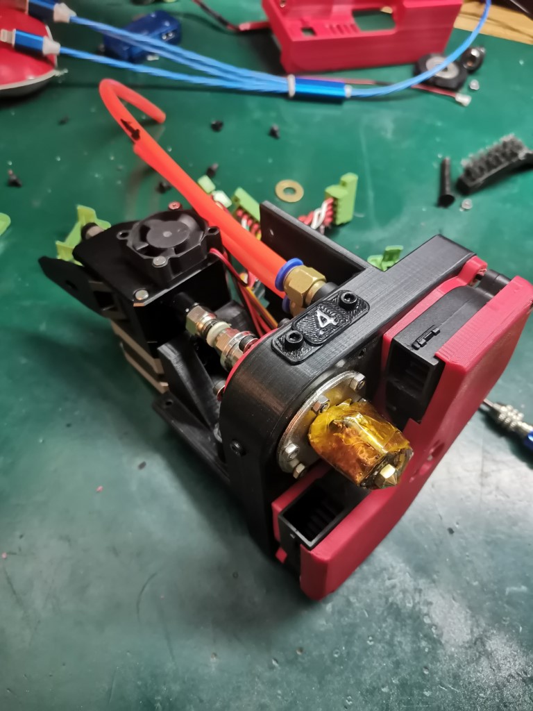

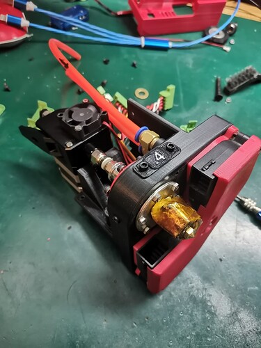

And finally the cooling block back into the print head:
Tested for leaks and so far so good. The part is a lot stiffer and stronger than its PLA counterpart. It’s also significantly heavier.
I think it will perform pretty well. Being made of copper it should also act like a small heatsink and help dissipate part of the heat. Meaning an ever colder cold side, pretty cool
Still need to be tested on a print, but I don’t see how this wouldn’t work.
I will also add a little thing to be able to visualize the water flow in order to be quickly aware in case something goes wrong with the pump. But if this happens when I’m not around at least the heat shouldn’t ruin the print head anymore.
