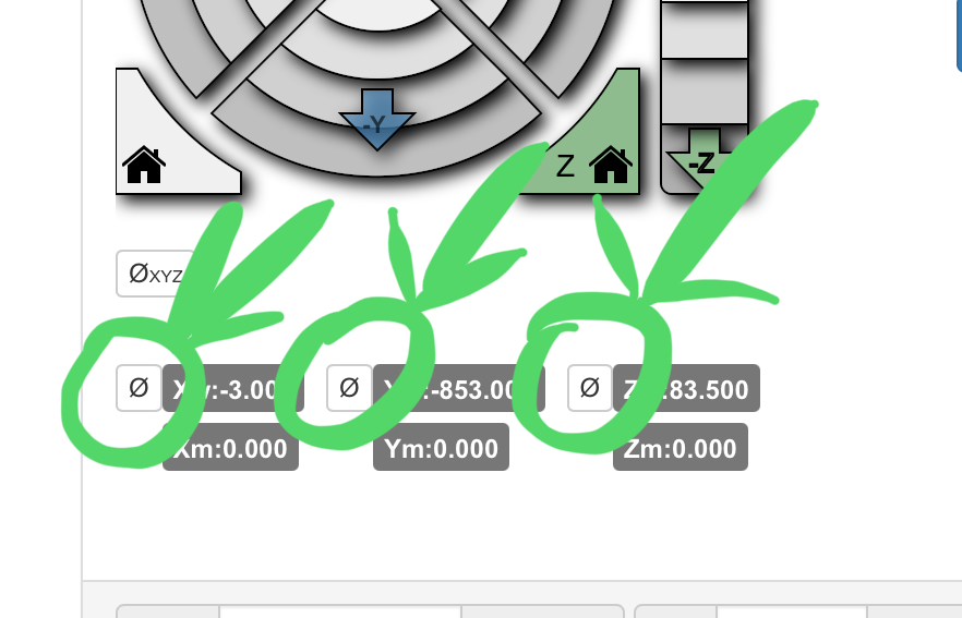

As far as zeroing the Z axis, I guess I was under the assumption that where I manually jogged it to the starting point was where it would start when I hit start, like manually jogging the z axis down to contact the top of the working area. Is there another way to zero it without a probe?

These buttons set the current position as zero for each respective axis
