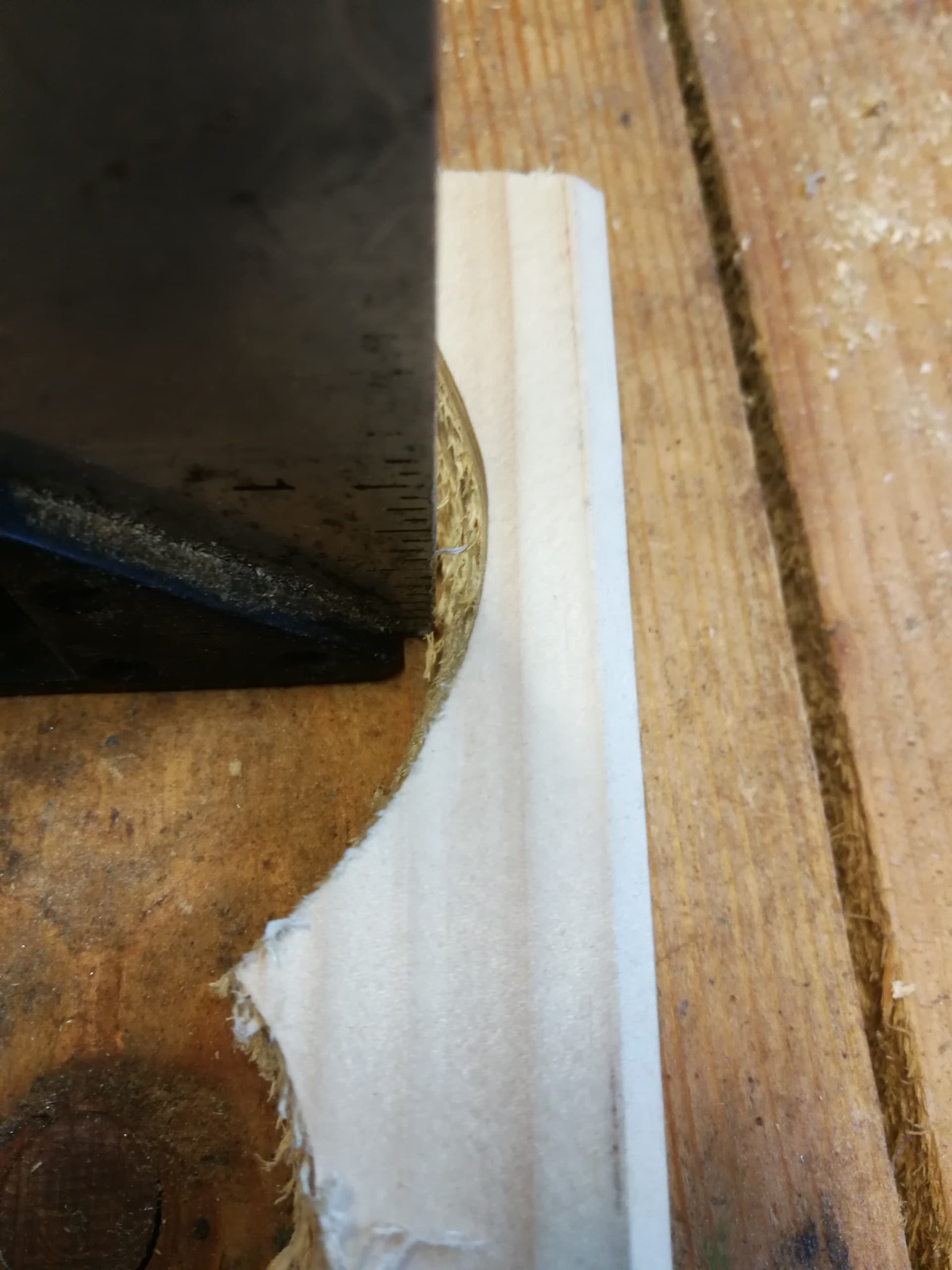

My second even more bigger problem is, that i can’t cut through wood without a shift in “layers”. I hope you get what i want to say - my router bit is 3 mm in diameter, but after cutting, the cut path is about 5-6 mm thick in some directions.

How are you measuring that? Is it in the same place? There are many reasons why a cut line from 0,0 to 300,300 would be deeper at the end than the beginning. But it should be exactly the same depth back at 0,0. Fluctuations in Z of even 3mm is pretty common. And it isn’t a big deal. You just have to compensate.
1.2mm DOC is not very much. What speed are you cutting at? Going deeper is better (at this range) than going faster, due to the nature of the stepper motors (among other things). Cutting in HD foam is a good way to check out the machine, without testing it with load. If you have a problem in foam, then it may be easier to diagnose than in wood.
Do you have “stairs” on one side of the cut?
Is your bit perpendicular to the XY plane? If your router is held at an angle, it would cause a triangle shaped cut (but it would have to be pretty dramatic to get to 6mm). Is the bit wobbling?
Skipped steps shift the whole pattern one way, and they never return to alignment. The machine has no idea where it is. It is counting steps. When some are skipped, it thinks it is in the right place, but it is off by a specific number of steps. If you manage to get good cutting after skipping steps, then it looks like a duplicate pattern, but offset from the original. If you skipped in one direction by 3mm, then it would cut on the inside on one end and the outside on the other. If your workpiece shifts (because it is not well clamped), that looks the same as skipped steps.
Flex is something that is stretching and returns to normal when the force is removed. We’ve seen some cracked parts or flimsy router mounts do that. The steel belt’s core breaks and the belt starts stretching (don’t use white belts). The workpiece can flex. Cutting in foam will remove all resistance, so any flex problems go away. Reducing the speed and depth of cut will reduce the flex problem.
Backlash is something where the machine is free to move for a short distance. If the grub screw wasn’t tight and it moved back and forth along the flat of the motor shaft, you would try to move 10mm to the right, but the first 1mm would just be the shaft slipping. The next 10mm would be perfect, until you moved back, then you would lose 1mm again. If the belts were very loose, they would pick up the slack before starting to move the machine. If there is space between the bearings and the tubing, you can have the machine click clack back and forth instead of staying rigid (that’s especially annoying because it is an angular error, so hard to figure out). Backlash will result in small errors, but they will be centered around the right thing. The bit will try to follow a track, but be off by a mm or two back and forth.
Alignment errors are things where the machine, or workpiece are not perfectly at right angles and are just systematically wrong. You said your machine isn’t square in XY. If you try to draw a square with a pen, it will end up as a parallelogram. If your Z axis isn’t perpendicular to the XY, then your bit will cut triangles. If your work piece is 12mm thick on one end and 16mm thick on the other, the machine can’t cut it evenly throughout. If your feet on one side are higher than the other, same thing. Alignment errors are measurable and you can tune the machine to make them better. You can also design your projects and cutting to minimize them. Things like cutting an extra few mm into the spoil board will solve the fact that the distance isn’t the same everywhere.
Post some pictures of the bad cuts Maybe we can help figure out which category to look at.

but i can upload the pictures. you can see on one spot, there is a straight line in depth, but on another spot i have a huge layer shift.
