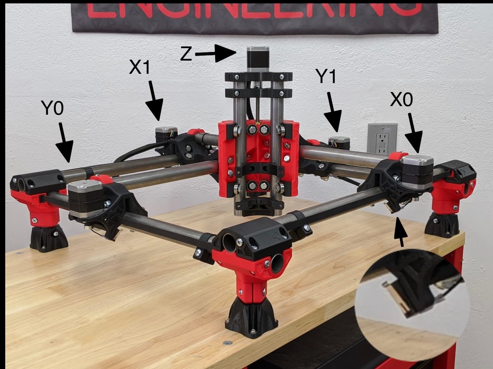

For the stepper motors, wiring is exactly as with jackpot v1 or V3.
So, for MPCNC the order as you go across the board is = X0, Y0, Z, X1(A), Y1(B).* In other words your X1 motor gets plugged into the driver output labeled A and so on.*

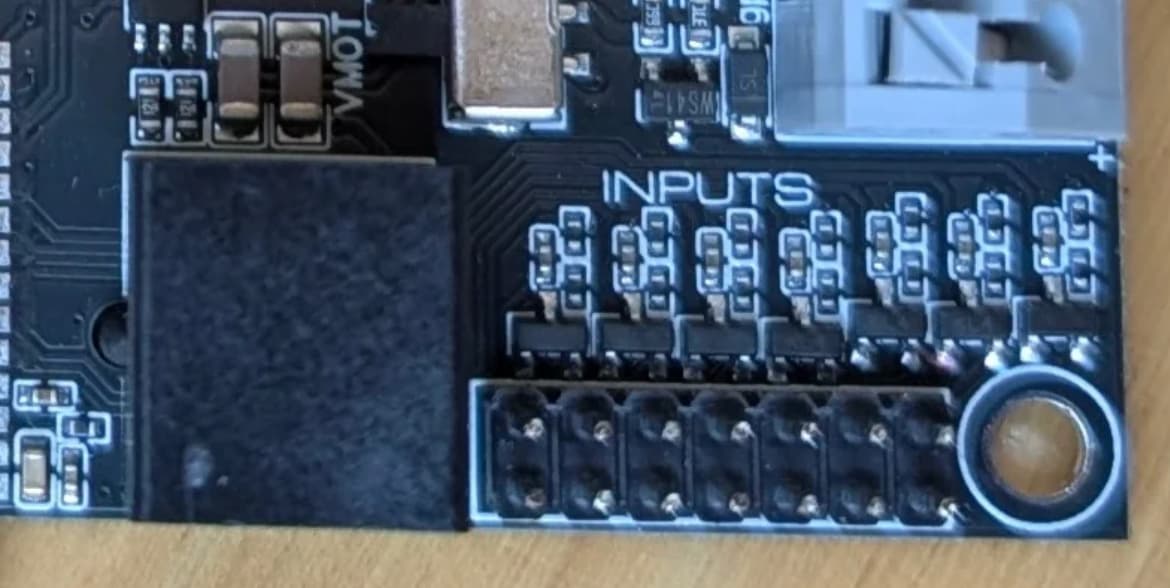

The endstops plug into the connectors in the bottom right corner of the jackpot V2, here:
There is auto-squaring on X and Y axis, so you hook up the endstops as defined in the config.yaml .

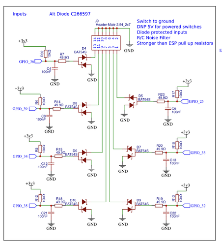

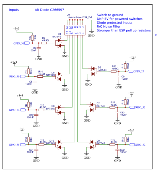

Edit 4: Here’s the detail from the schematic, to show the order of the GPIOs:
So, across the header it is:
GIPIOs 36,39,34,35,32,33,25.
Which is what this legend means on the board:
