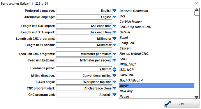

Hi after zeroing out my MPCNC and running the attached gcode (Ryans lowrider y plate) the machine starts cutting air above the work surface. The final cut into the workpiece is about 5.25mm of the expected 13mm cut.
I’ve tested the machine using manual controls and the z movement when used manually is correct.
I’m using ESTLCAM with Ryans recommended settings and a standard 1/8 bit also with the settings from the tutorial.
Any ideas?

My ESTLCAM settings are attached
Estlcam doesn’t matter if the gcode is right. The gcode shows this:
G01 Z-3.0000 F635
If that isn’t working, it isn’t estlcam or your gcodes fault. Did you try the test crown premade gcode?

I hang my head in shame… After pouring over settings and gcode for hours and learning much about my MPCNC I found the problem…
The machine was simply bottoming out. I recently switched to a thinner 1/4 spoil board to save weight which I thought was a brilliant idea; totally forgetting that I had designed the machine to bottom out at the surface of a 3/4 spoil board. I normally don’t do through cuts so this is the first time I’ve noticed.
The machine was bottoming out and losing steps then raising back up. My manual tests were done with a higher Z-0 because I didn’t want to unglue the workpiece thus they acted properly.
Anyway thank you all for your help. I really appreciate all of your efforts.
