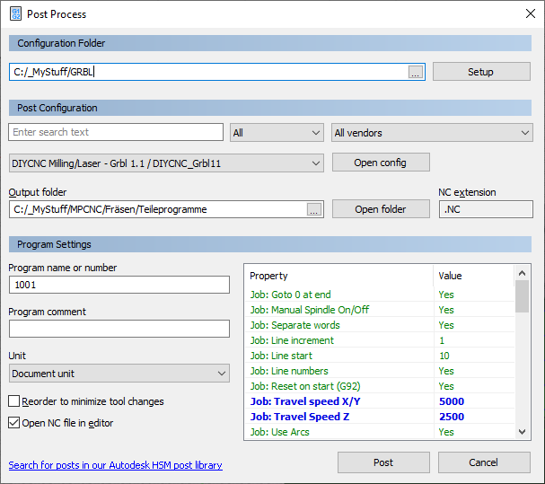

Well, first get the guffy post, here: GitHub - guffy1234/mpcnc_posts_processor: Marlin/MPCNC posts processor for Fusion 360
Download the zip archive and (at least I prefer it that way) put the files into a new dedicated folder.
Copy the Path of that folder from your Explorer address bar.
Open the post dialog:
grafik
Then set(or better navigate to) config folder to your new post processor folder(C:_MyStuff\GRBL in my case):
I’m using GRBL, but I guess you’ll get the gist.
Unless you want to use the posts provided by Autodesk, which probaby is not a good idea, as long as you’re new to this all, if ever.
Hope, this helps. If you need more help, let us know ^^

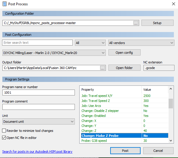

So i did add that to fusion as my post processor and sent the file over to my laptop and ran it in repetier but the Rambo board isnt recognizing it. I am trying a few more things to make sure have everything set up at each step properly, but repetier is still acting like i have a 3d printer setup

i just finished and got the code from fusion. but i cannot upload code since i am too new i guess but i will paste the first 50 lines:

EDIT: Argh, are you using a Z-probe at all?
If not, switch it off in the post options:
But I fear that you’re missing some basic step, I’m not guessing correcty, or something with your repetier host might be wonky…
