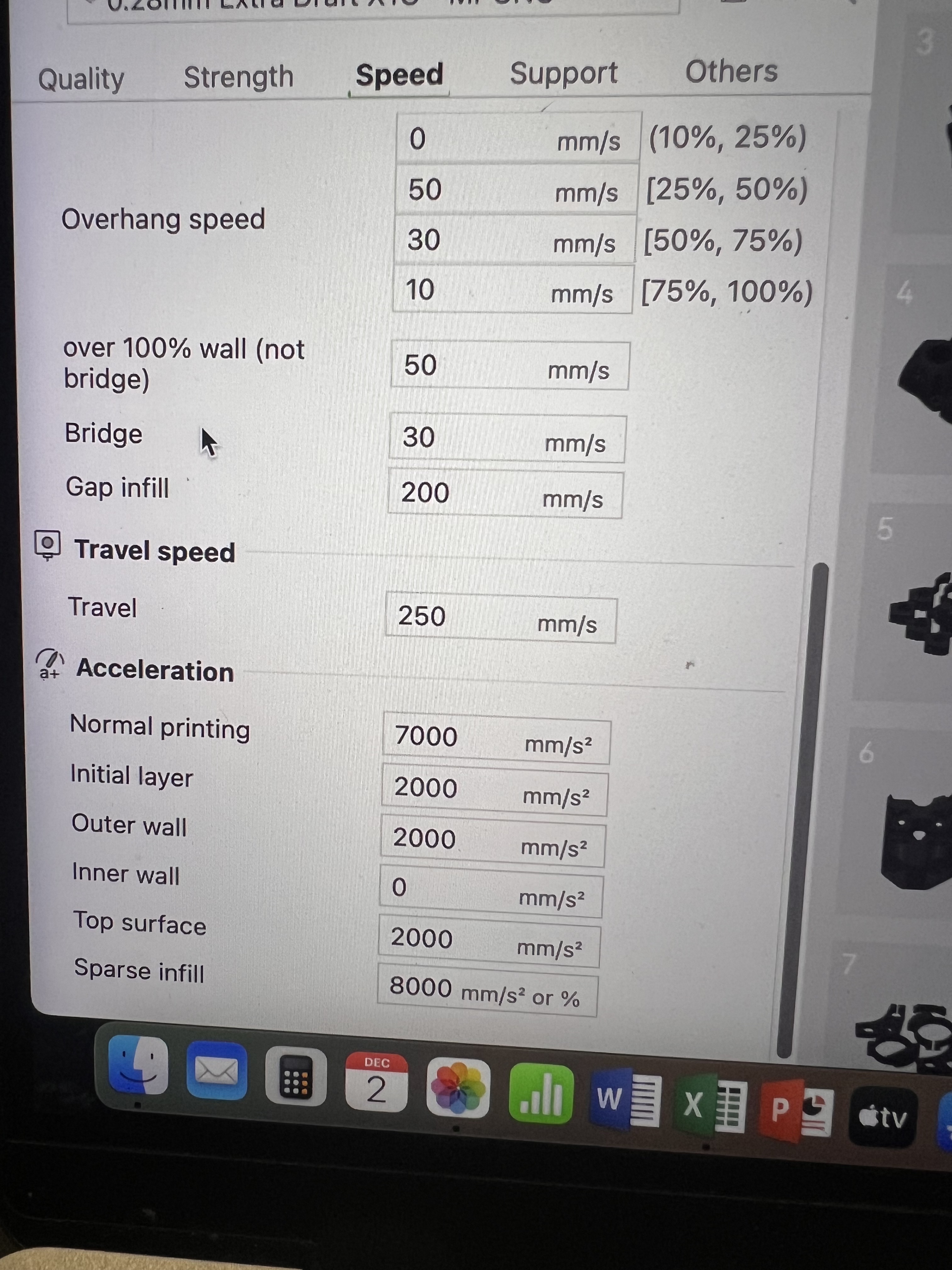

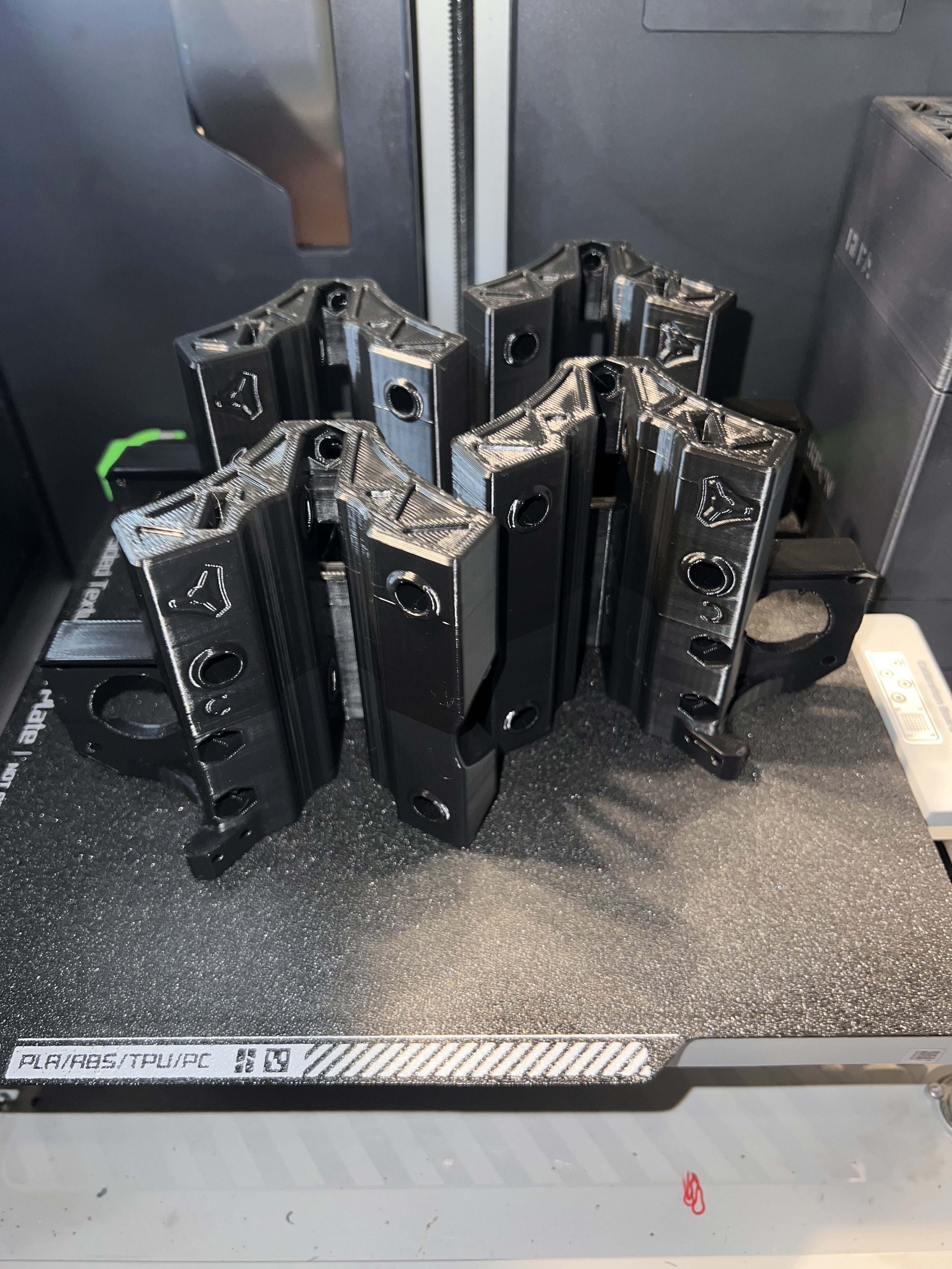

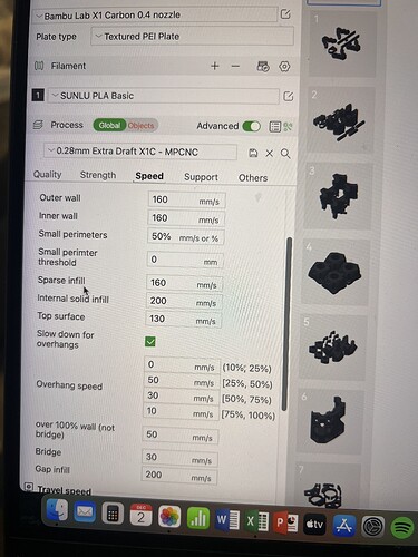

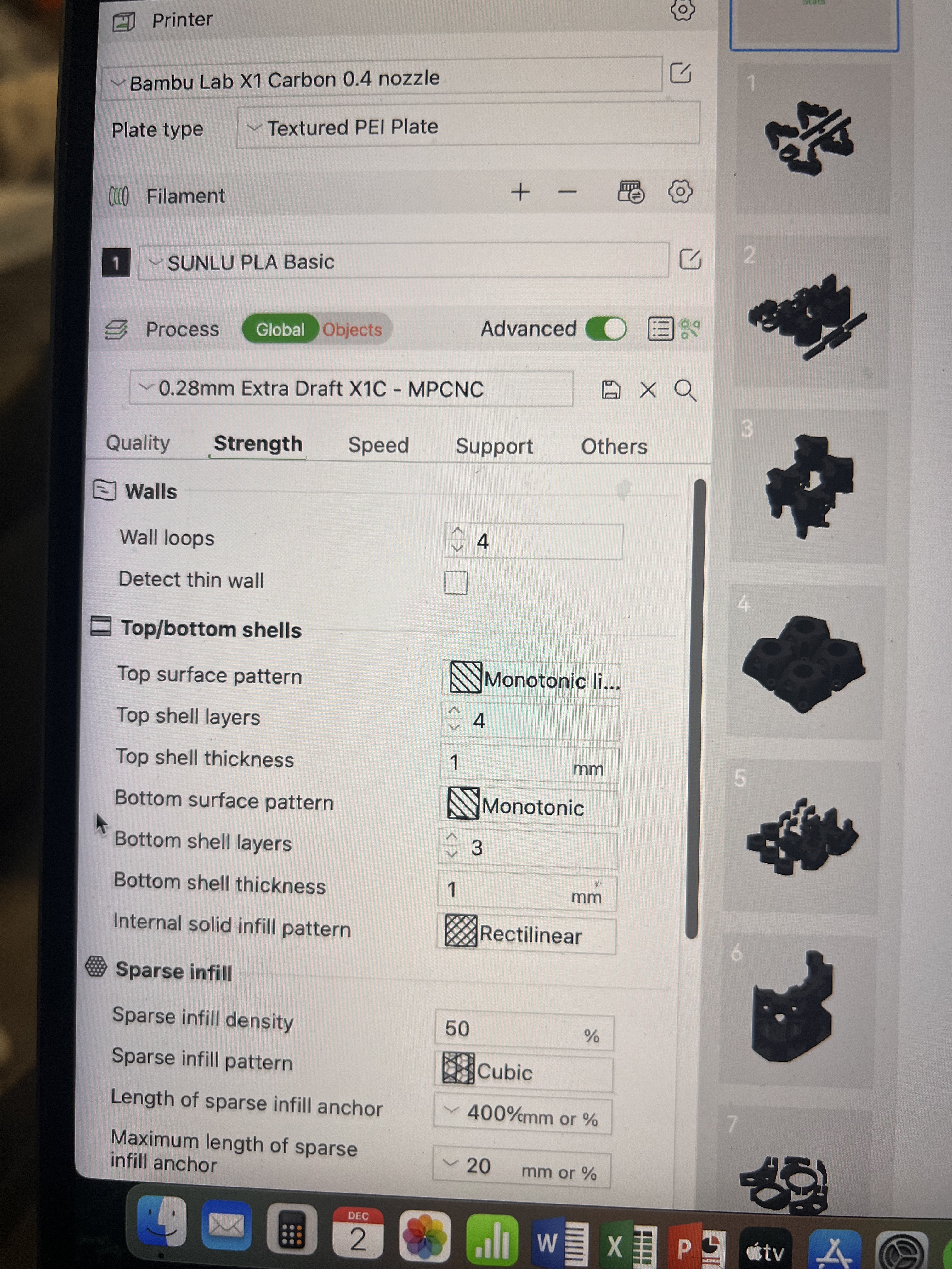

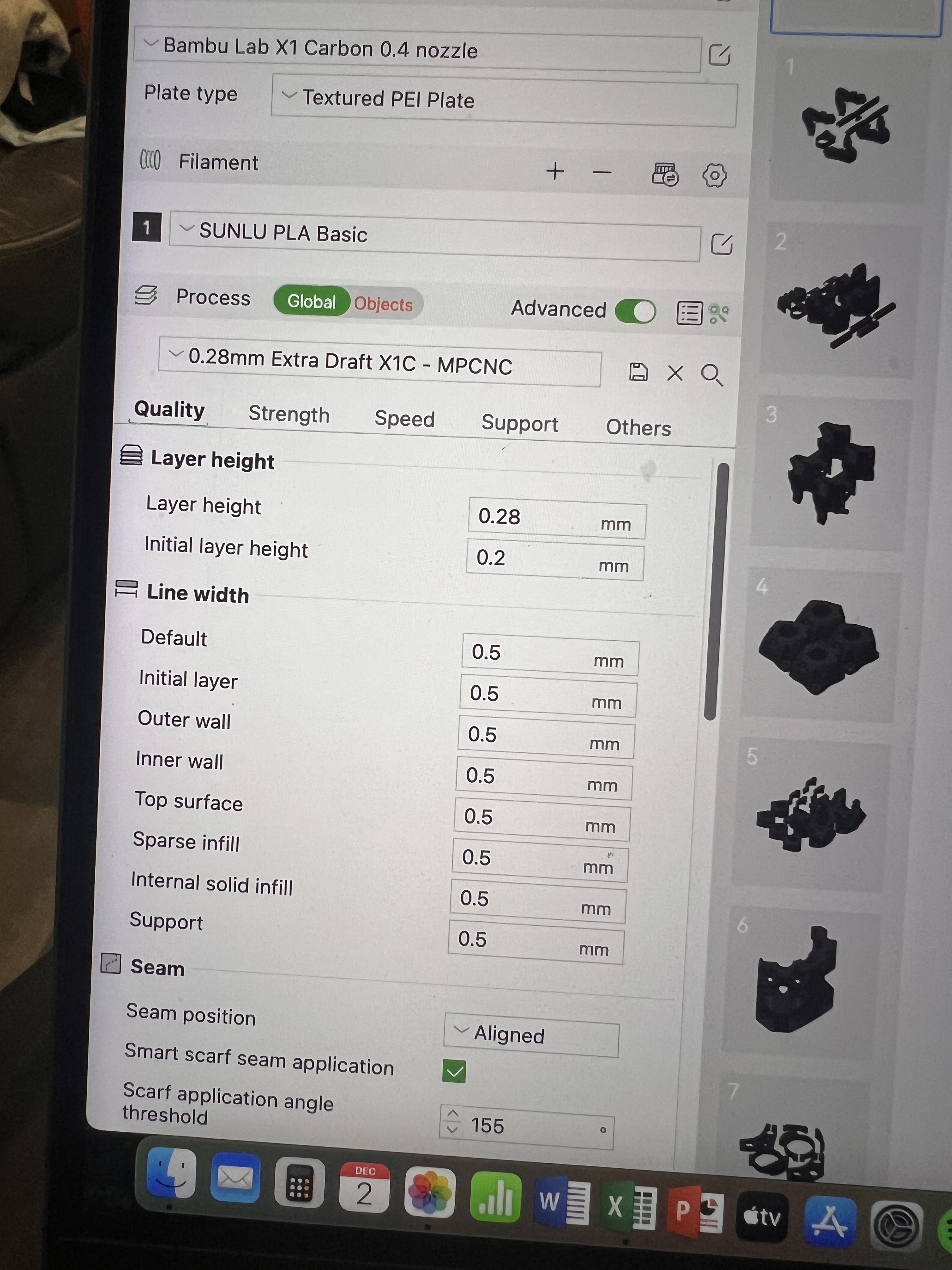

Today I started printing parts for my MPCNC Primo using my Bambu Labs X1C with 0.4mm hardened nozzle and Sunlu PLA in blue and black to match the Kobalt router. Here’s the settings I am using. I know it’s not fast, but it’ll bond the layers better. Because of the hardened nozzle I’m printing at 230c with a max flow rate of 16mm^3. My part fan is at 50% except for steep overhangs at 100%. I set cubic infill to 50% except the core, and 4 walls.

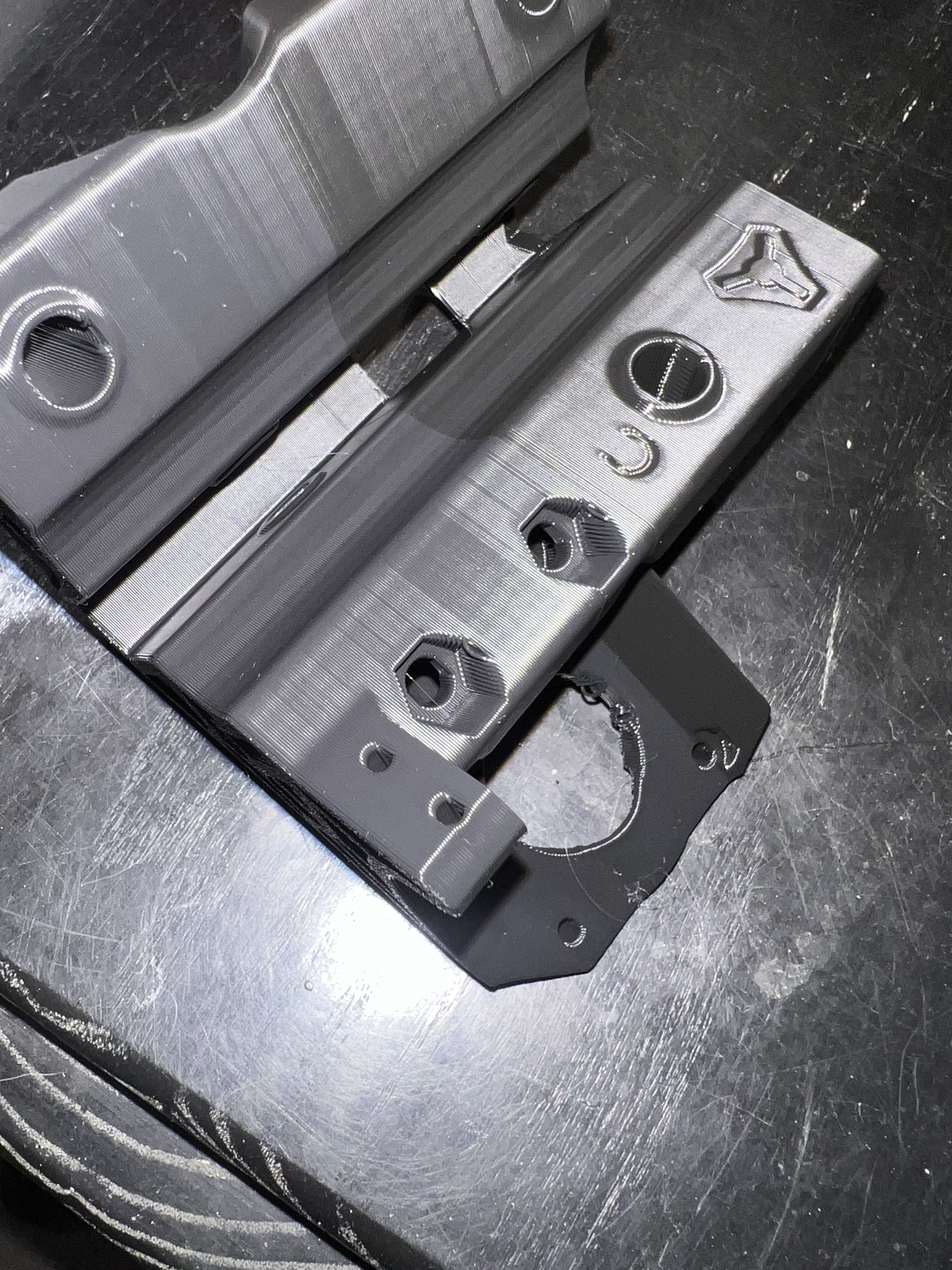

Yesterday and today I’ve been chugging along with printing the parts (Color A=Black) in PLA. The small clamps didn’t adhere to the bed well enough (due to the thin profile contacting the bed), so I added a 5mm brim with no gap. Issue resolved! I’ll start on the Color B = Blue parts tomorrow, saving the final plate for THE CORE! I’m pretty confident I have everything dialed in for the next few plates.
These parts are well designed for 3DP, my only recommendation is to change the “bore” of the stepper mounts on the trucks to a diamond or hexagon shape to improve (even more) ease of printing.

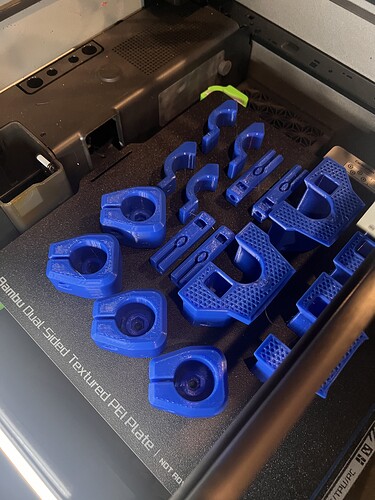

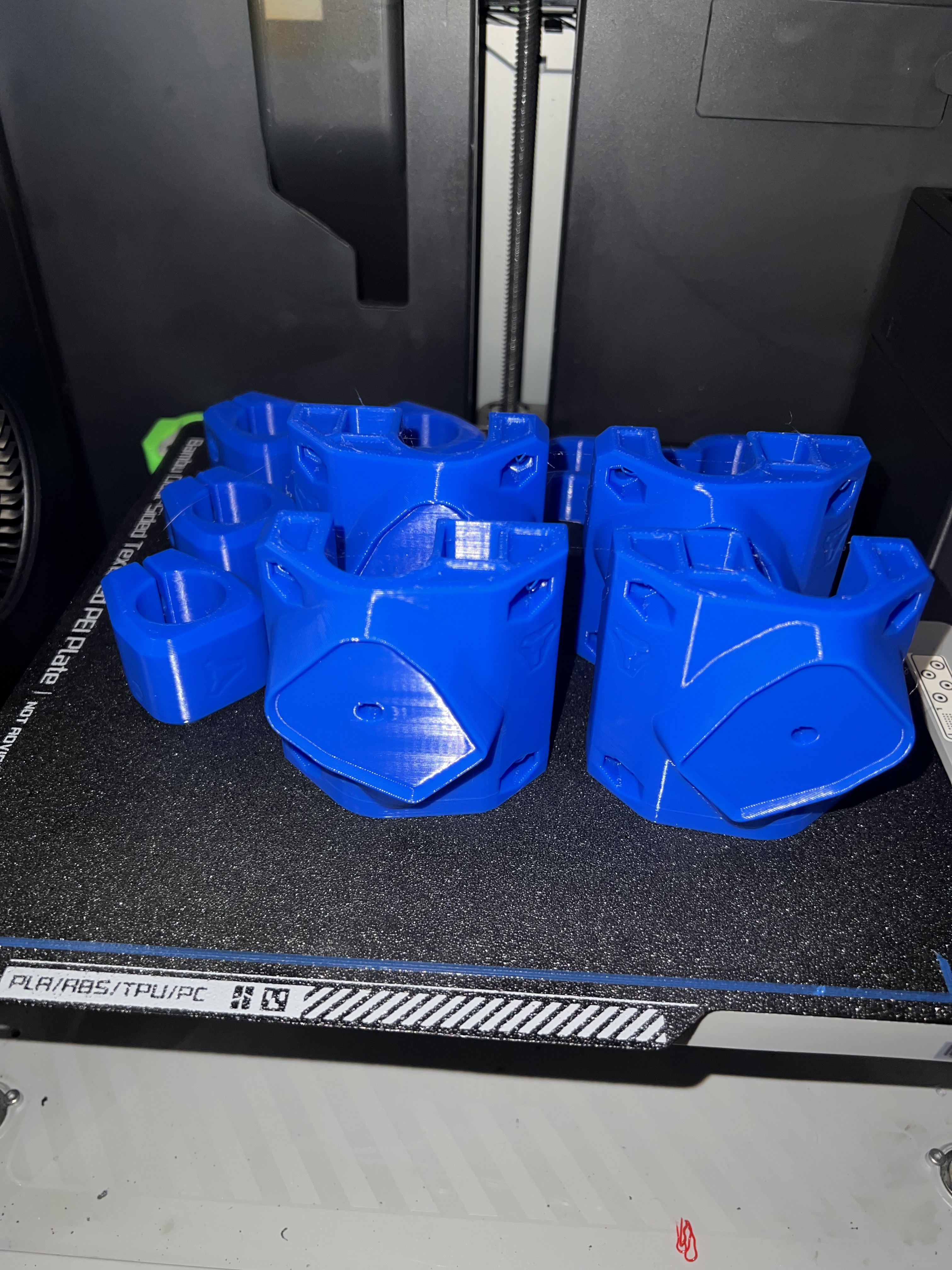

Today was rainy, so I printed a plate of blue stuff. I thought I had tuned my flow with this filament, but still ended up with minor over extrusion. If it affects fitment during assembly, I’ll reprint this plate.

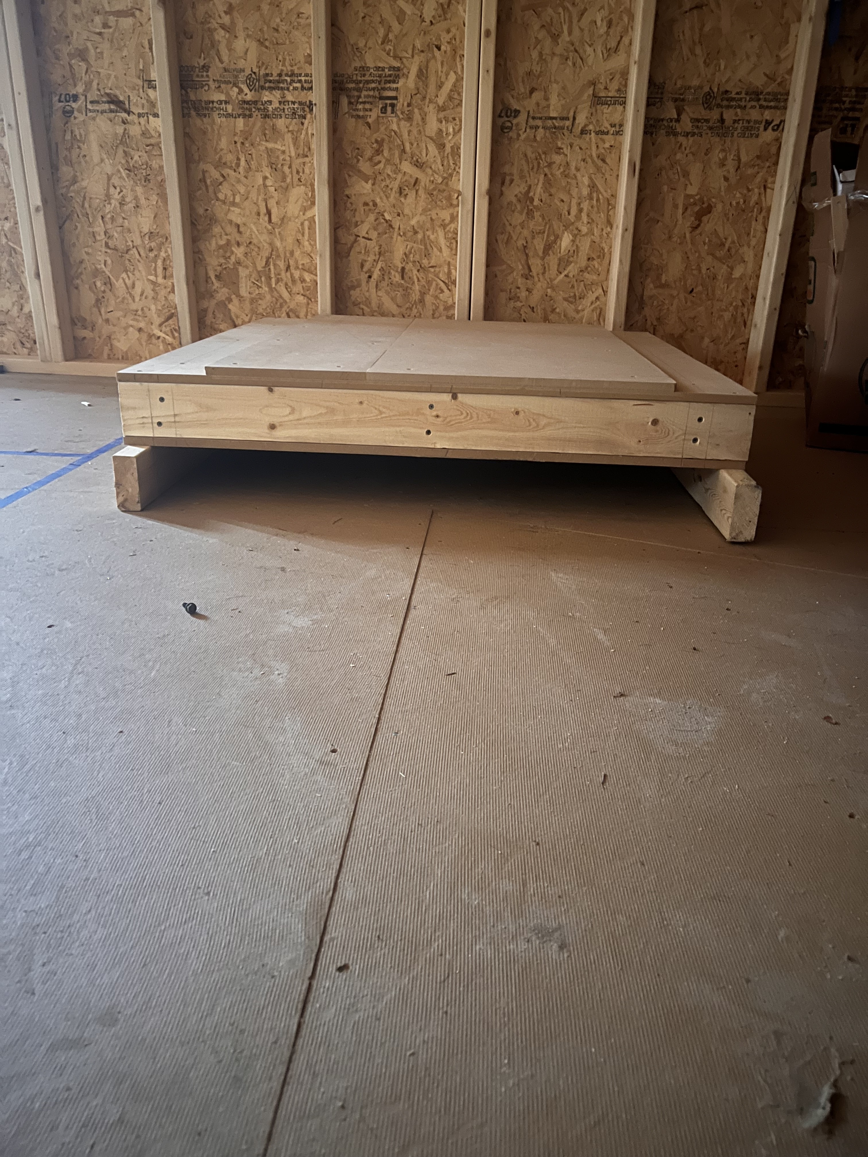

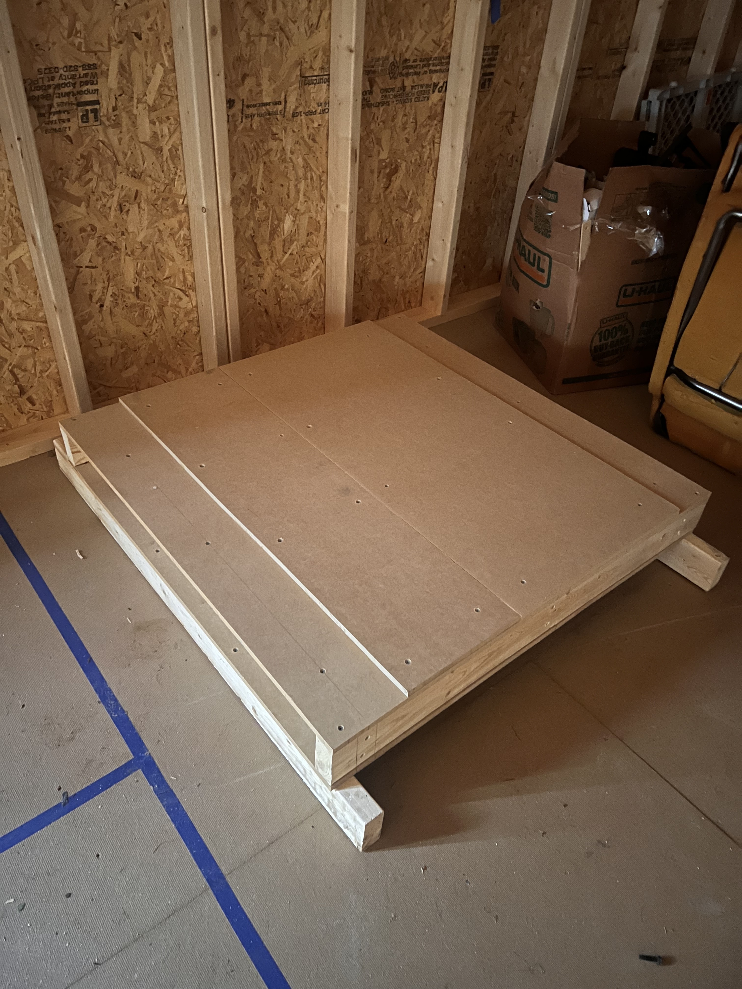

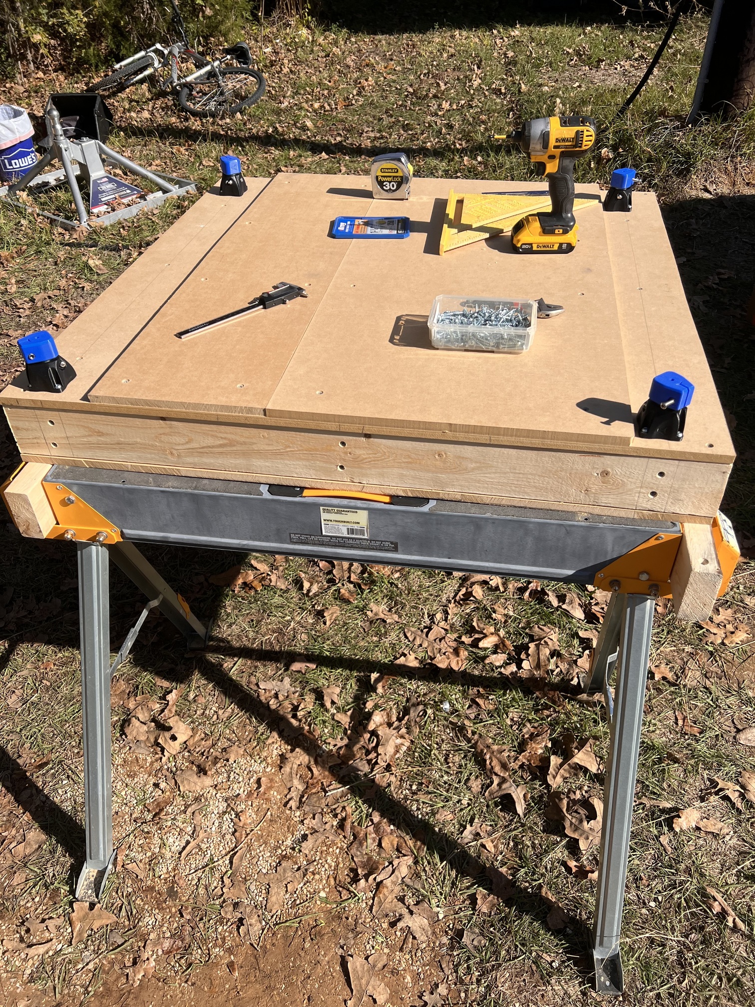

Yesterday I built a table using 2x4s and 1/2” MDF. I used the scraps of the MDF as a spoil board. I’ll post pics when I get it set back up. The forecast called for rain last night, so I concentrated on the build more than the documentation side.
After considering the advice from a previous comment, I reverted to a 24”x24” build area which comes out to about 36”x36” footprint. So I built my table around 39”x39”. I built the table so it can use two foldable metal sawhorses as the legs with the tabletops’ 2x4s resting in the slots of the sawhorses. This will allow me to store the MPCNC attached to the tabletop and the “legs”(sawhorses) separately. All I should need to do for setup is level the sawhorses in line with eachother and set the tabletop on them. At least that’s my intention…
More rain today, so I’m planning on assembling the few things I can. Yesterday I spent a few hours looking through the settings/language of Fluidnc and got a few pics of the table I built.

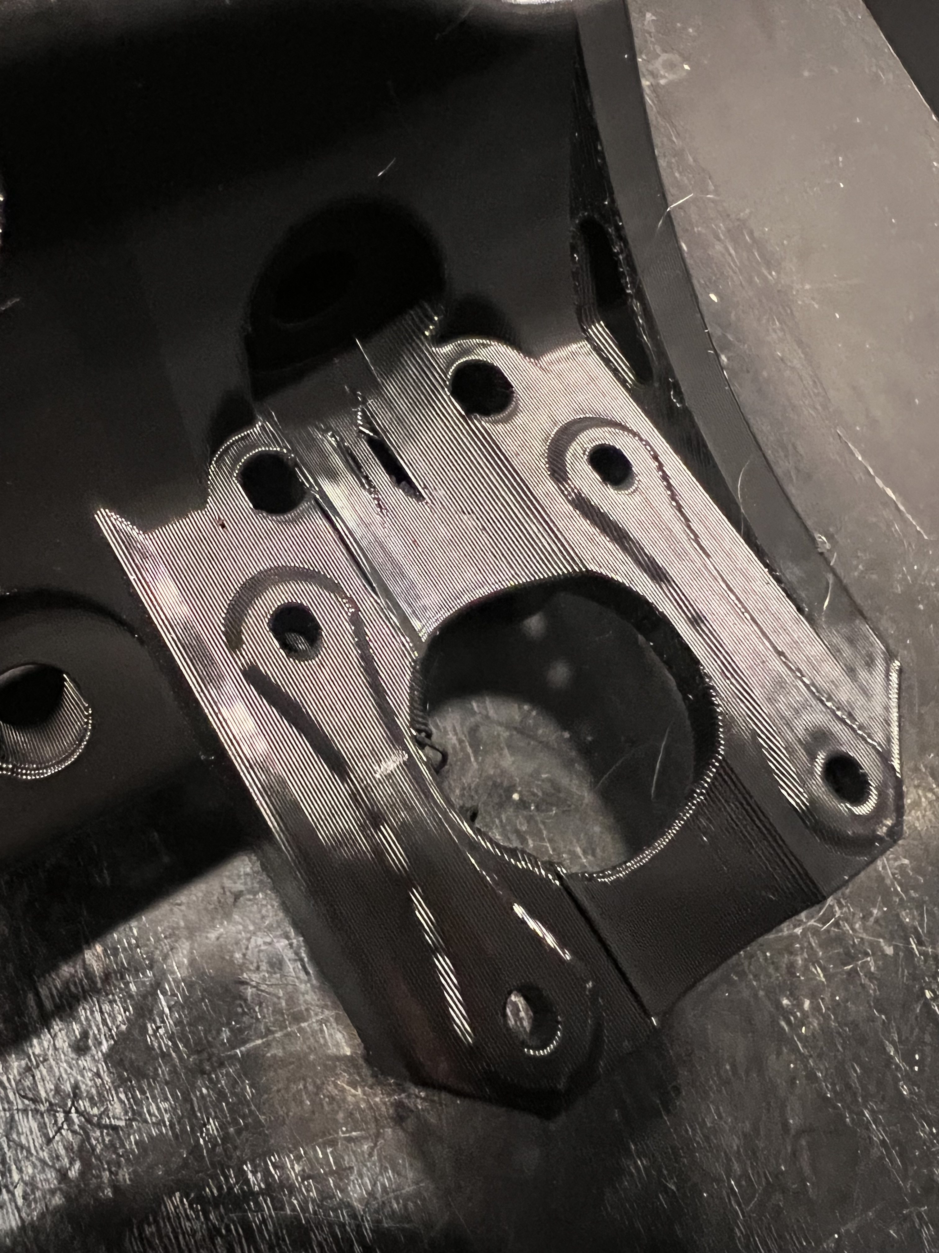

Today I made some progress with setting/squaring the base but ran into a road block. I had spun one of the nuts and stripped the nut trap on a lower corner piece.

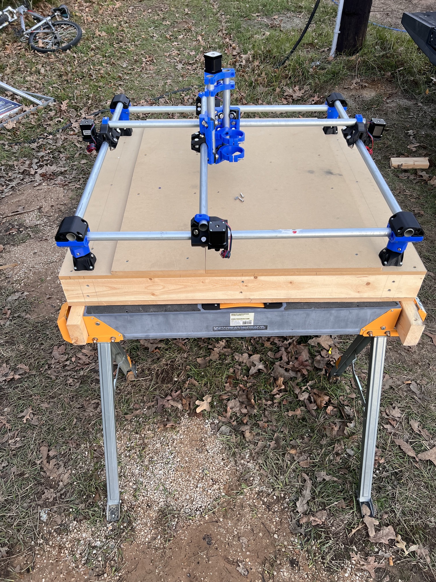

The past few days have been rainy, so I didn’t get much done on the build until today. Thankfully I was able to make a bunch of progress today.
I did run into a speed bump because I missed adding the top and bottom tool mount plates before attaching the tool mounts to the Z axis. I’m grateful that @RockinRiley found my mistake quickly and then I was able to continue with the build. Here’s where I ended up at the end of the day, just before squaring the gantry with the core installed (disregard the missing M5 screws that I had to scavenge from the truck clamps until I get some more tomorrow😉).
