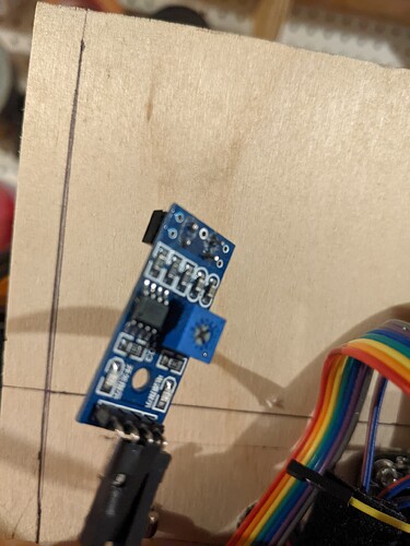

ok so I grabbed one of the arduino IR object sensors ( like $2.00 one)
Commented out the [bltouch] section and added a [probe] section. Using the bltouch pin header, connected gnd. 5v, and sense pin to digital, I got the z axis to home. Now to mount the ir sensor so it can be used… it will probably not work with a warm bed and vary with how hot the bed is and change if the bed sticker has a white design on it. Likely not the best sensor for this, but it was freely available to try and it worked once the pin was flipped in software. The sensor grounds when the light is detected and it sits at 5v until triggered. wondering if it will require a relay to not trigger during normal operation…
