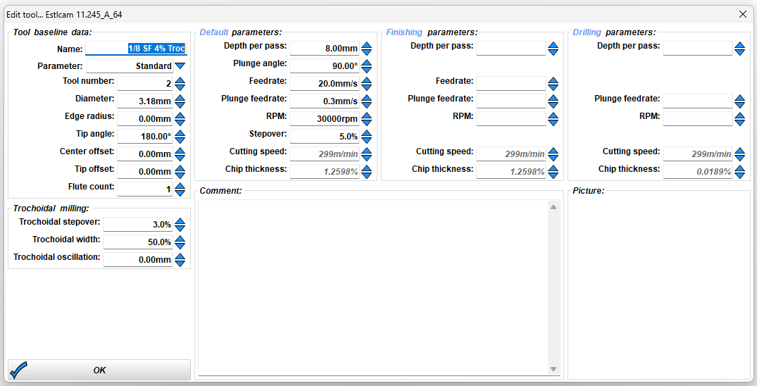

I believe 3mm/s. Are you using trochoidal milling???
Hi Jonathon sorry I just saw this today.
Yes, using troichoidal milling. Here’s the tool setup I used to get 1 XZ plate successfully cut:

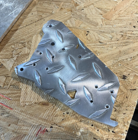

It took me roughly 3 hours to cut, with good results but not perfect:
I bought 2 endmills from the V1 store and broke one of them. The rest of the busted endmills were from Amazon, roughly $2 a pop. Possibly one of those ‘get what you payed for scenario’s?’
(I haven’t started to assemble my LR3 yet, but if I have to I will mill off the diamonds where needed.)
