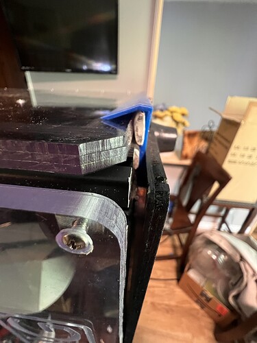

Originally yes I had the PEI sheet. But switched to glass a while back when I couldn’t get anything to print correctly. The glass has been great so far. But I didn’t notice that I had knocked 2 of the 3 clips loose when I look a part off so I guess it was able to move around. Thinking about taking some glue stick and running it between the aluminum and the glass to see if that will hold it down better than the clips.
Doh, was so focused on prints in your pics that completely missed the glass bed ![]()
LOL no problem I sure didn’t point it out in the post.
Duh~ I’ve even had clips fall off on glass beds, I also ASSumed you had a magnetic bed sheet.
Glad you found the issue. This forum is great!
