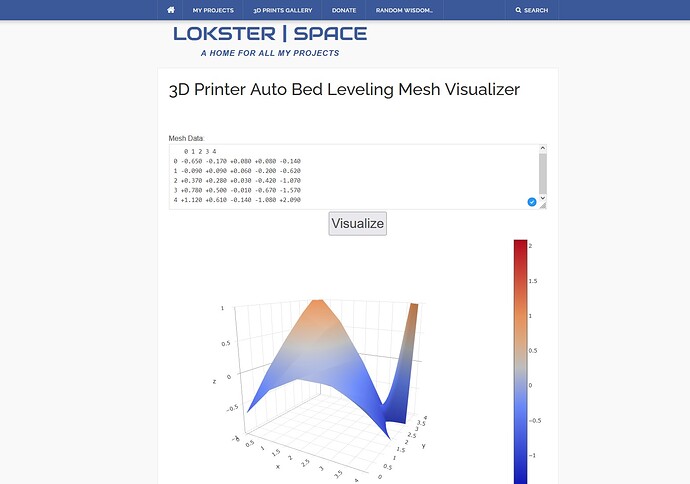

So after my 3 point leveling that looks almost exactly like that, My mesh is all well under 1mm, I think it is all under half mm. So whatever readout that is, must be raw data? M420 T1 V1 shows the data we need, but it didn’t work last time.
Earlier when i ran bed level from the LCD it said it saved it to eprom but when i run that now it says the same thing…invalid mesh
I just ran it again and when it got to the last spot where it always fails i picked up on the bed so i knew it would hit the probe. Now M420 T1 V1 gives this…
M420 T1 V1
Bilinear Leveling Grid:
0 1 2 3 4
0 -0.650 -0.170 +0.080 +0.080 -0.140
1 -0.090 +0.090 +0.060 -0.200 -0.620
2 +0.370 +0.280 +0.030 -0.420 -1.070
3 +0.780 +0.500 -0.010 -0.670 -1.570
4 +1.120 +0.610 -0.140 -1.080 +2.090
echo:Bed Leveling ON
echo:Fade Height 5.00
ok

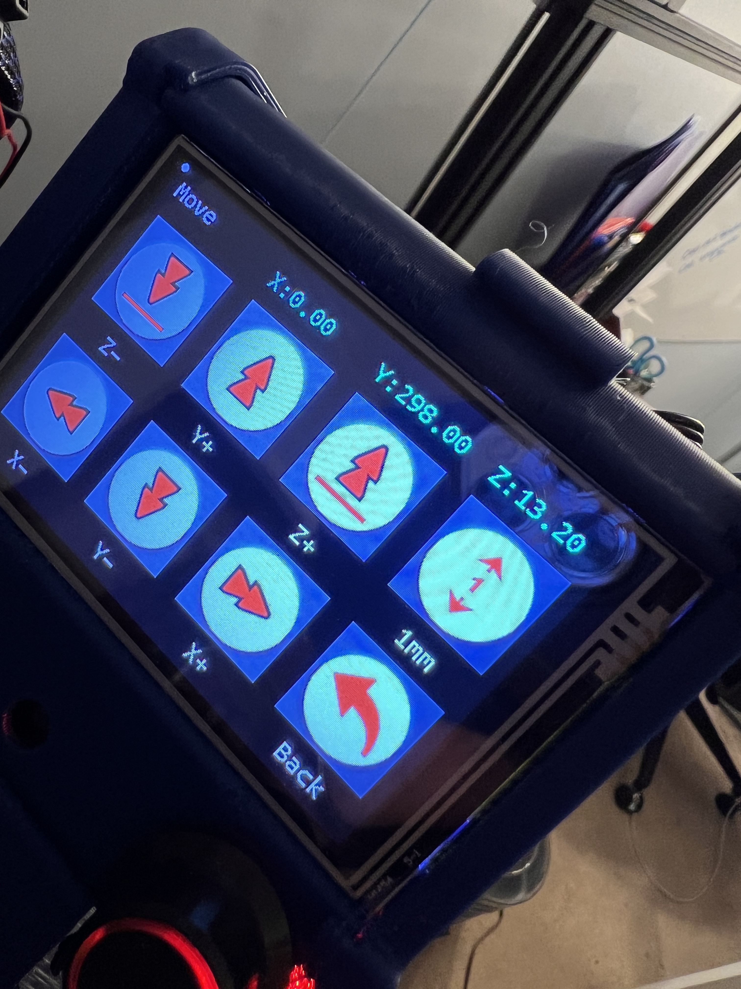

Ok finally was able to do this. Nozzle is at the edge of the PEI sheet at 290mm. It’s 1mm away from hitting the back corner at 298mm. But noticed something…
Assuming I have a major build error somewhere to cause this to be that far off

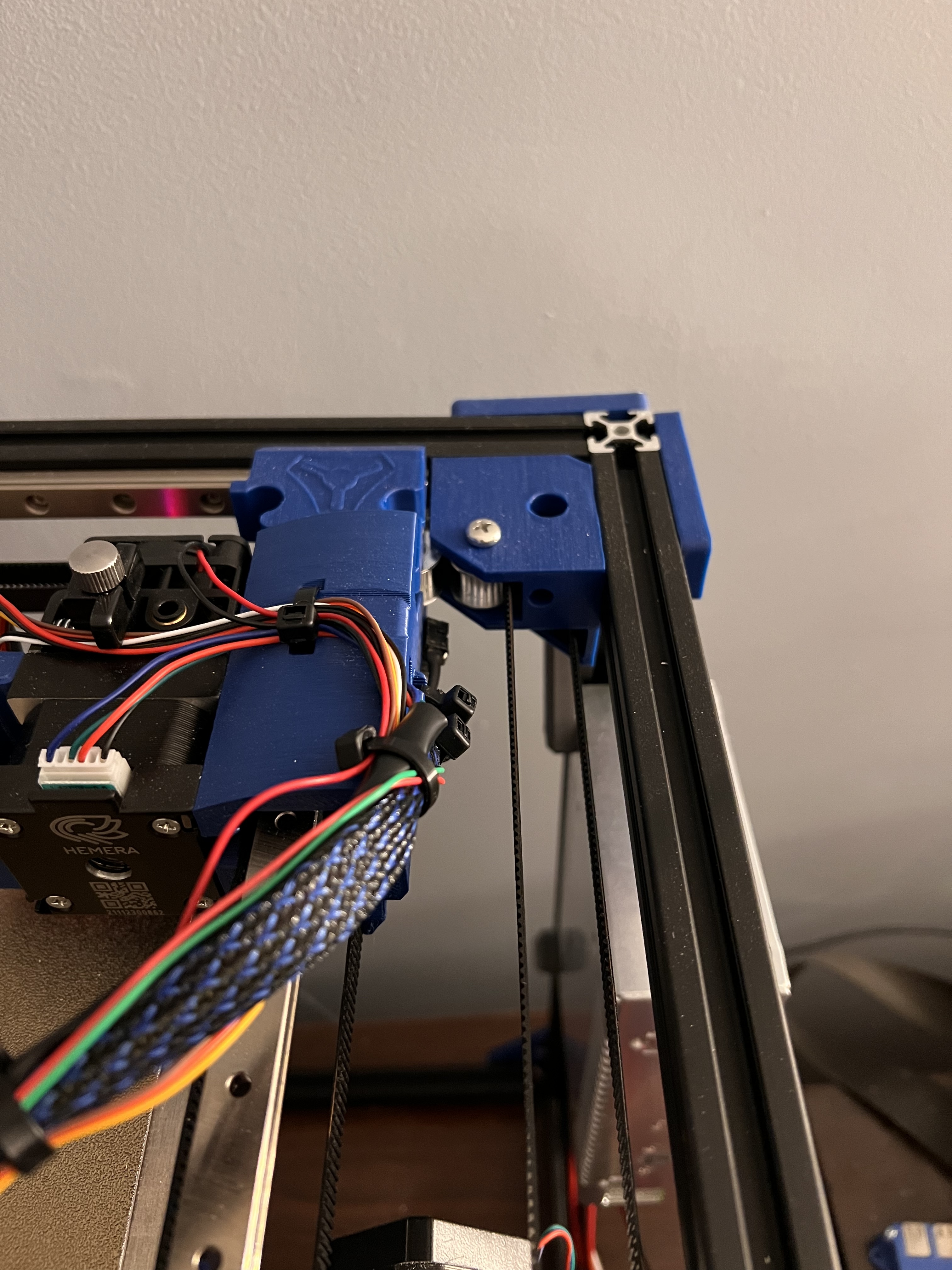

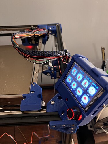

So that arm is adjusted by the XY belt tension. (if you pull on a belt in teh back you will see how it moves the X rail. Make sure it hits the endstop at the front (y endstop), and fairly square at the back. You might need to loosen the 4 screws on the X rail to move it far enough. You probably need to adjust the belts if it is that far off.
You can also pick up a few mm Y if you move the Y endstop a few mm back, meaning loosen the belt if needed.
Guessing that is causing binding and moving your probe.
Do you have full X travel?
Yes sir. Funny thing is i had to bend the Y end stop so it would hit. The belts are pretty loose right now since we thought that was part of my problem in the beginning (Damn Grub Screws :man_facepalming:) so i will play with that and see if i can get it sitting better that direction.
