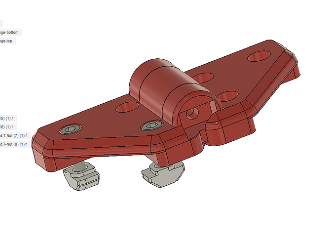

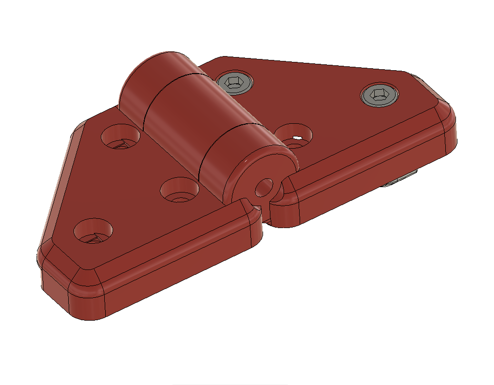

Assembly, panel corner clip hinge
Was looking for 2020 hinges that can also hold/protect 1/8" (3mm) panels attached to both the top lid panel, and bottom back panel. Hinges need to support Lid weight, and resist twisting/shear forces from the Gas Struts. Struts are currently 20N 4.4lb, still looking for 10N 2.2lb … 3D printed damper would be nice.

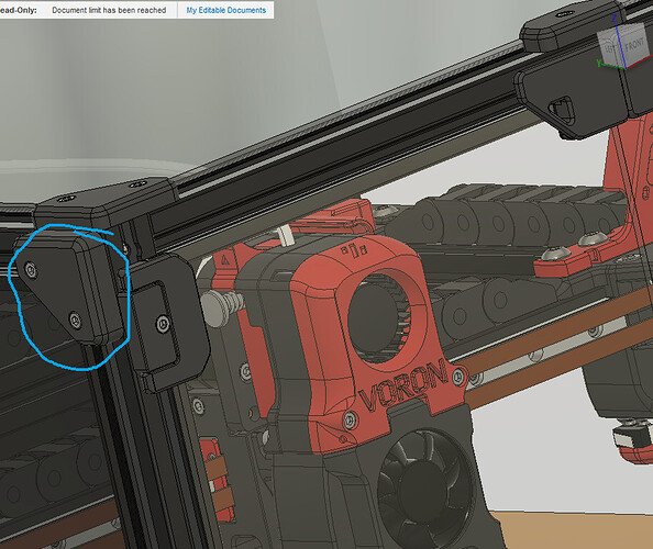

Looked at various designs, ended up forking a Voron Trident 2020 corner panel clip 4mm.
Modified by mirroring the corner clip, then added a stocky hinge large enough to capture T-Nut for the M3 x 30mm button head bolt. Intentionally left 1mm gap between top and bottom 2020 for foam/TPU seal to compress when Lid closes.

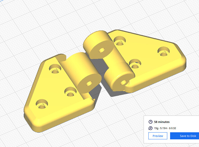

Print orientation doesn’t require support, but won’t be ideal strength, hopefully good enough…
Parts:
  • 6x M3x10mm button head bolts
  • 6x M3 Roll-in nuts. Couldn’t use slide-in nuts since they’re too large to fit in couple of spots where perpendicular 2020 extrusions meet, partly because of the interior 1/16" thick panels sandwiched between the X and Y 2020. Although M3 T-Nuts might fit, they won’t hold Lid as securely/reliably. So… Used Roll-in nuts.
  • M3x30mm button head bolt (newer version with 90 degree stop uses M5x30mm)
  • M3 T-Nut
  • Print aza-hinge-top.stl and aza-hinge-bottom.stl parts at Printables or Github.
