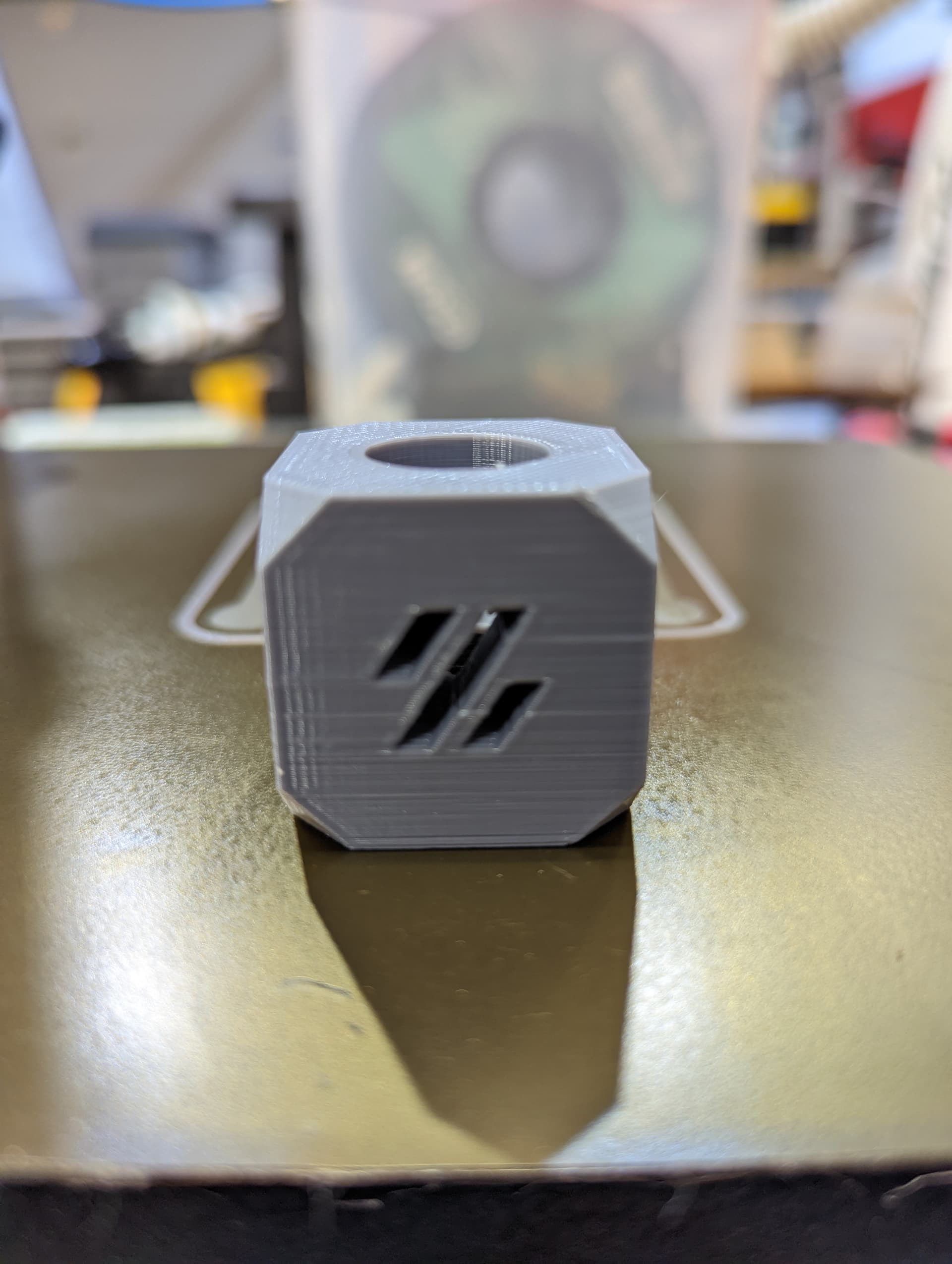

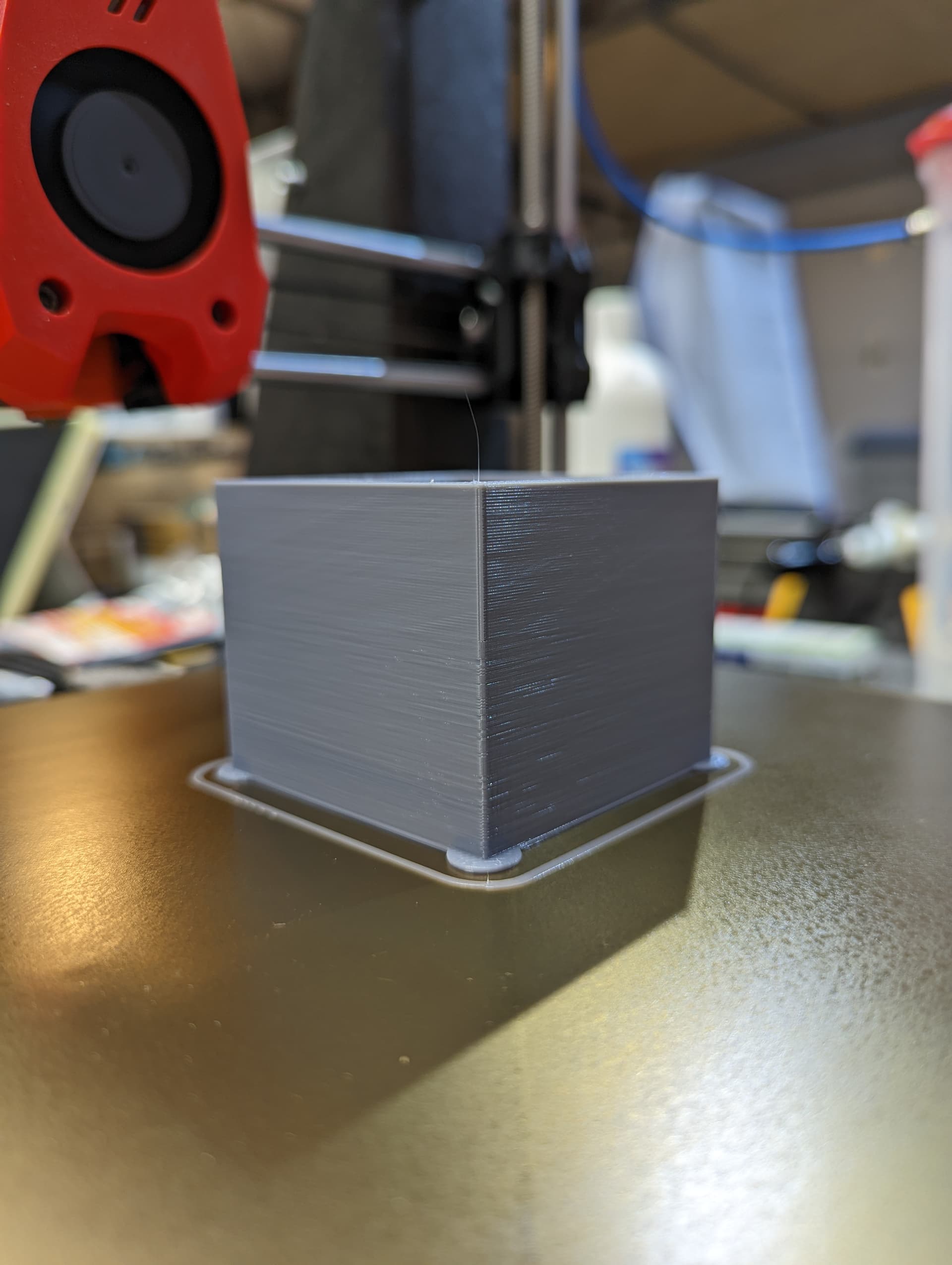

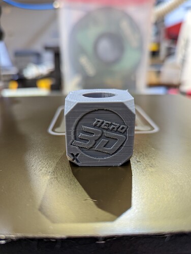

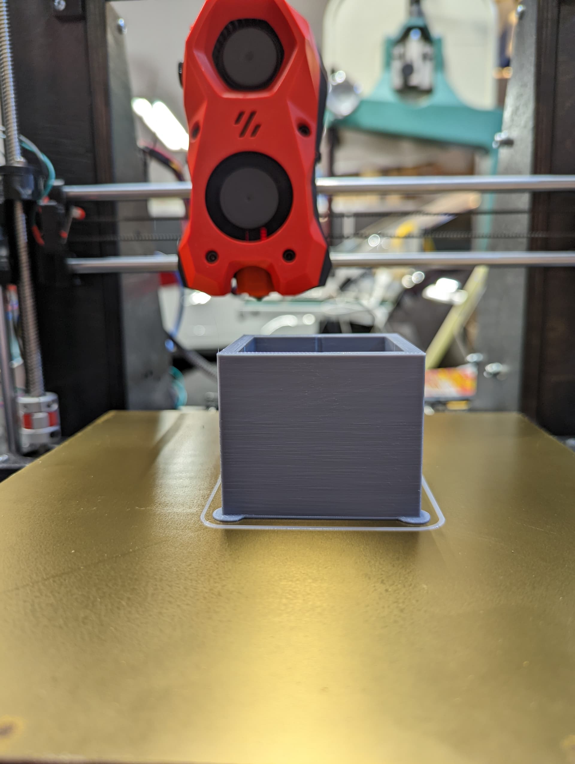

My printer uses mesh leveling (like many printers these days) and the Z is constantly changing up and down as XY changes. So I don’t buy that full step multiple stuff at all. The range in Z is well over 0.04mm and I get very consistent Z layers.

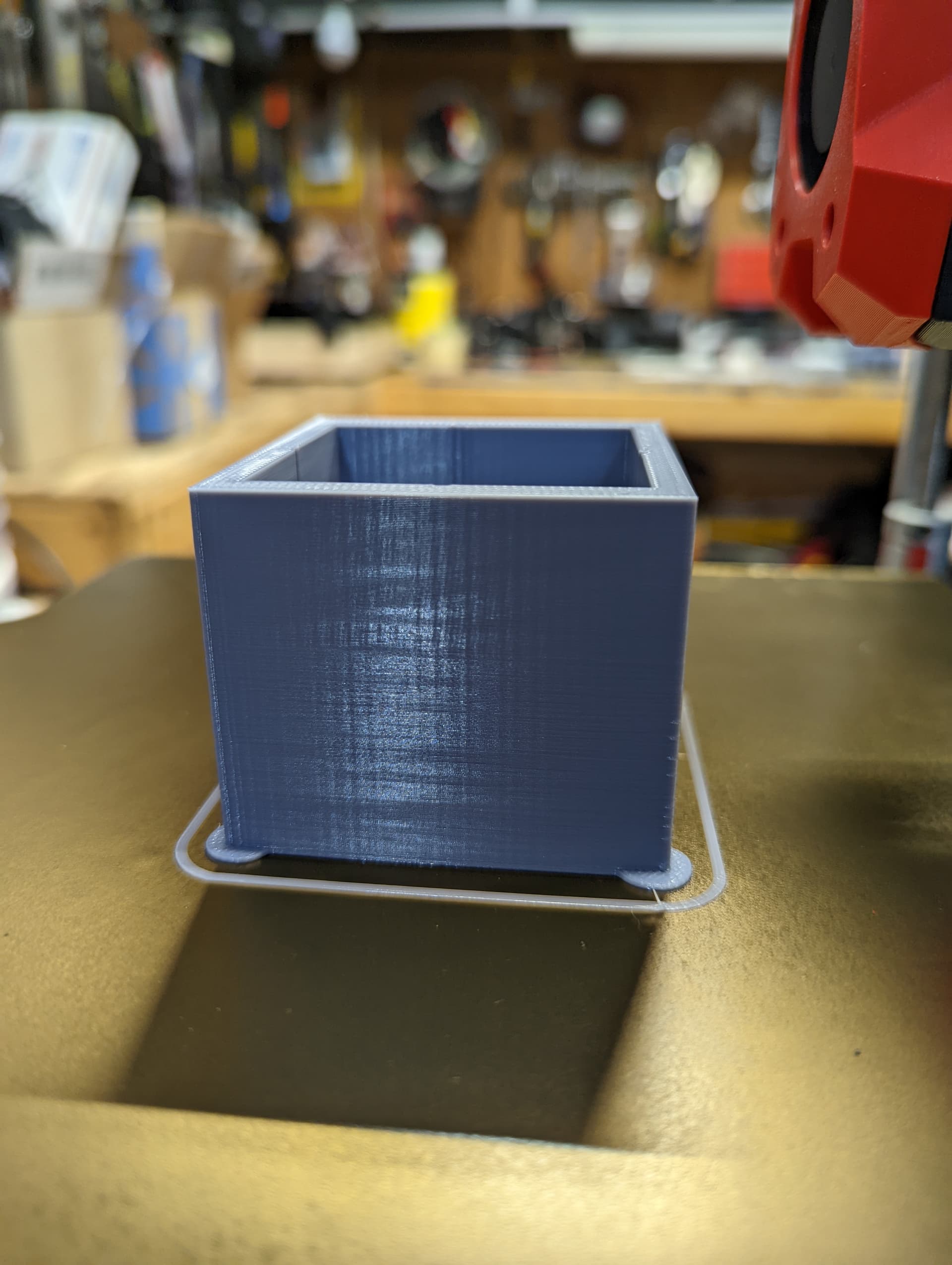

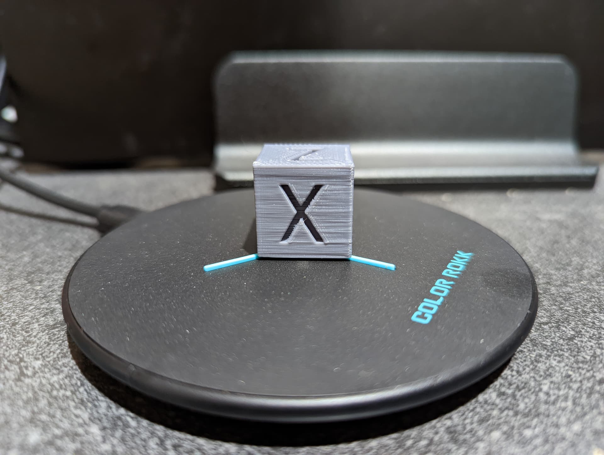

I messed with the lead screws…took them out of the couplers and put them on a straight edge. One was ever so slight raised (not flat). I put it back to get leveled the x axis and this time I reprinted the tower cube.
I used super slicer - default settings for a voron 350 - 2 walls, 0 infill, 4/4 top and bottom… I am pretty sure me messing with the lead screws has zero impact. The tower test when doing the pressure advance was pretty clean too and that was before messing with the lead screws.

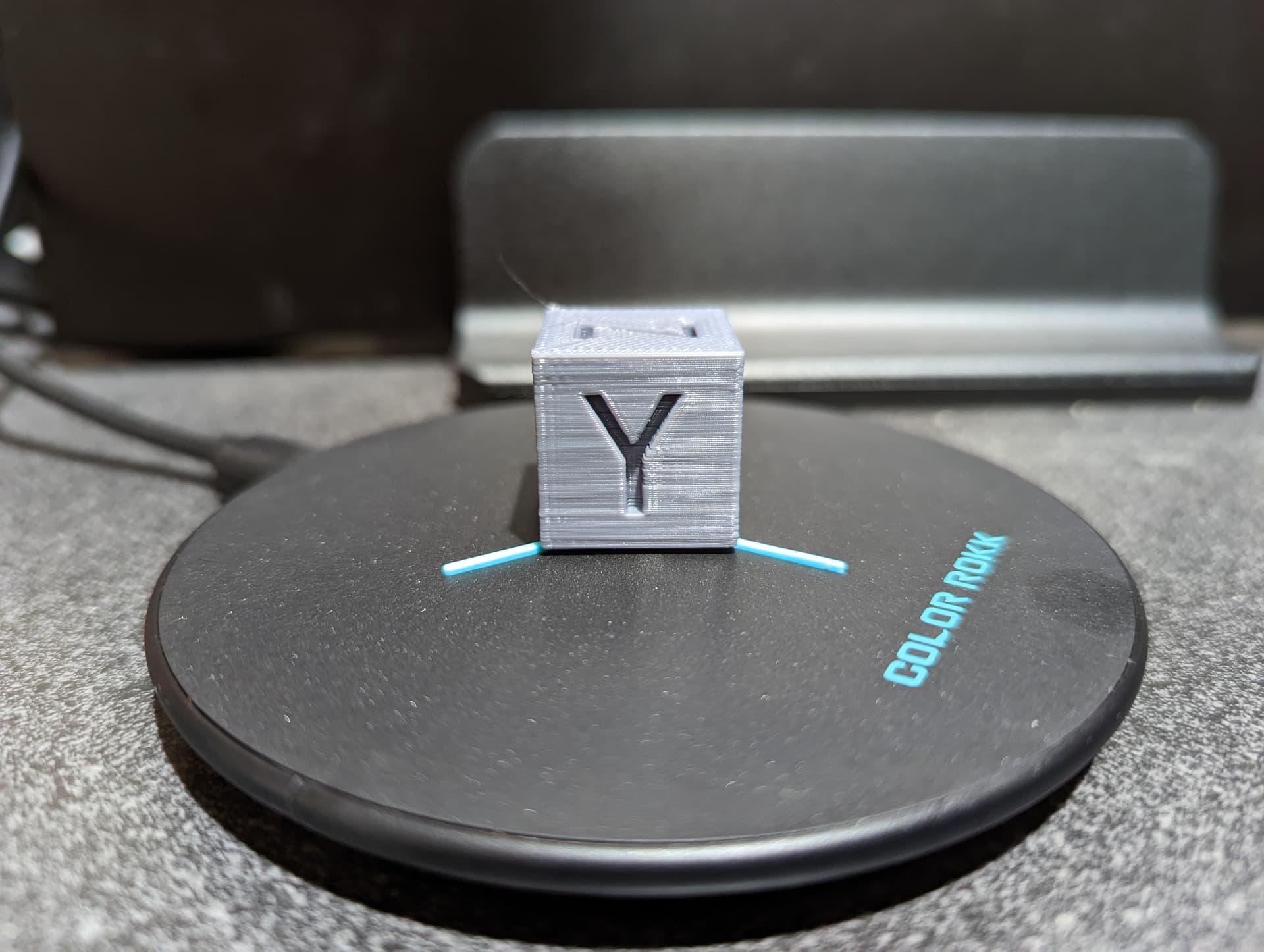

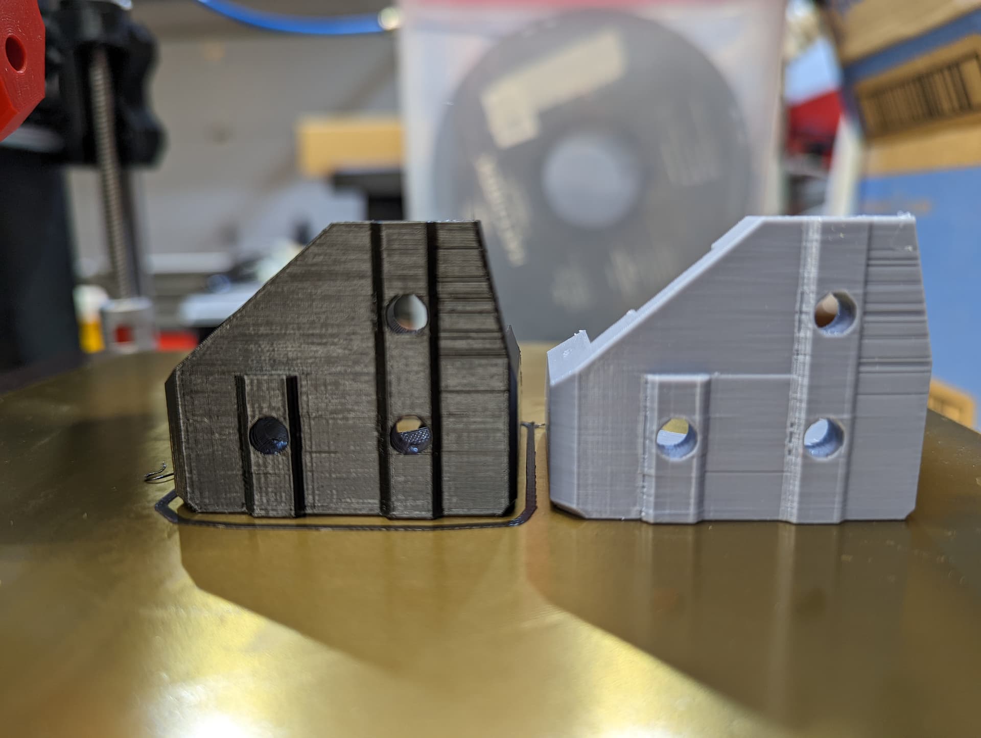

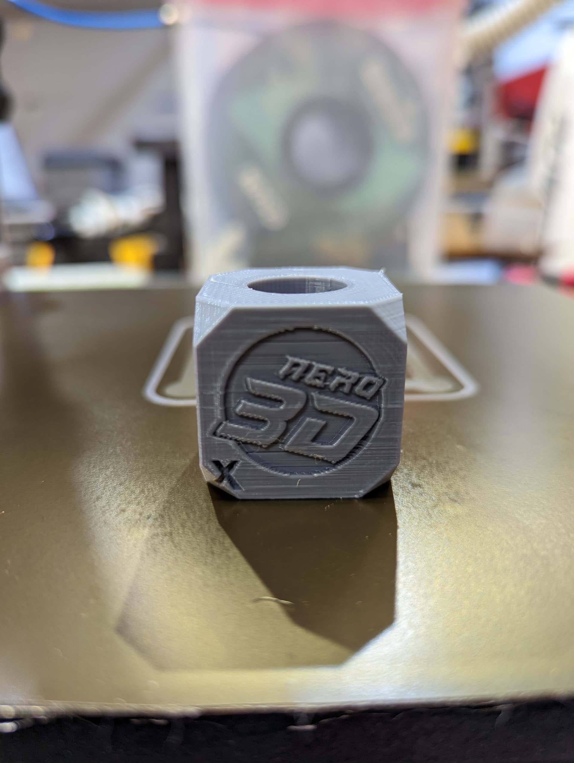

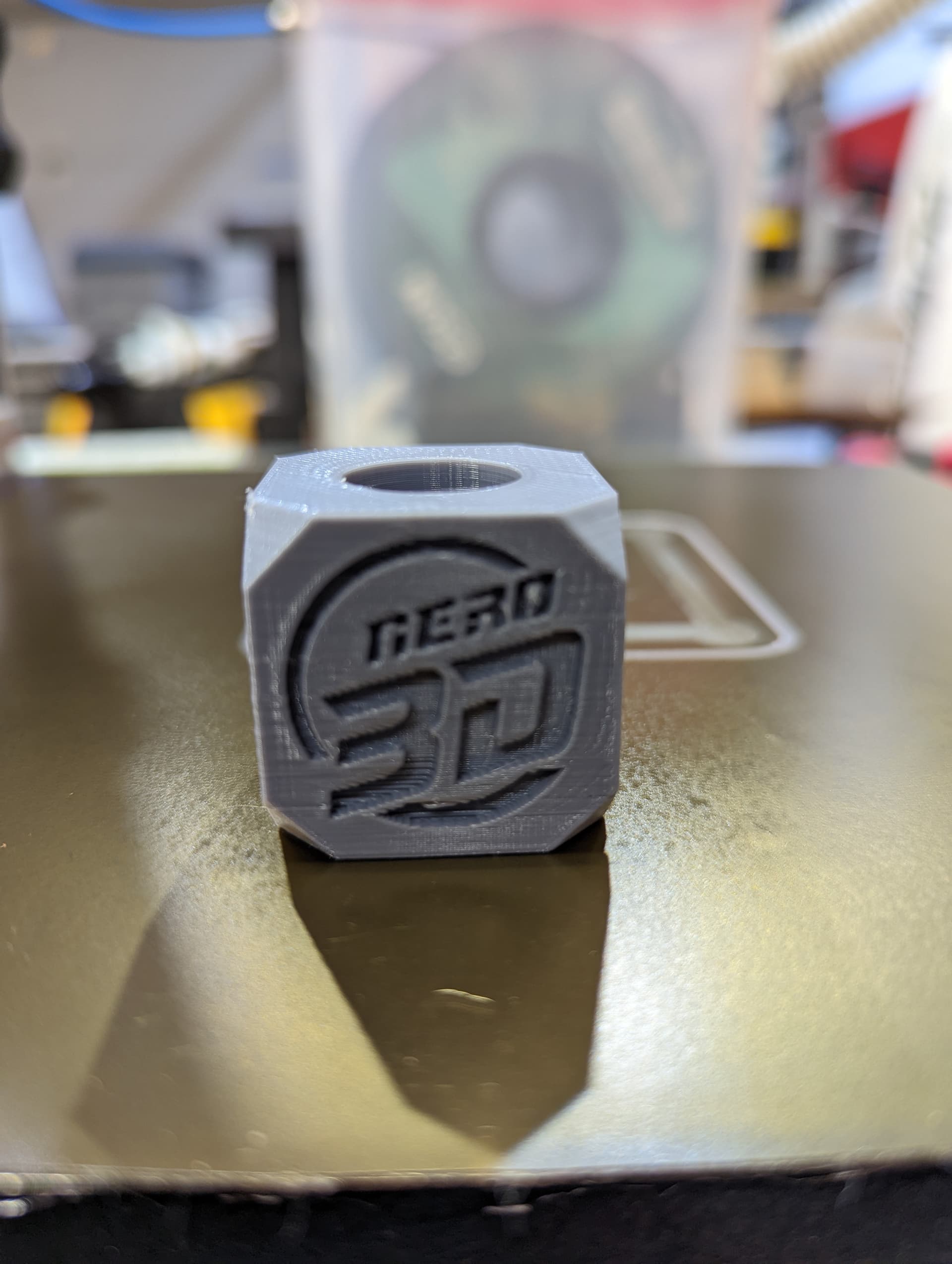

I was watching the Nero 3d live stream tonight and saw he had his own cube so I printed that on the inside of the tower. This print now looks like all of the other prints and nothing like the print quality on the tower cube. I am really not sure what is going on … if its mechanical or slicer related.
The lines on https://us2.dh-cdn.net/uploads/db5587/original/3X/8/1/81f109b1fd42a693eb90e7e8961ebdf6a4f44f47.jpeg look like what we call “the ripple”. It’s caused by all belt driven printers, but unless you have a really dialed in printer, the other print artifacts kinda conceal it.
You have some ringing around the corners, some resonance tuning should help with that.
The corners are also really wonky so the acceleration settings seem to far off for the resonance to help.
Have you walked through teaching tech tuning guide? It is really good.
https://teachingtechyt.github.io/calibration.html
At the minimum, I would do esteps and accel. Temp and retract are awesome as well.

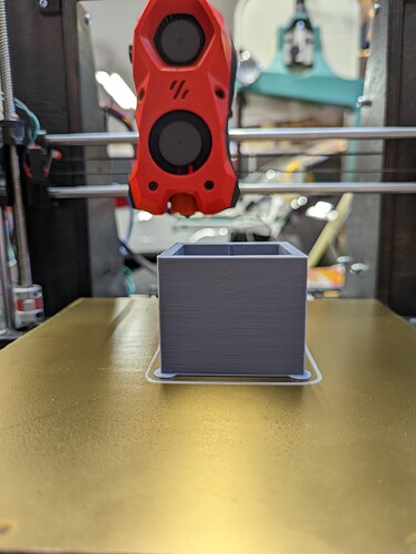

I am in the process of going through all of that now… hind sight is 20/20 I know I should have started there but didn’t… so far the outcome looks good. I have done the PID tuning for hotend and bed. adjusted my rotation distance for my extruder. I have adjusted the belts to where they should be tension wise. I did a 20mm test cube and now I am working on the slicer flow calibration. Yesterday I also adjusted the Z stepper current. After I get the flow dialed in I am going to reprint the original “face” part as Jeffeb3 coined on one of my photo line ups.

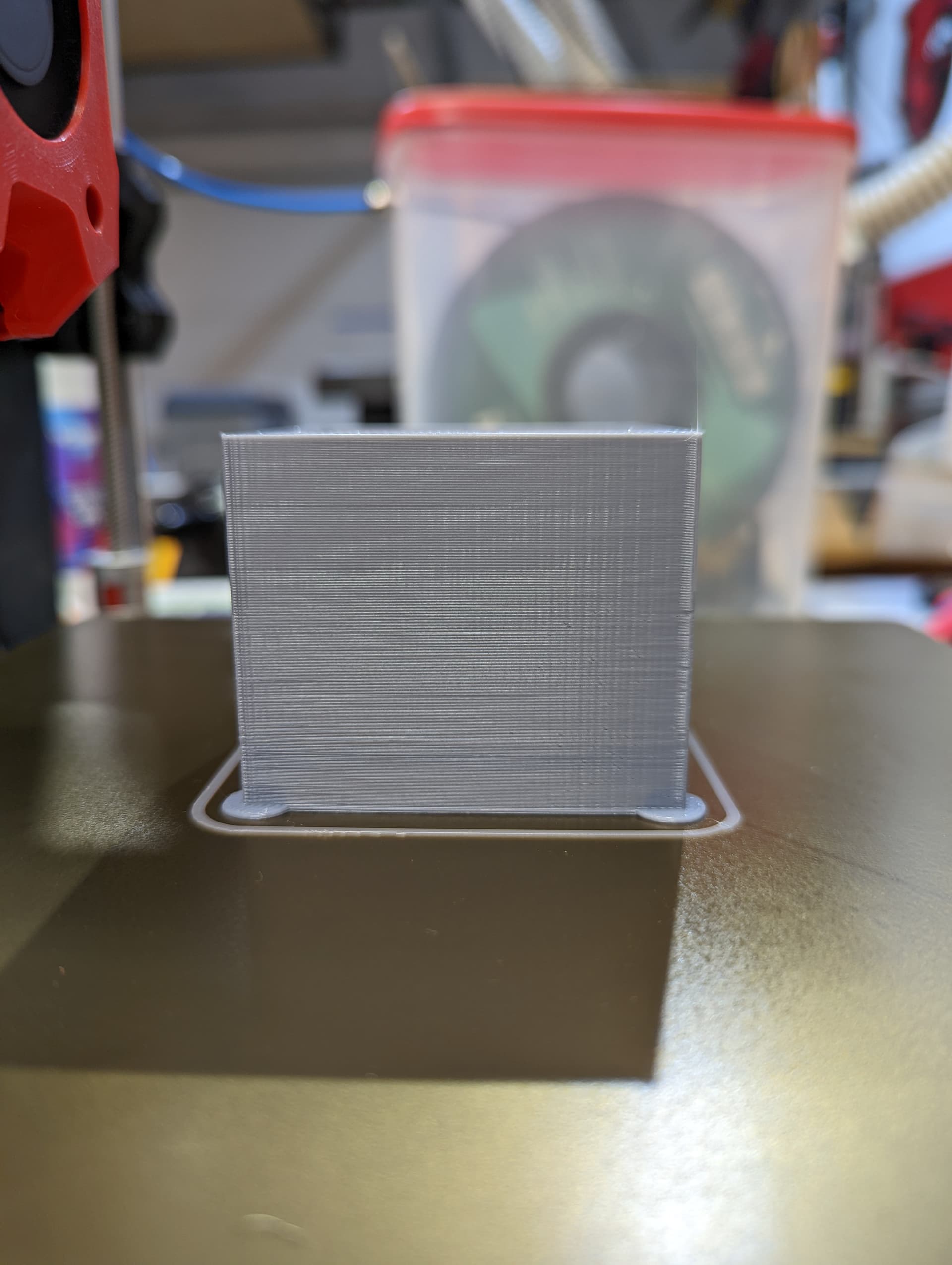

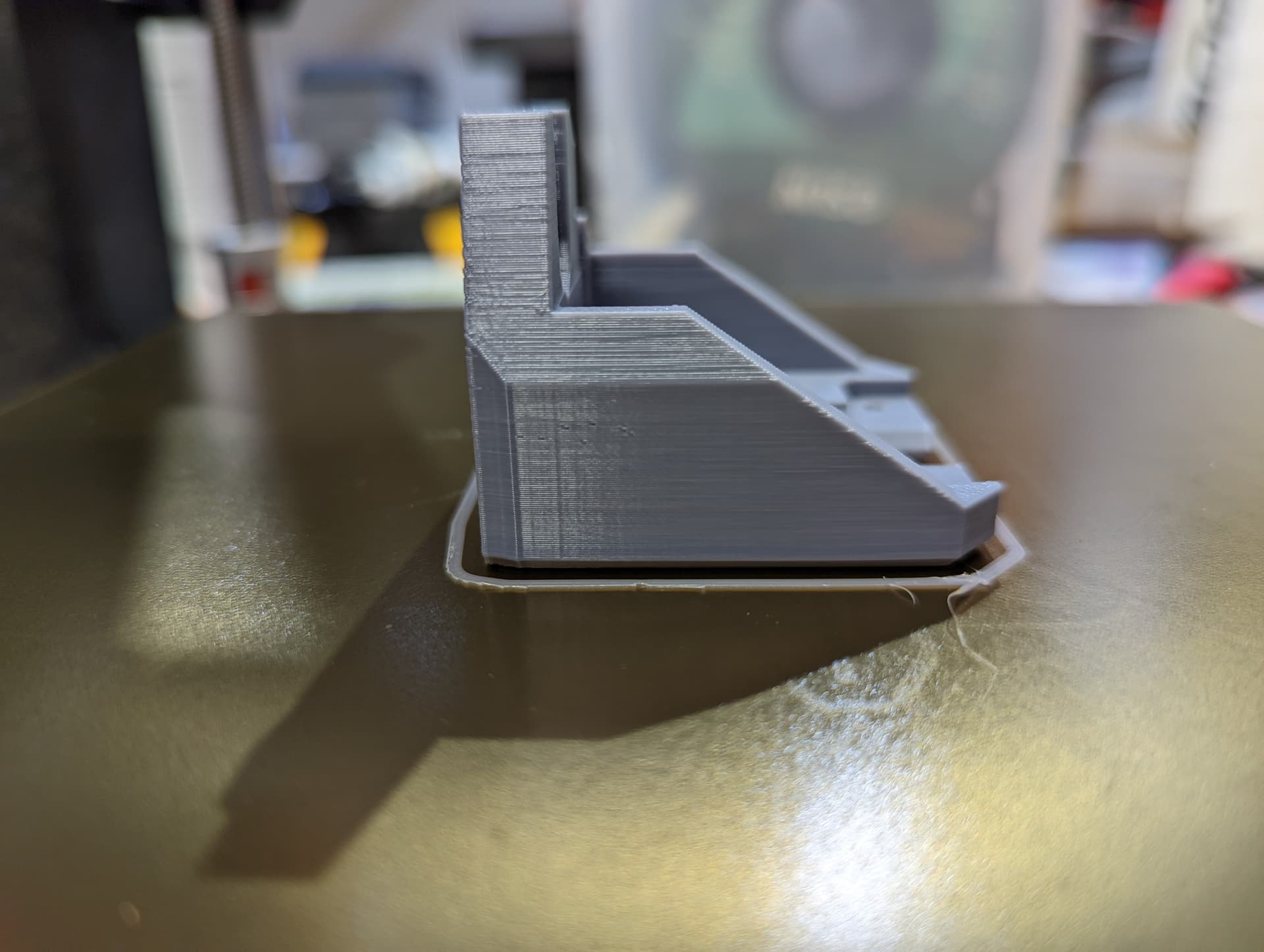

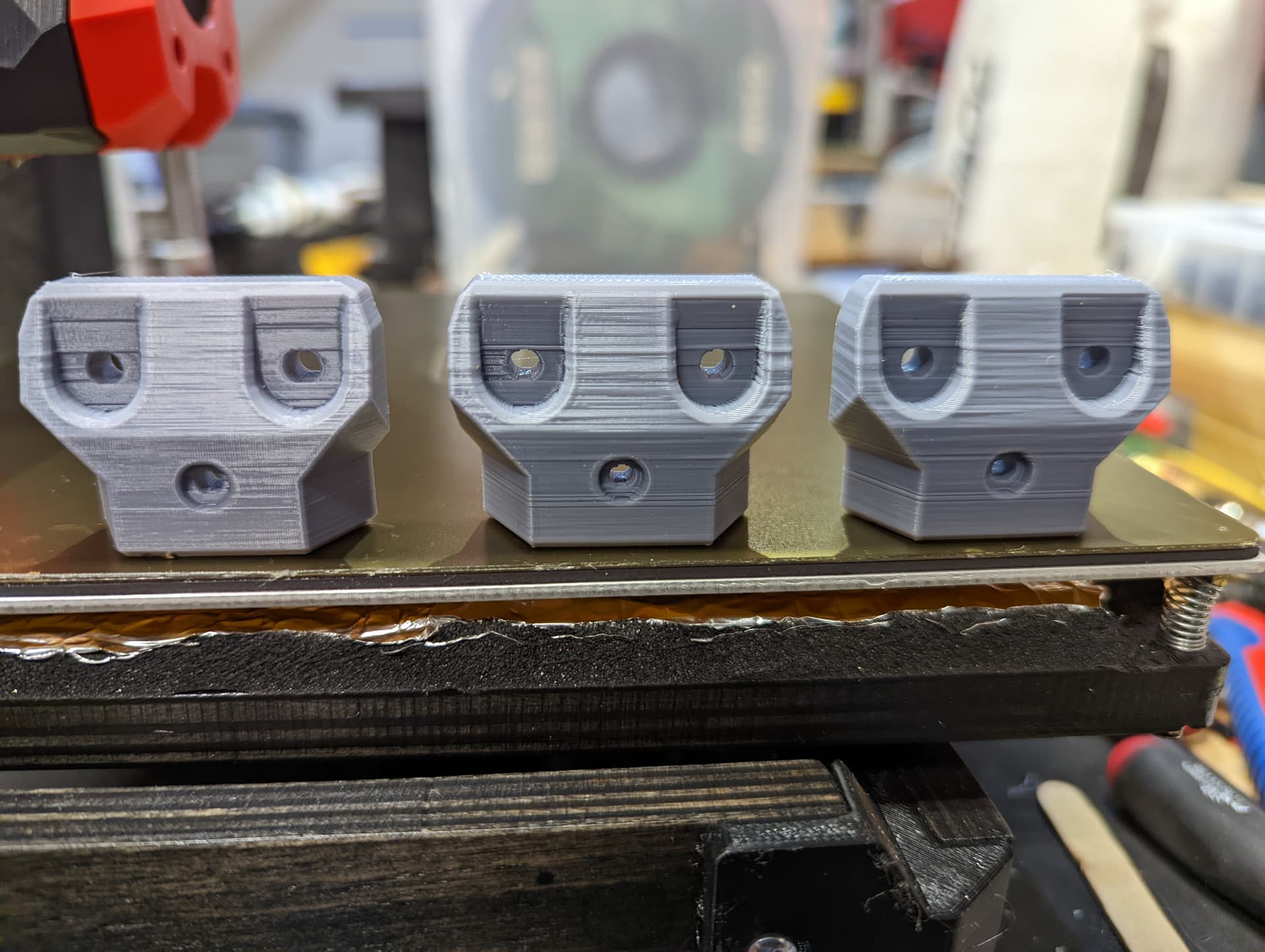

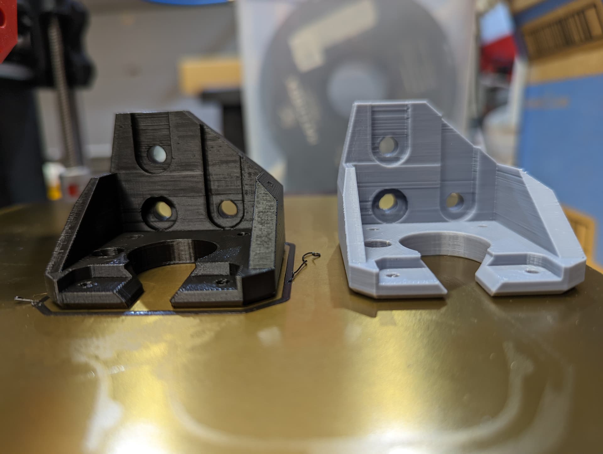

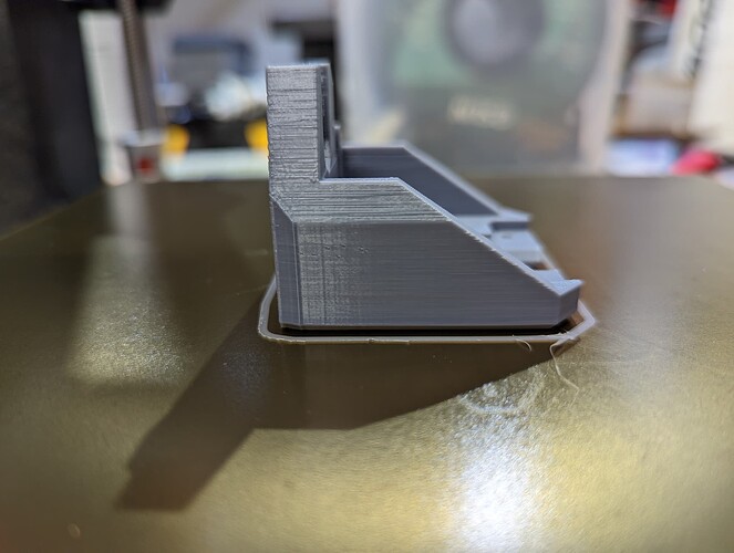

Part on far left is after initial tuning – camera surely brings out the lines but I would say the part is much better and looks better to the naked eye.

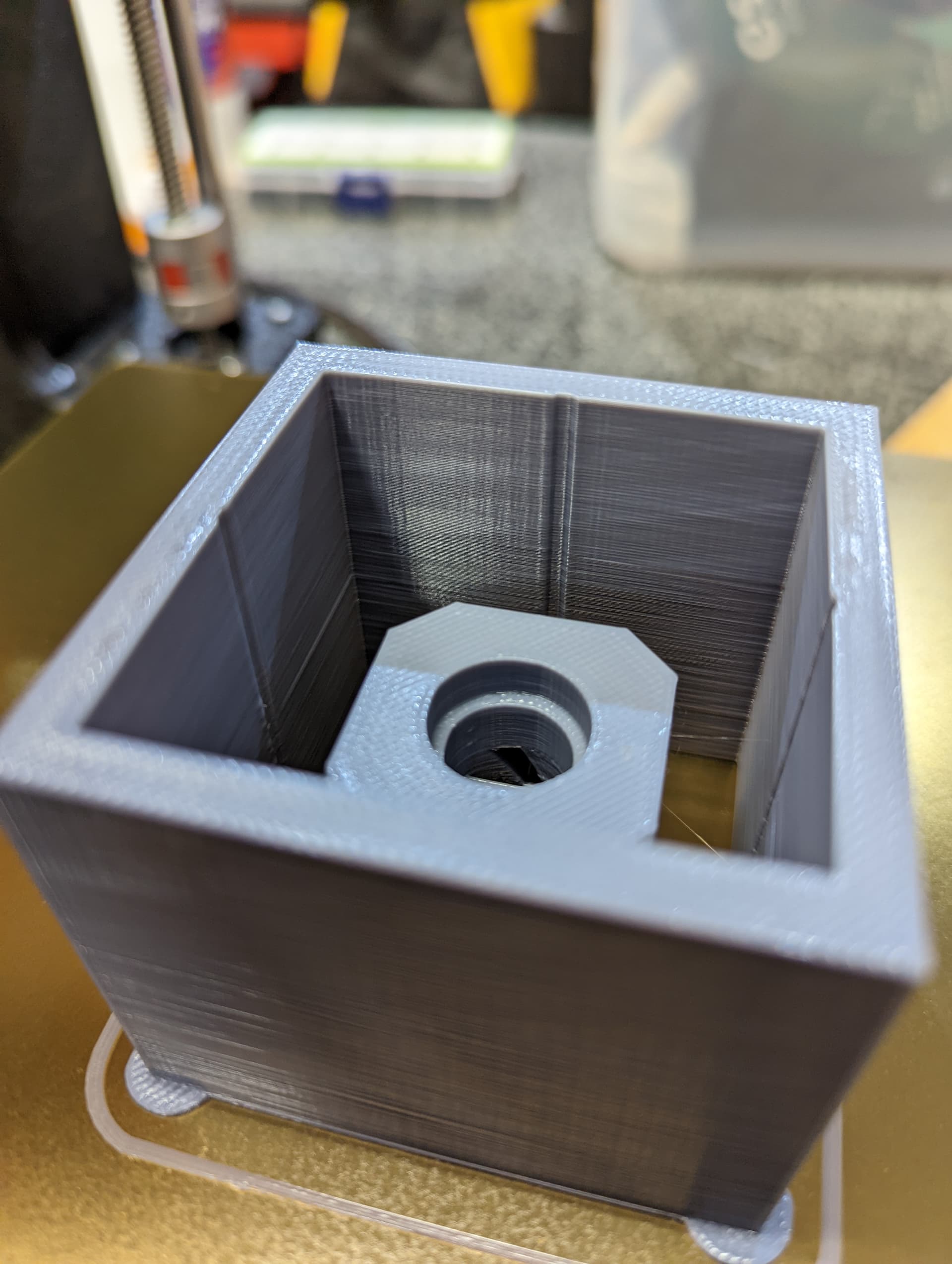

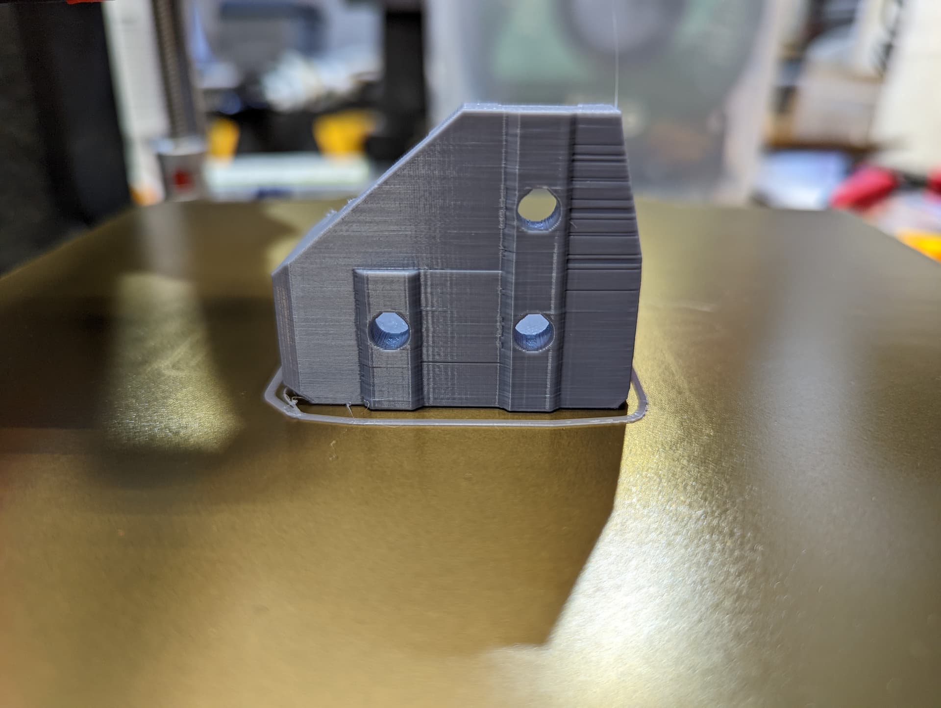

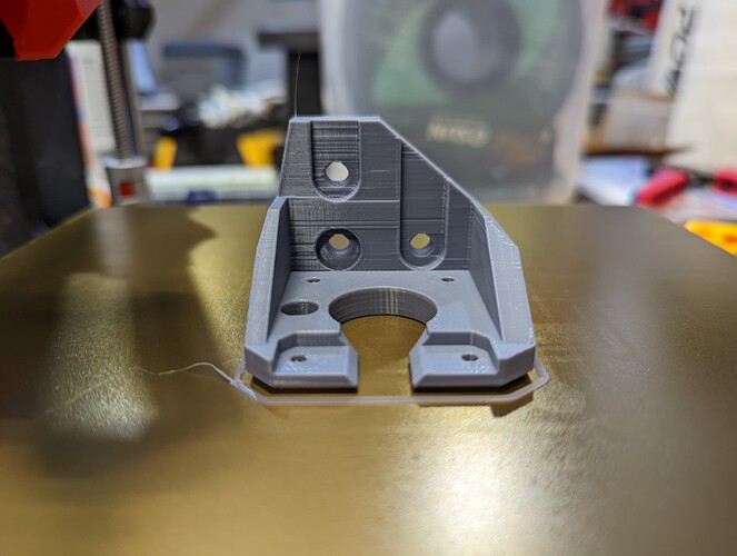

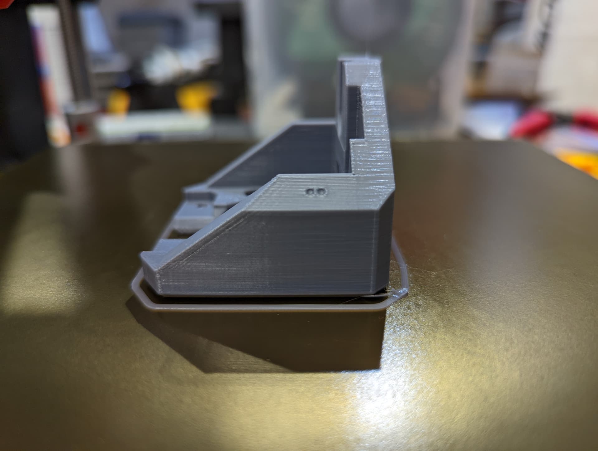

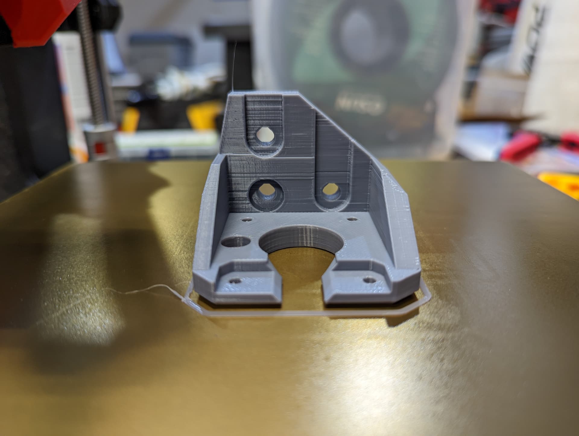

Here is another functional part. Its dimensionally accurate. I think the overall outside finish looks good.
However, the areas where the bolt holes, both front an back seems to have the same issues as the earlier prints.
Definitely better. Maybe try a darker filament :slight_smile:
I said that jokingly, but it could actually be the filament varying in thickness.
Yeah for sure… Gotta love this stuff so so many variables…
I wondering if it has anything to do with acceleration?? who knows… I am going to watch teaching tech’s video on that and see if I learn anything that may help… the part is functional so its a pass for me.
And yes, I have darker colors on the way for these parts I have been printing.
Too high of an acceleration setting can have a similar effect to too high a velocity setting. On extrusion it may prevent retraction. On other axes, at the extreme too high settings will cause skipping steps. At less of an extreme you’ll see the “ringing” echoes around corners.

That does look like acceleration and deceleration, can you post a new printer.cfg with all your newest changes?

The Picture from the tower test looks great!
And that is because you force the printer to use only SQUARE_CORNER_VELOCITY=1 ACCEL=500

My thoughts are that you should chage your max_accel, start small, 500 maybe? add max_accel_to decel, Klipper Docs say that “usually” 50% of your max_accel is good.
Change square_corner_velocity. The default is 10.0, I left my at 1.0 just like the tower test.

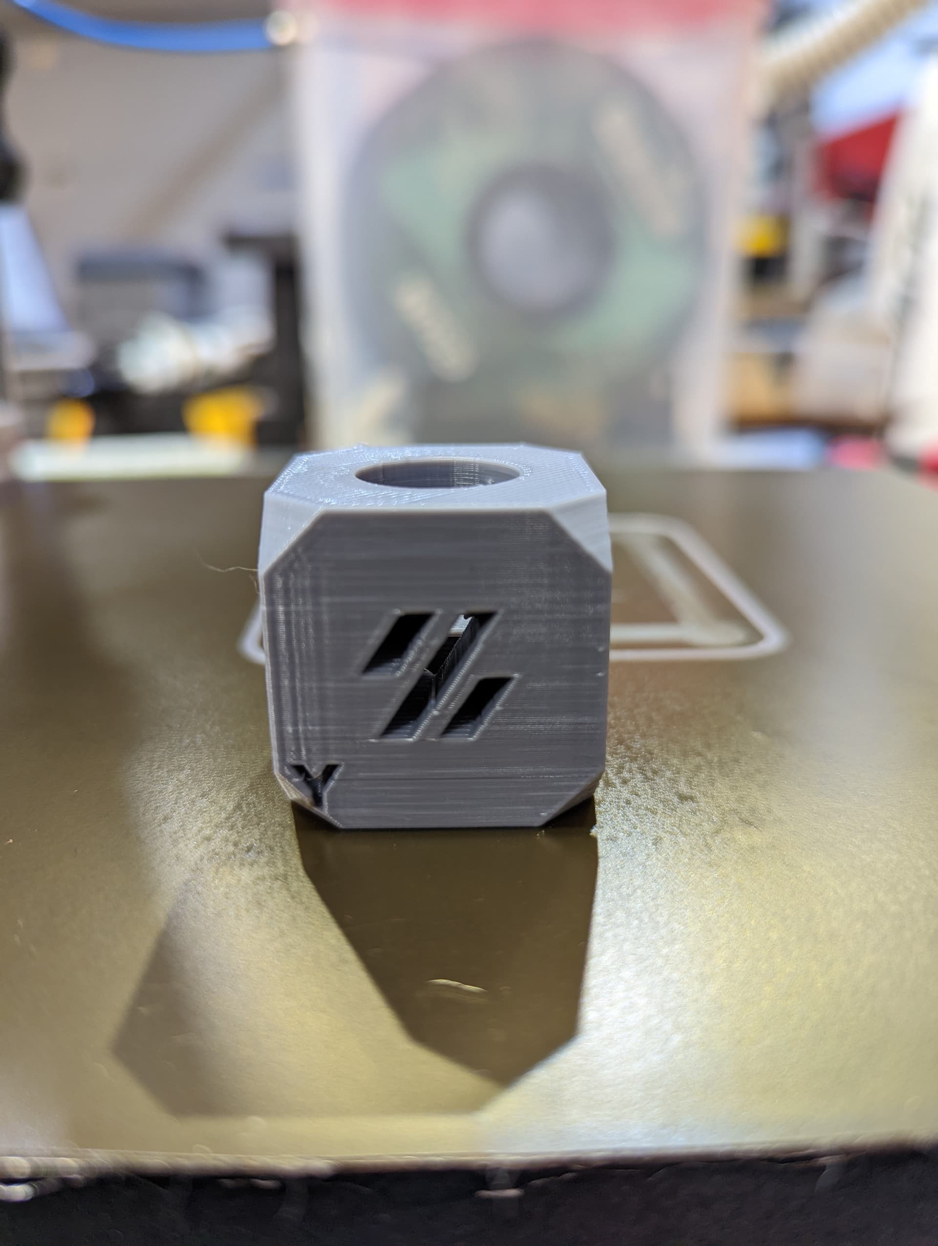

I ran that similar print again today and had the same issue at the holes and where it protrudes out (part goes onto a 2040 extrusion). I had tried these settings: 40mms 500acc , internal 80 - 100mms 2000acc . I think at the end of the day I am just printing way to fast. The printer has a Phaetus Dragon Standard Flow. Today I switched to a different filament and like I said, the banding showed up again just like the prior part .
printer.cfg (2).zip (4.0 KB)
Let’s try something.
Keep your max_accel at 2000
Add max_accel_to_decel: 1000 or even 750

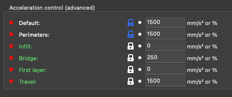

Change your slicer settings a little.
Under Print Settings/speed
Screen Shot 2022-03-14 at 11.20.43 PM
These settings will override your printer.cfg max accel
And on. Printer settings/ speed, change all your speeds to the same value, something like 60mm/s
The point here is to try to eliminate those lines/artifacts
IMHO I think you have an acceleration issue, and it is only in on Y axis base on Klipper docs.
See if that will do anything for you.
@gpagnozzi thanks much for your feedback… I will give it a try tomorrow. much appreciated!
Results are back… seems those tweaks seemed to help … there is still a slight line/shift in layer just before the upper most hole recess.

I think you should keep playing with Max accel, lower it a little more, print a test part, lower again until you get rid of it them start increasing your print speed.
