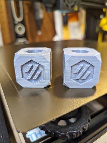

Yes looks better to me, but I do see some bulging in the corners and some ringing on both X and Y axis. You should run Pressure advance to minimize that
Did you measure the cube with a caliper? how off are you from the 20mm?
Did you double check rotation Distance?

The Voron cube I printed has these measurements
Z = 30.03
X = 29.94
Y = 30.02
I tried the pressure advance but I must have done something wrong because after I set it and then went to print something the object was under extruded and the corners were not square.

For the time being I am leaving it is and will do the ringing tower print and will report back. However, I did change the printer details to match yours. Hopefully I print it correct. I print with zero infill and 2 shells.
I printed the tower test with pressure advance.
After the calc I ended up using a pressure_advance = 0.0465
Cube on the left is before and cube on right is with the above setting - I cannot tell the difference.

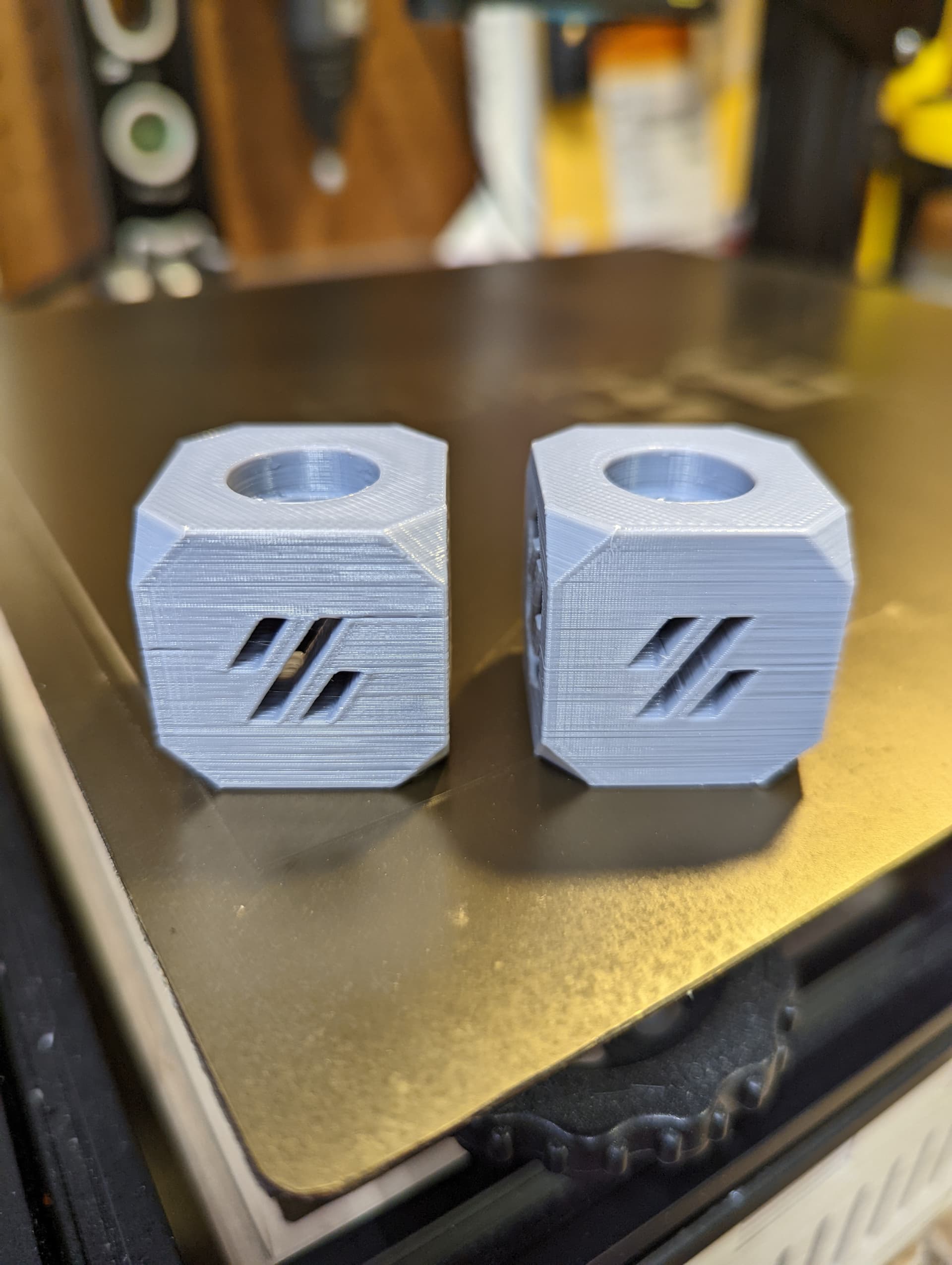

I tried a couple more prints… for the life of me cannot figure out what is causing this rough print surface.
Is it z wobble or an extrusion issue ??

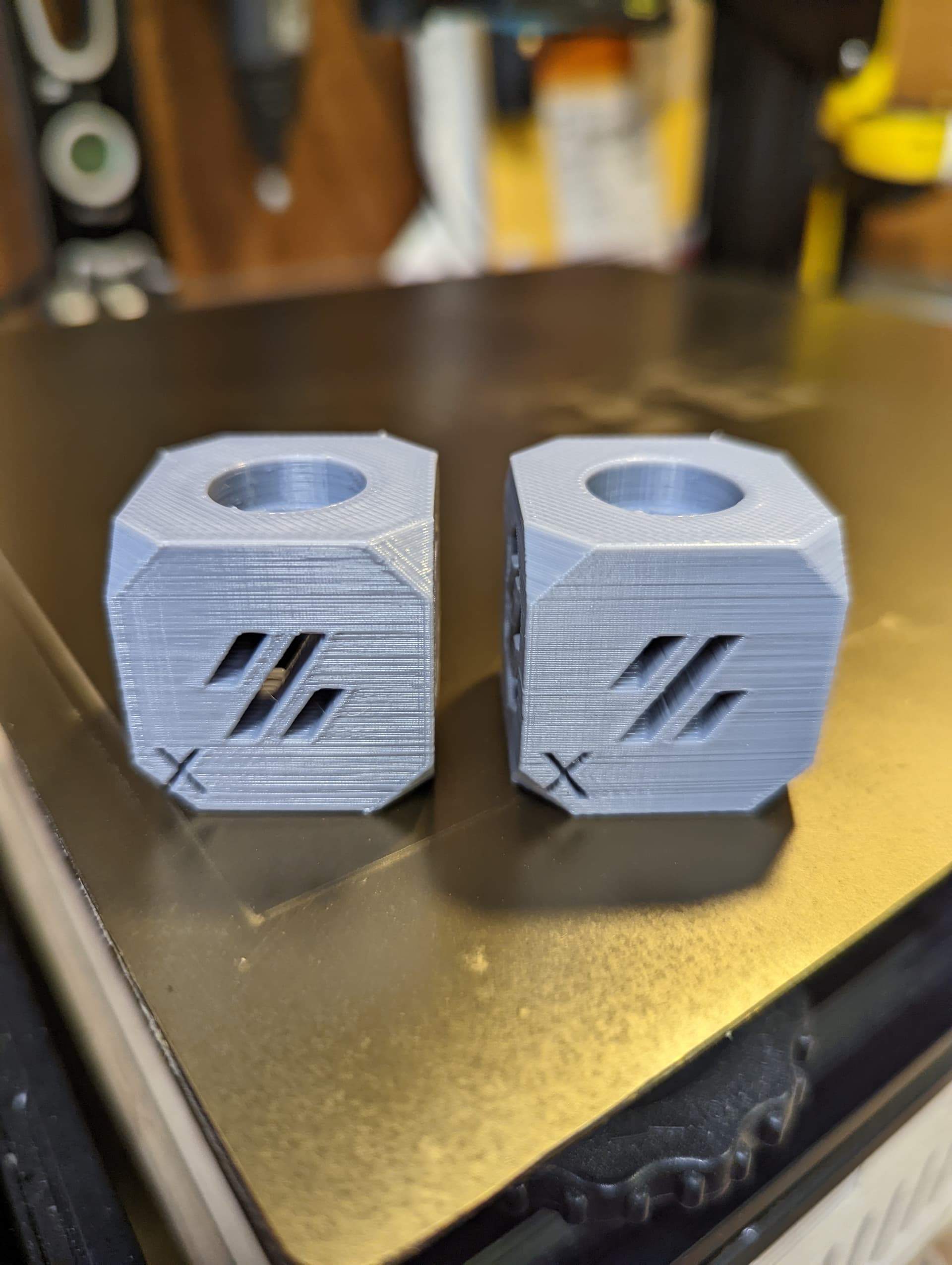

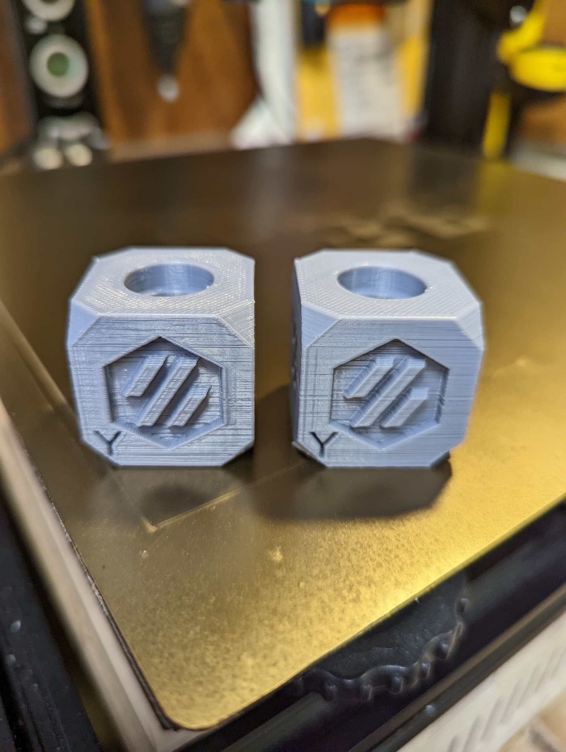

I printed the part in the X orientation and Y orientation and get the same results.
I’ve seen that when the heated bed springs are too loose, and allow the bed to wobble a little. It’s not an uncommon problem on a bed-flinger style printer.
Your tower test print looks pretty good. Was that with the same slicer?
The last prints were done in super slicer per suggestion from gpagnozzi.

If that were true, the total height would be smaller. Is it?
Its still dimensionally accurate.

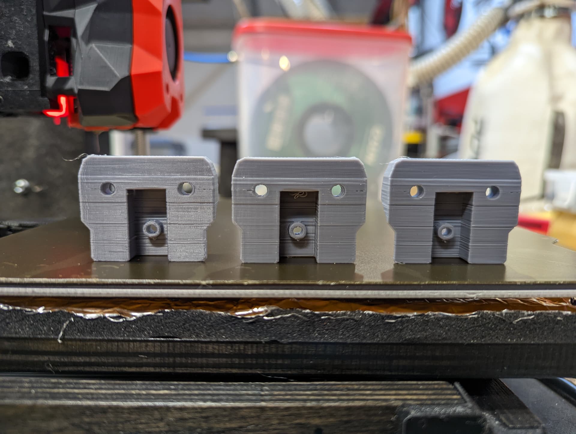

I changed the current to .800 —
Print to the left is with the increased current the two the right are the previous versions printed.
The bed springs are stiff - not super stiff not sure if this is the cause or maybe the lead screws.
The belts are super tight, the grub screws are tight on the steppers. I have a different lead screw coupler I am using -

Oh and I am not printing fast maybe 40mm/s

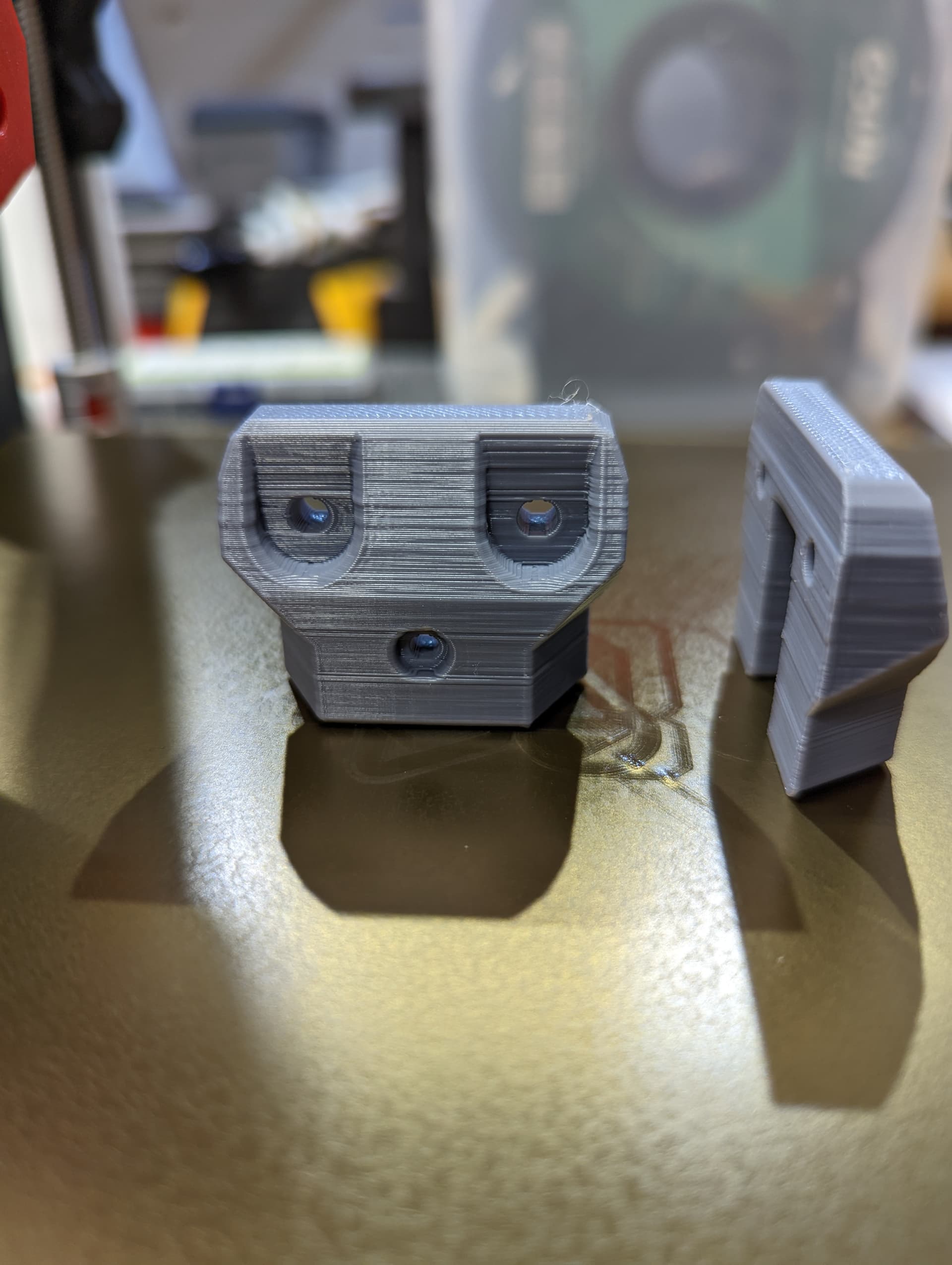

All I can see is three faces. :open_mouth: :open_mouth: :open_mouth:
It kind of looks like the later right above the eyes is thicker on both sides. If that’s true, then that layer is being squished. Not anything to do with X or Y, it has to be Z, right?
Something on the head is lifting or lowering, or something on the bed is lifting or lowering. I think you need to start poking at stuff and see if you can figure out what is moving.
Check the grub screws on those couplers.
Yeah - I will keep looking… like you say something has to be shifting.
What do you have as steps/mm for your Z. It looks fairly consistent, which leads me to think that it’s something systemic. What size nozzle is it, and what is your layer height? Try re-slicing the model for a different layer height?
If you are using 400 steps/mm for Z (Pretty typical) what Z speeds and acceleration do you have set? Z doesn’t need to be fast, but with good motor control it can still go reasonably quickly. For a 4 start (8mm lead) screw, layer heights in multiples of 0.4mm (0.16, 0.2, 0.24, 0.28) are all very good, as they are multiples of a full step on the motor, which makes them (usually) the most consistent. (But then, I use a 0.333mm layer most often, so take that with a grain of salt…)
120v bed? If so did you set the pid?
The bed does need freedom to expand a bit or it will buckle when heated worse that it already does. It seem like it is very close.
Are you sure your extruder is not moving? it looks like it is getting knocked a bit back and forth. Almost like a layer shift but less. If those are like 15% infill I have no idea how it is happening.
