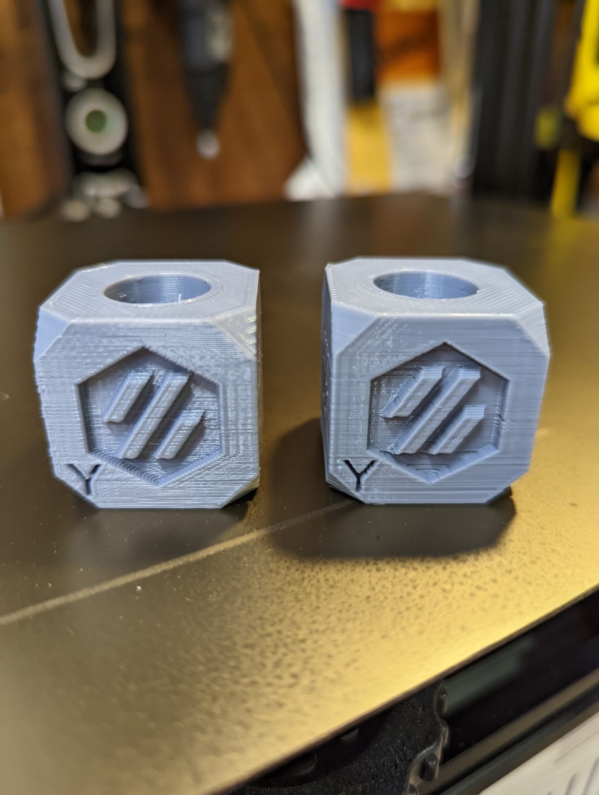

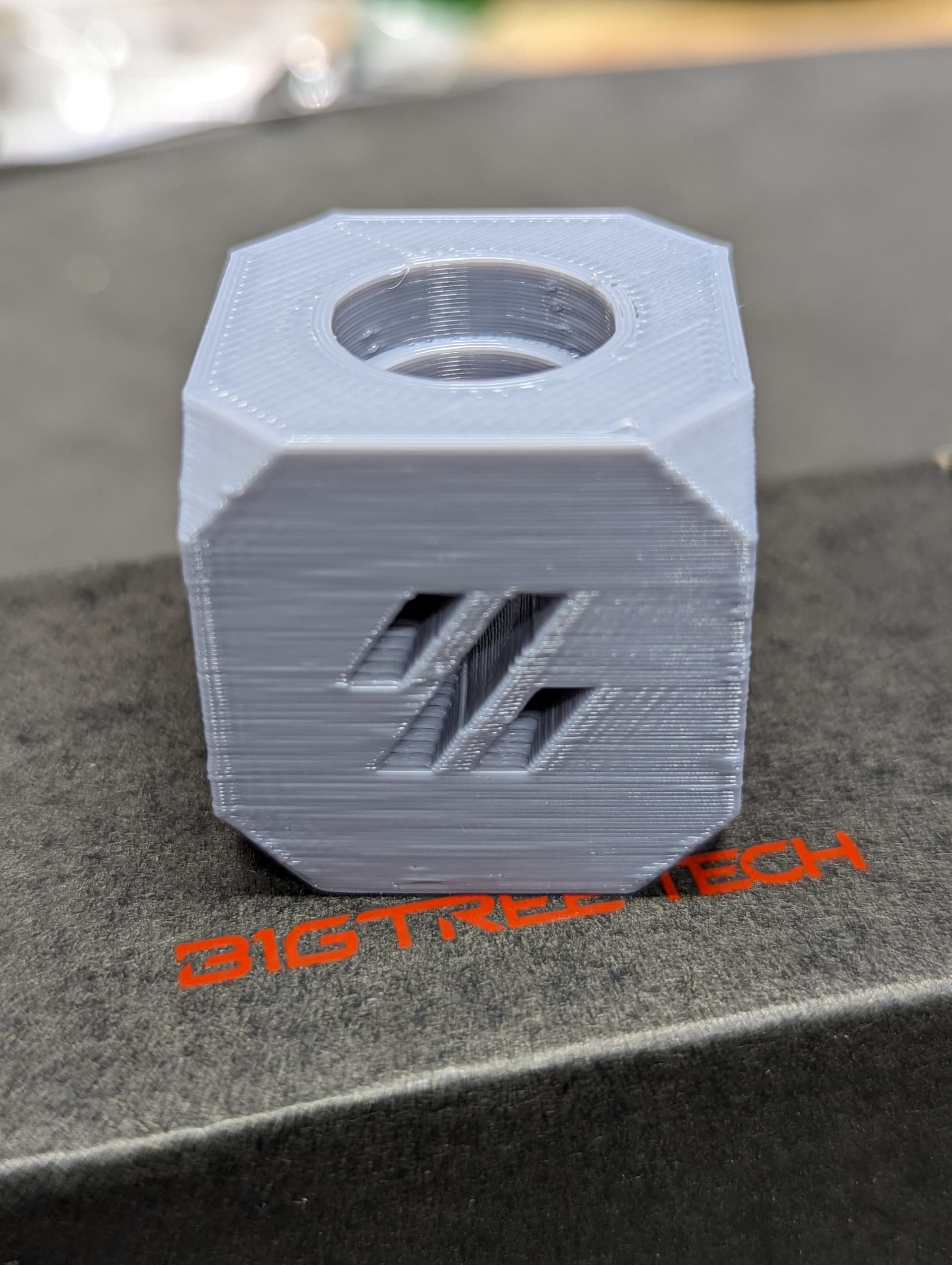

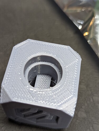

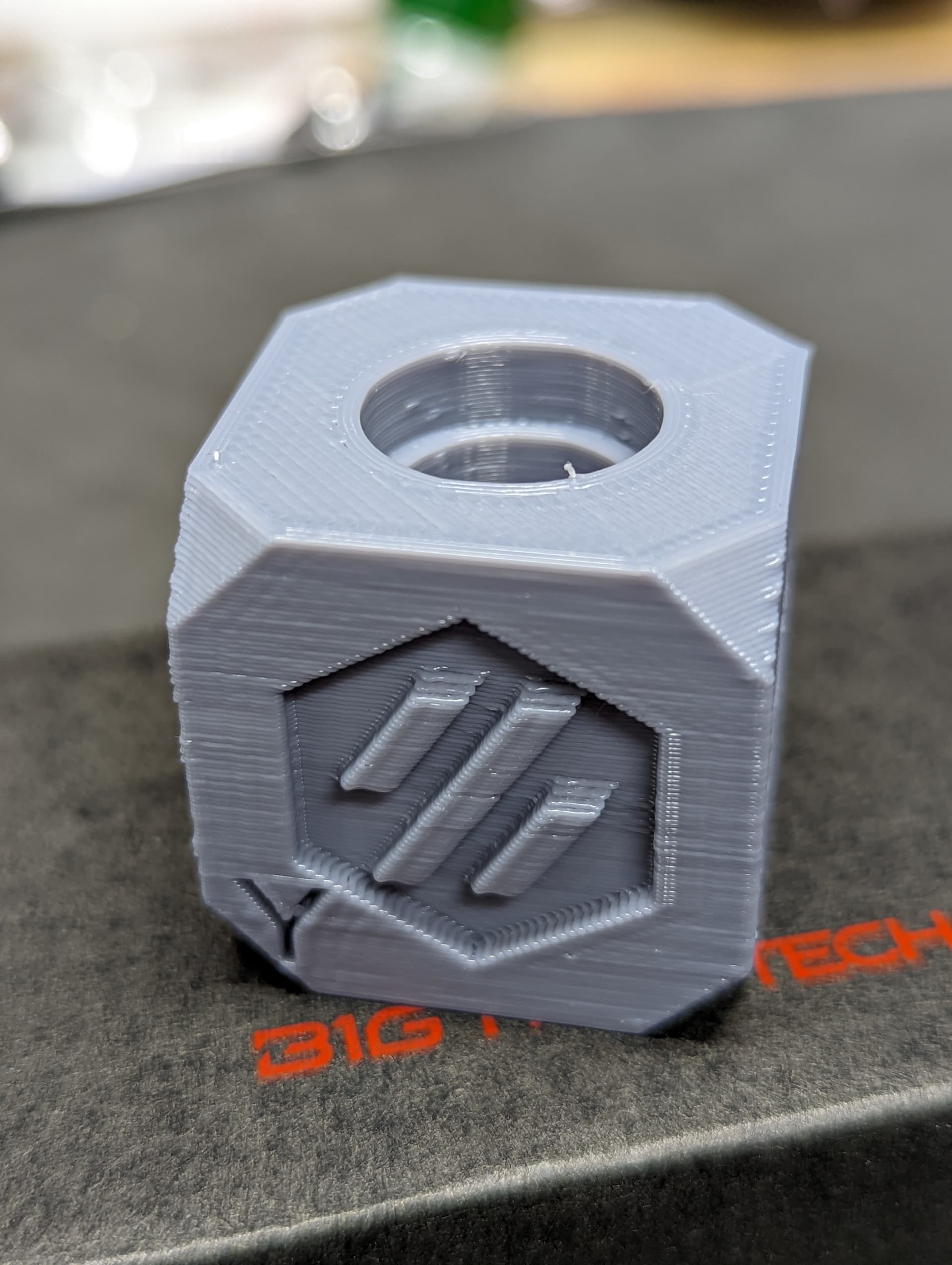

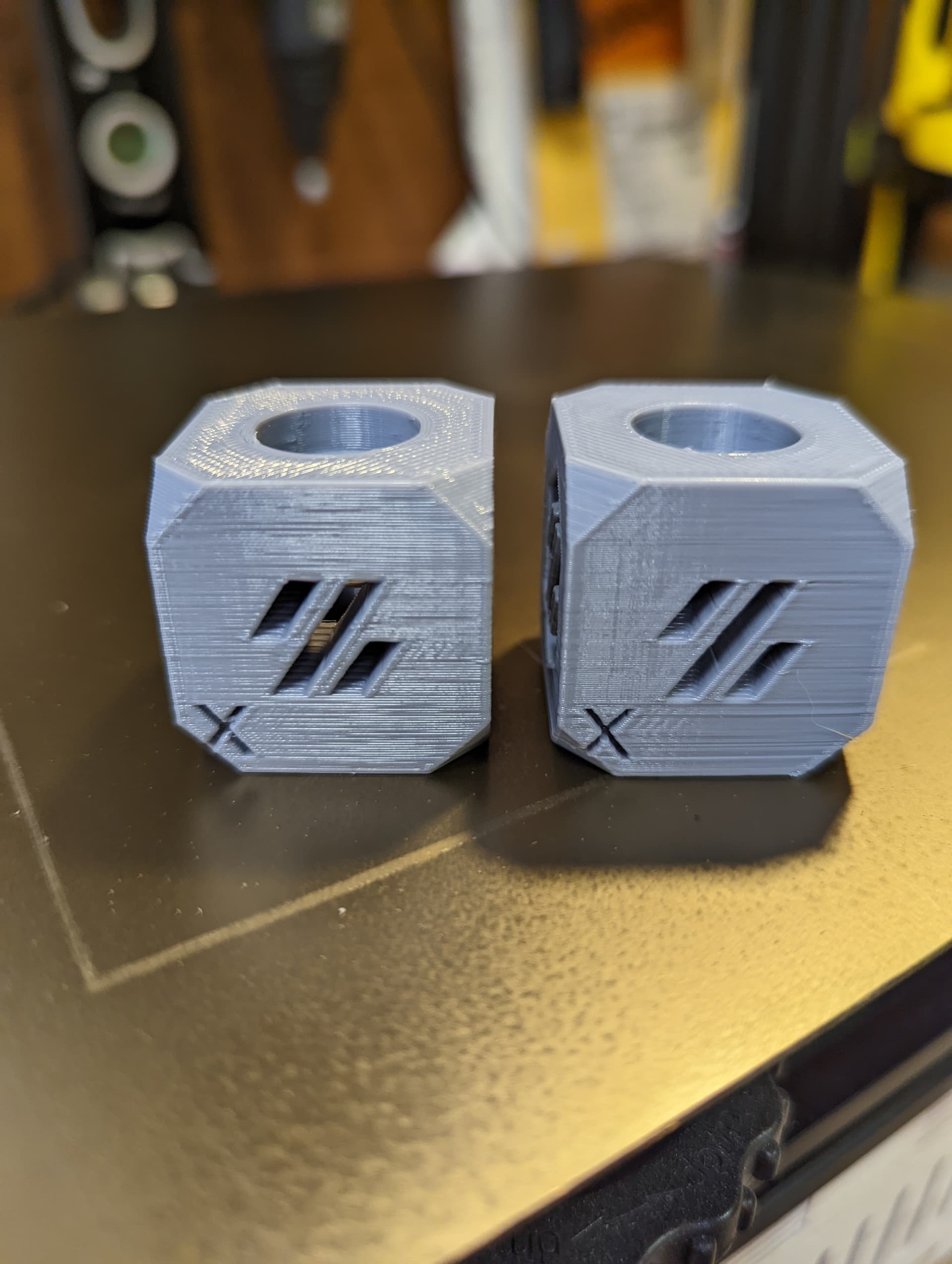

I have used super slicer and I am printing one of the voron cubes.
I tightened both the x and y belts and I still see the layers sort of shifted. Not as bad as the tuck body I was printing earlier.
I am wondering if this could be Z wobble or possibly there is some flex in the hotend?
I am using the Steathburner toolhead which I bought from a source on Etsy and its printed out of ASA and the hotend is the Phateus Dragon … so its bolted at the top with four screws so I wouldn’t think it would be moving but who knows…
I’ll post pics when the print is done.
Cube on Left was printed right when I got the printer running on Klipper with no resonance compensation.
Cube on the right is the one I just printed.
I think they both look very similar. These were not printed on the printer they are sitting on.
