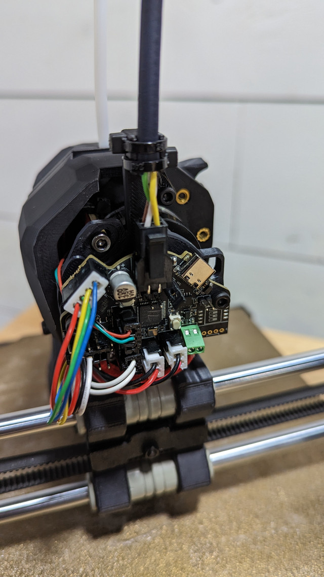

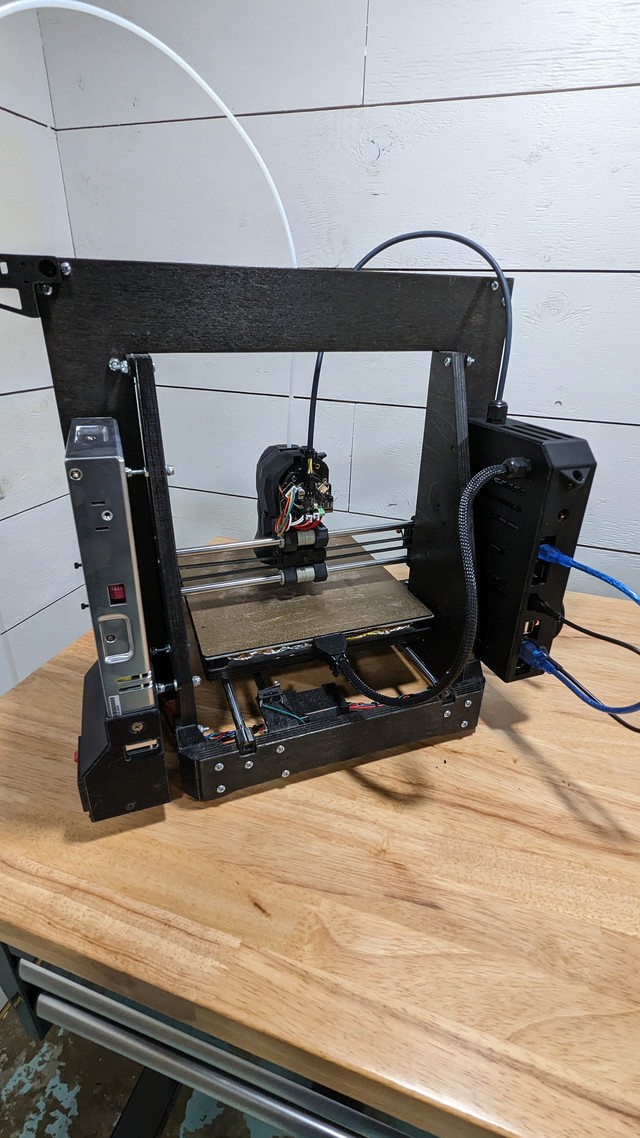

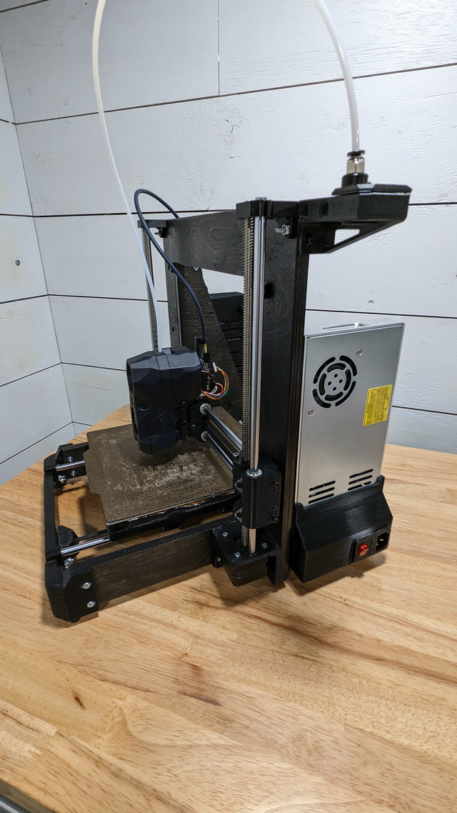

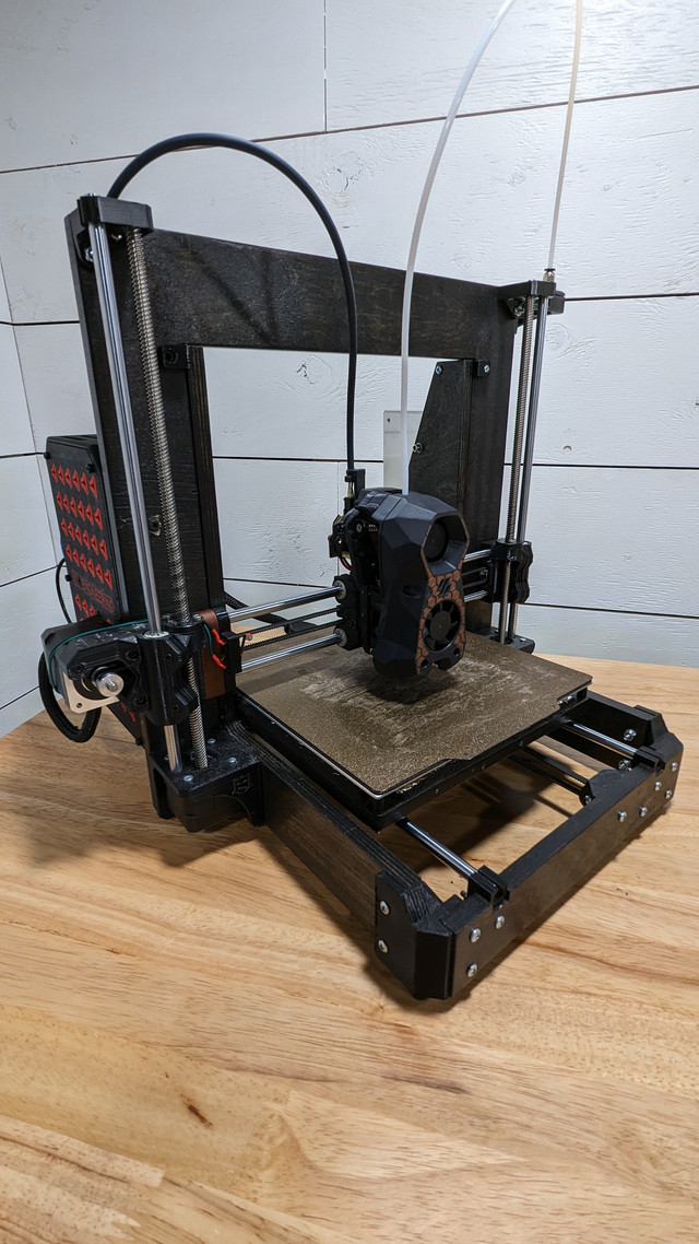

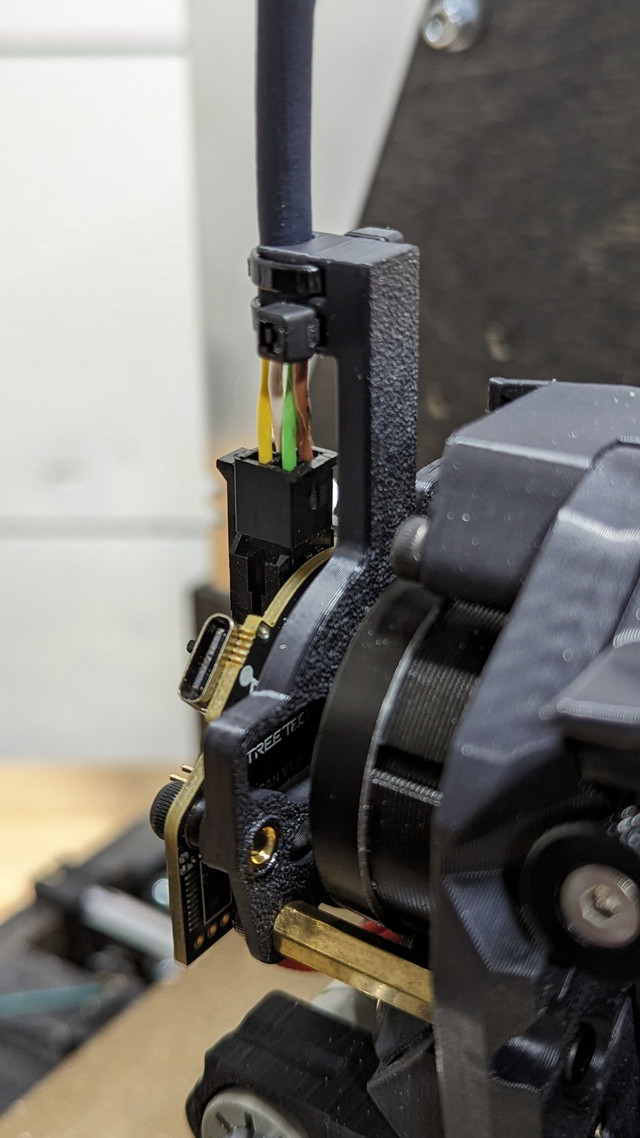

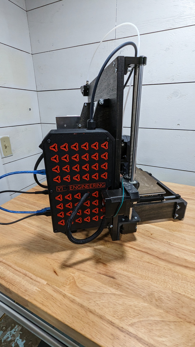

This is a way old post… that’s how long I had shelved the MP3DP v2…
I had started to scrap it… sold the Stealthburner and there it sat since last March.
I didn’t have the heart to throw it away so I rebuilt it.

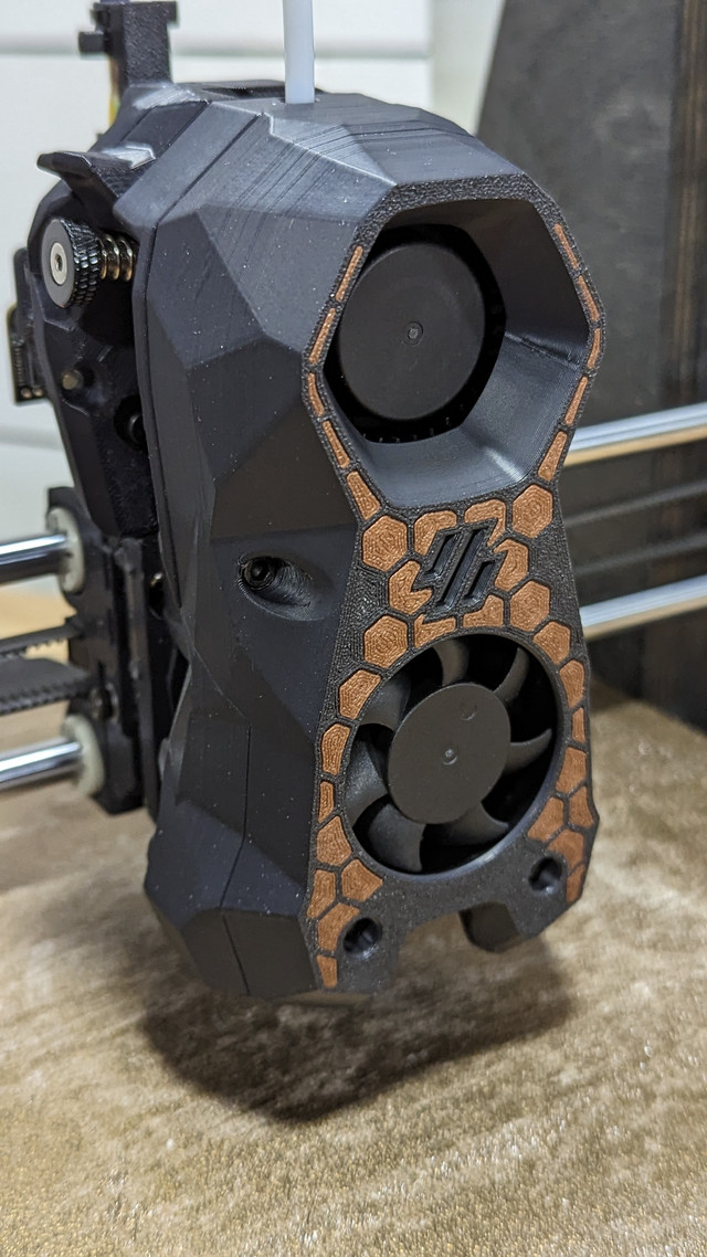

Added back the Stealthburner with a Bambu Labs hotend

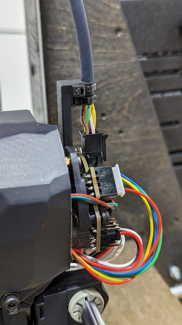

Modded the X carriage to utilize Voron Tap
Added BTT EBB36 and U2C for Canbus Toolhead
Played around in Fusion a bit to mod a case to hold the SKR Mini E3V3, Buck Converter, U2C and the Raspberry Pi since I am running Klipper.
Here are some test prints off of it.
