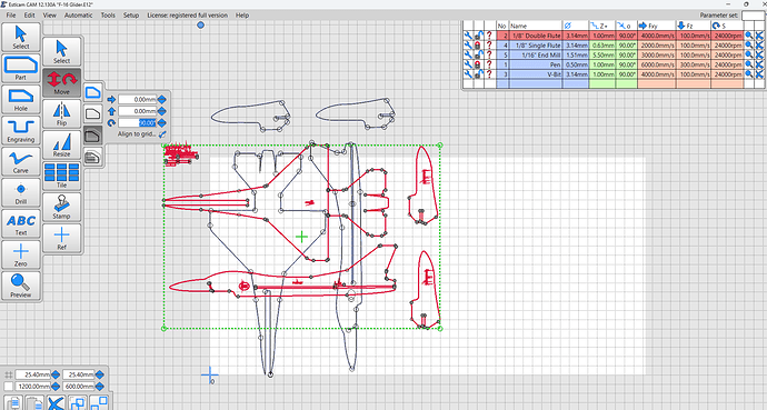

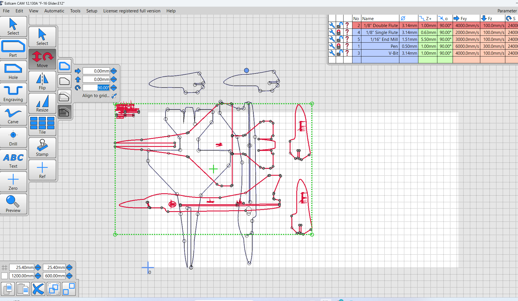

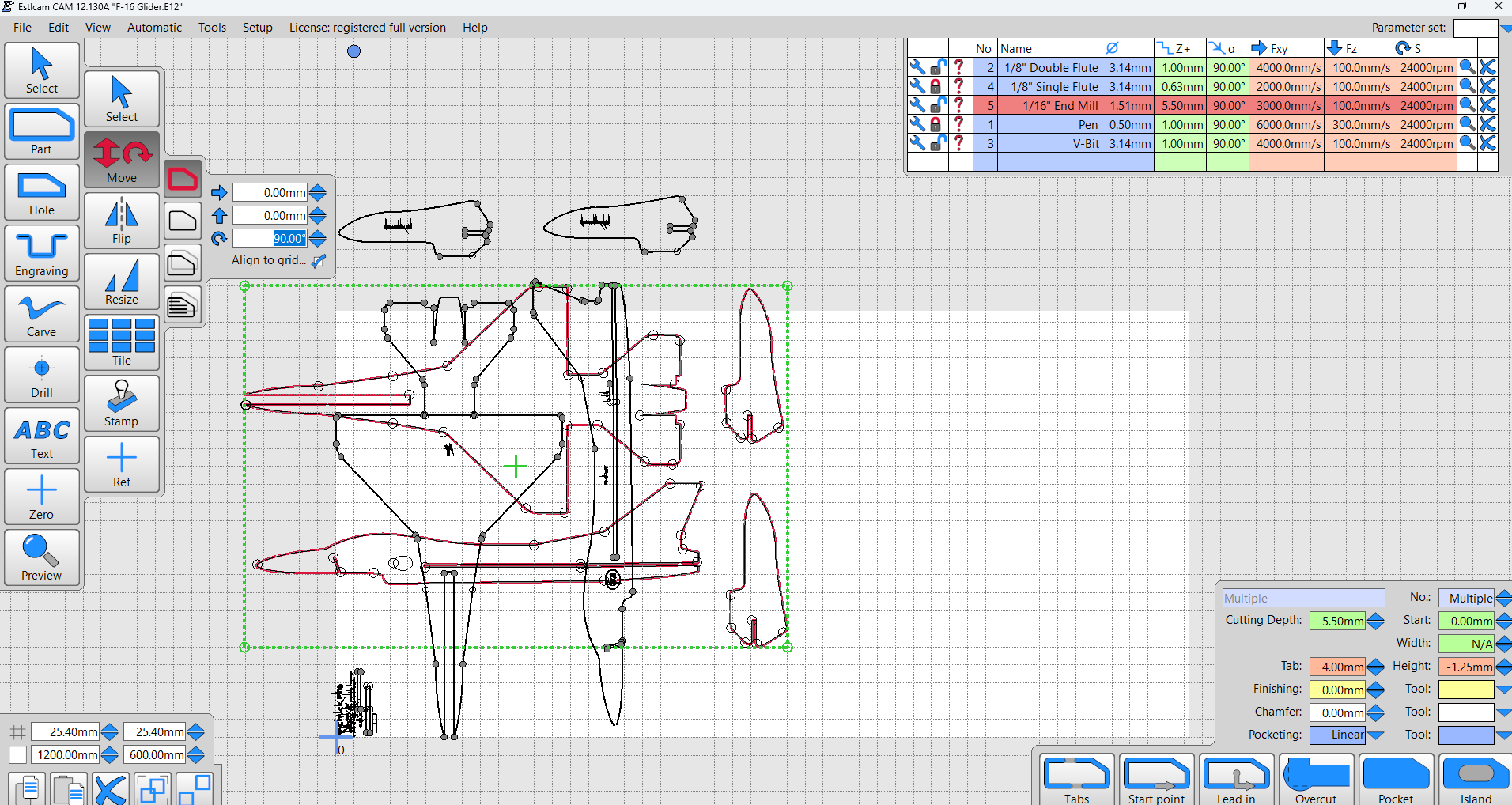

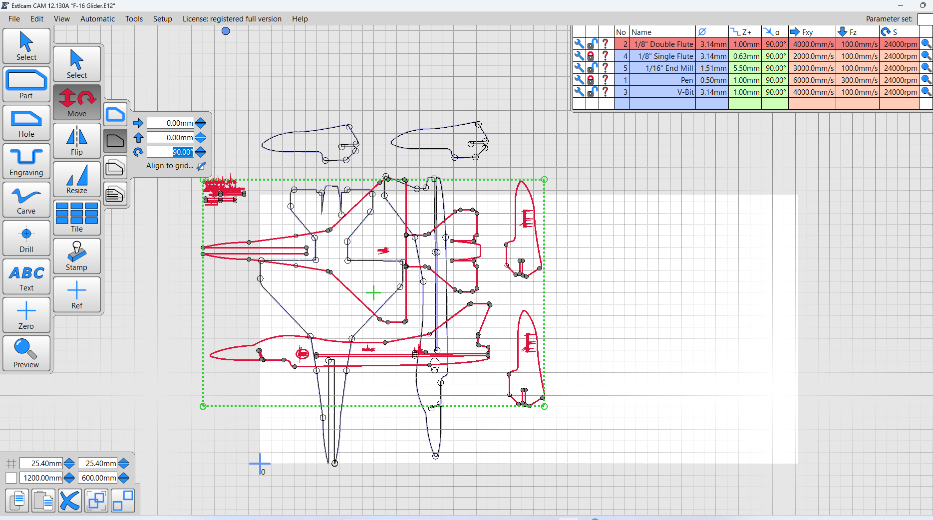

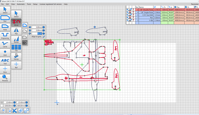

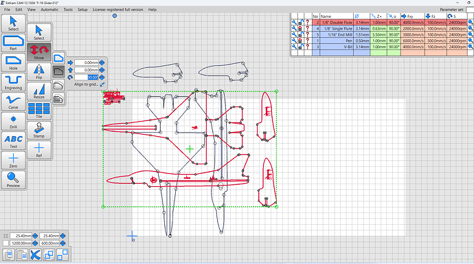

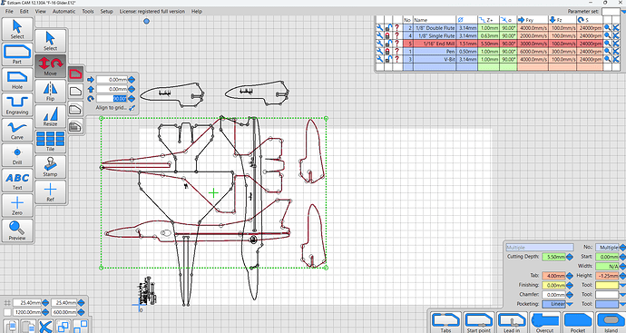

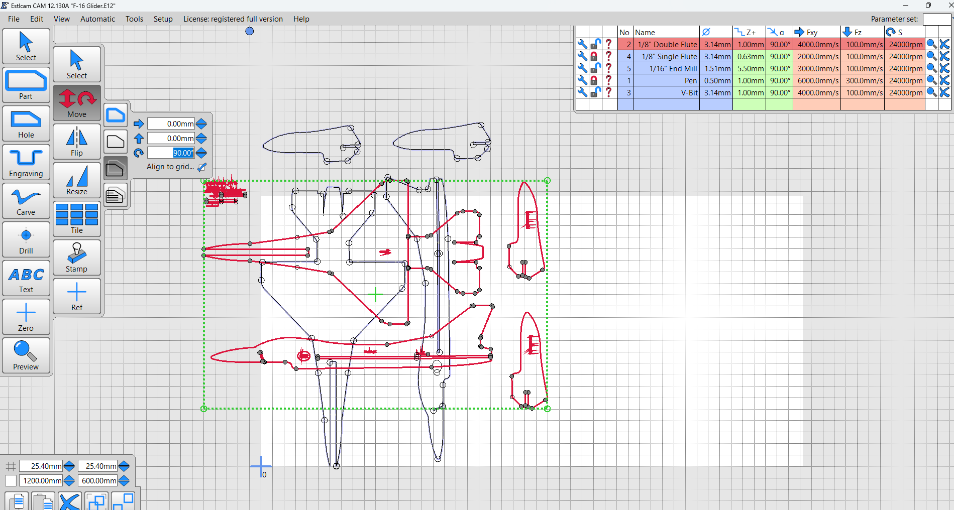

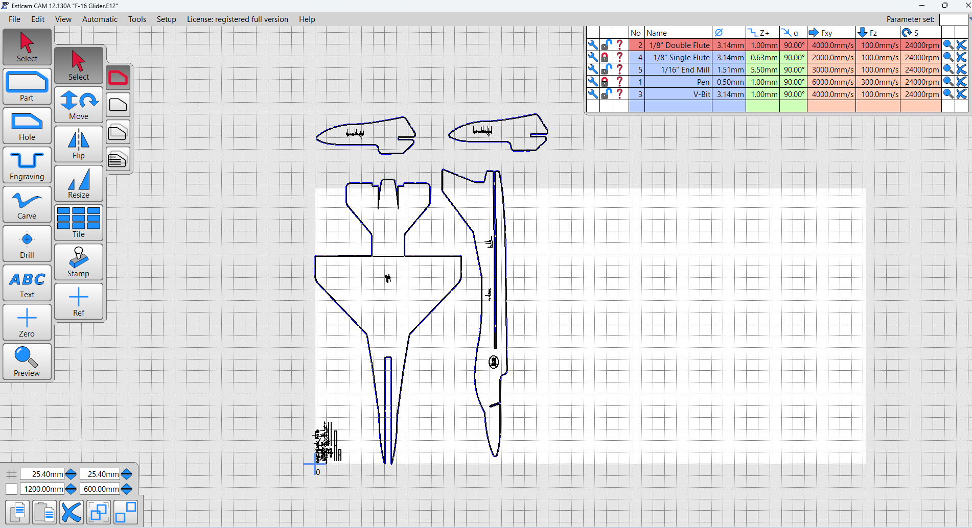

Im haveing trouble with ETSLCAM. I changed the size of my lwr v4 and need to rotate the drawing and the tool paths to fit my new work space. I need to rotate it 90 deg. but i cant seam to move the drawing layer and the tool paths all at the same time. so they all match and are to scale. right now no matter what select option i chose it does only one at a time.here are pic of what im talking about.

Ctrl + A keys to select all paths
Click the bottom of the four small icons (Drawing)
Hold Shift key and click on a drawing object to add the drawing to the selection
Click the Rotate icon…
Ctrl + A keys
Shift + D(rawing) or F(ile) keys + click
left-click and drag
Shift + right-click and drag
no matter what i try i can only move the drwinging layer. then i have to move the toolpaths seperatly and try to align them up.
Are you saying that none of the three (edited) methods turn all paths and drawing objects red (selected and ready to Rotate)?
i finally figured it out sorry thank you

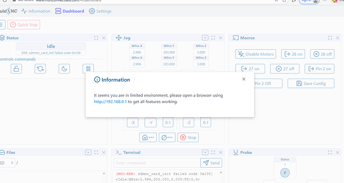

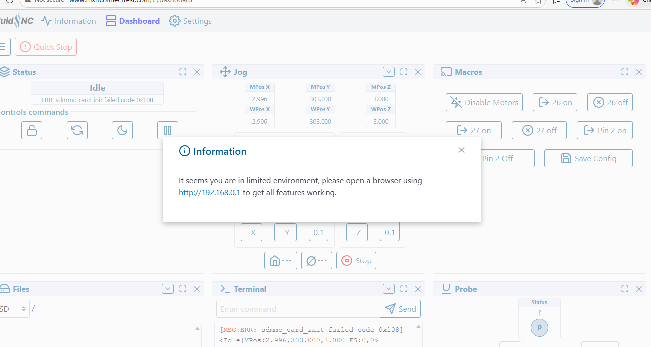

i have a new problem if i need to start another topic let me know. it gives me this msg evry time i connect and when it opens a window.I only get about 5 to 10 min with it before i get red msg that says my time has ran out and kicks me of. I then have to reconect. sorry for all the trouble.
That is exactly what it should do. Click the link in on that message and it will open another browser window. The captive portal that you are in there is limited and doesn’t function correctly, that’s why they put that message.
i do click that link and it works but after about 5 to 10 min it gives me red box. then i get disconected and have to connect back to the machines wifi. not sure why it keeps disconecting me.
