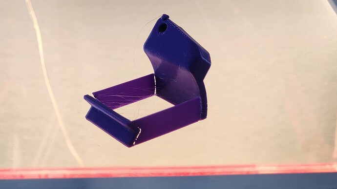

I have not saved these in printing orientation so the bendy arms should touch the table.
Well that don’t look right. :rofl:
Yeah with a one wall arm you need to mess with slicer settings to get that right, it will work though.
But that is more for a pen, if you are suing a drag knife 2 walls is probably better.

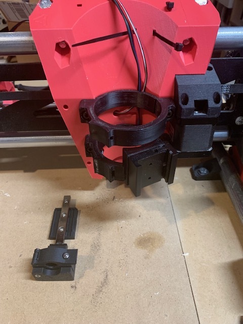

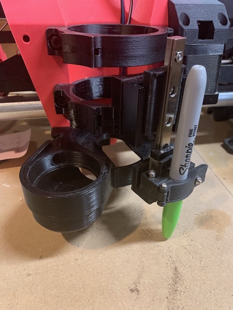

I am in contention for the slowest LR3 build ever, but have been working on a provision for a pen / drag knife along the way. The concept I am moving forward with was to integrate a feature in the router clamp that I attached a Neje laser mount (A40640) clamp to and then built a pen/knife attachment that could easily be installed into that laser mount.

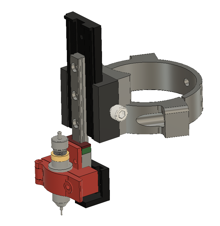

Independent of how it is attached, I am trialing a design built around an 100mm long MGN9C linear rail. It has a spring loaded clamp for the tool and a light pressure spring to give a some resistance to the vertical float beyond its own weight.

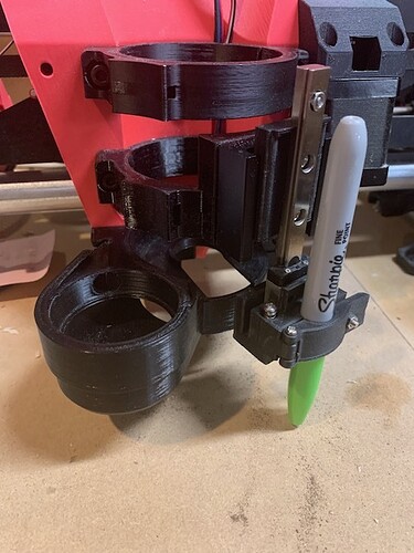

I have finally established motion with my LR3 (after starting about a year ago) and made a test crown with a Sharpie a couple of days ago. It worked well enough that I’m going to call it good enough for me.
I can share the design if anyone is interested - the only real downside was the $17 rail, but that’s still $$$ less than my wife’s Cricut and my workspace is easily 50x bigger, so I coughed it up.
Absolutely!

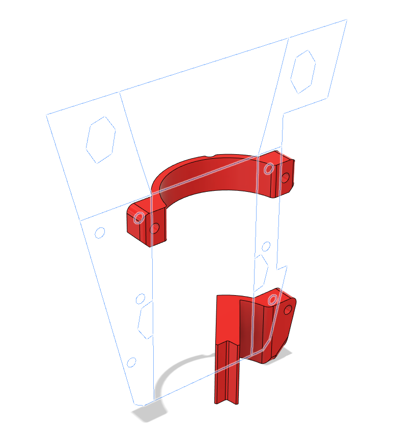

Okay, lets start with a couple pictures. If I figure out how to upload it somewhere I’m sure someone can refine it:
Lots of black parts though, so here is the cad model:
There is a feature in the mount to lock the drag knife from sliding up in the mount.
I didn’t buy any springs - I just used what I had laying around. There is a screw running through each so the pre-load can be adjusted.

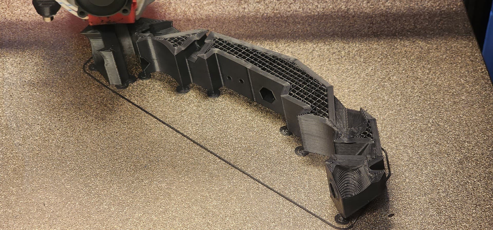

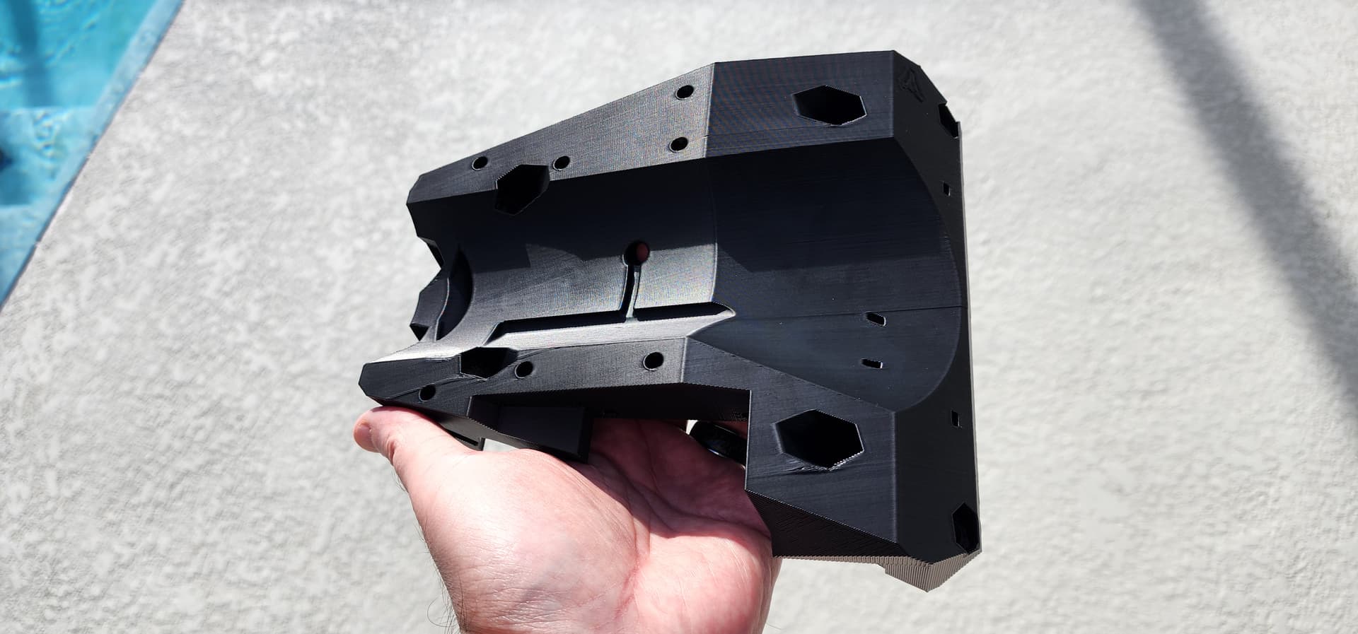

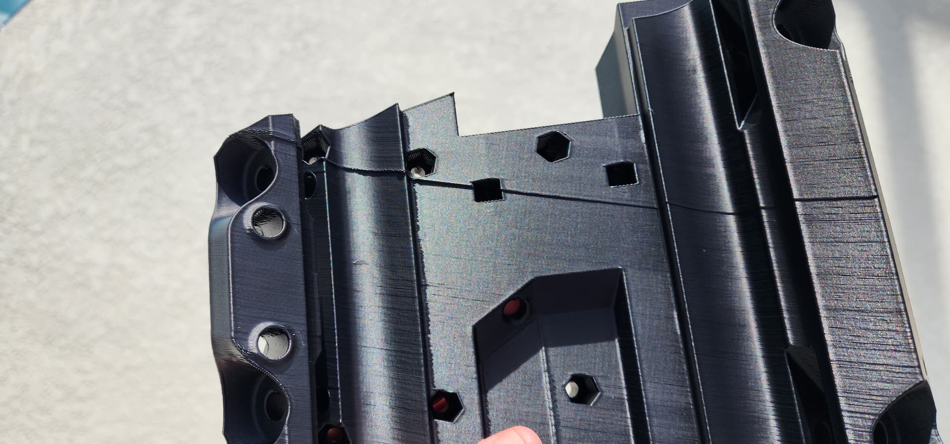

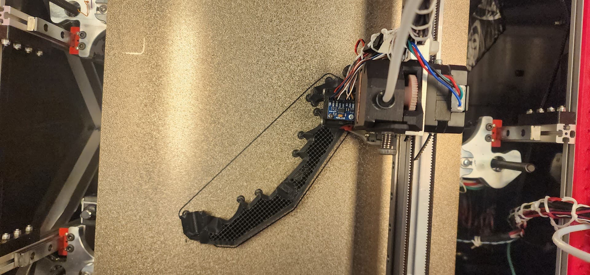

Nice! I’m having to reprint the core because I spun one of the nuts that holds the bottom dust shoe in place.
Testing it in HIPS because I’m out of PLA and am impatient. :rofl:
Something, something thick stacks.
Ehh, I think it’s okay. I don’t think it’s a layer shift, it doesn’t go all the way through.
I think it will be fine!

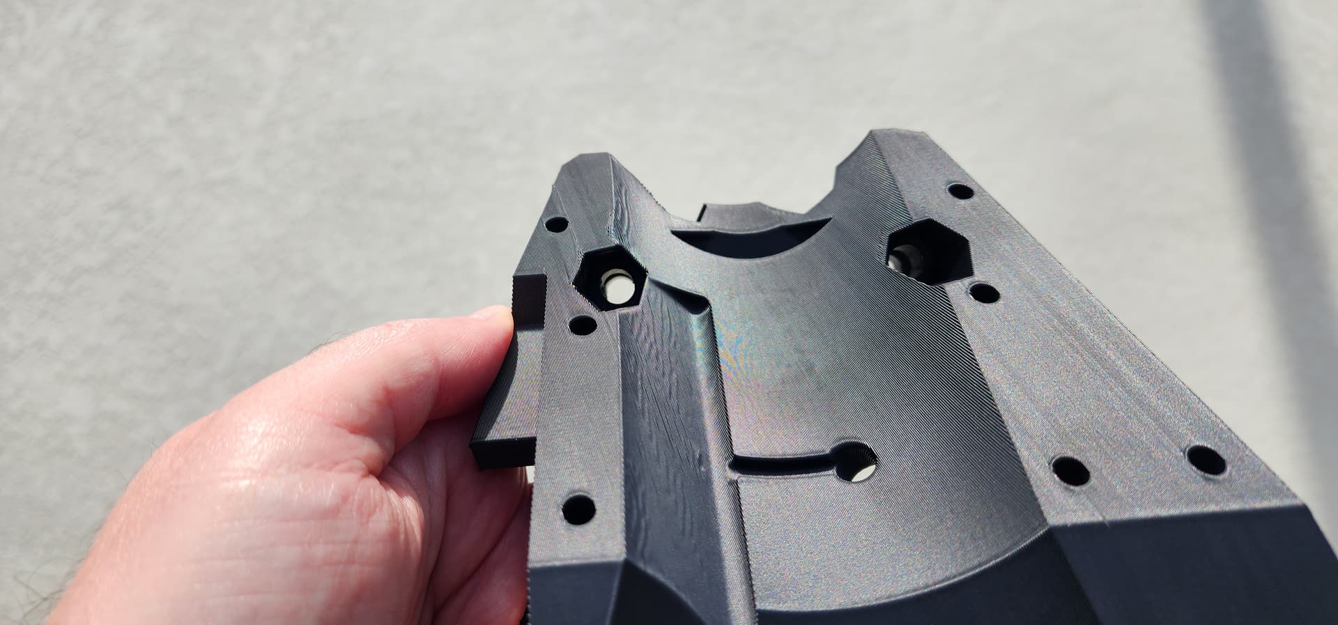

welp, new drag knife mount kinda works? I think my issue is the blade rotation. I guess what I’m trying to cut is too fine and the difference between where the last cut stops, and the next starts can overlap.
Also took this thing apart and put it back together about 5 times this morning. :rofl:
