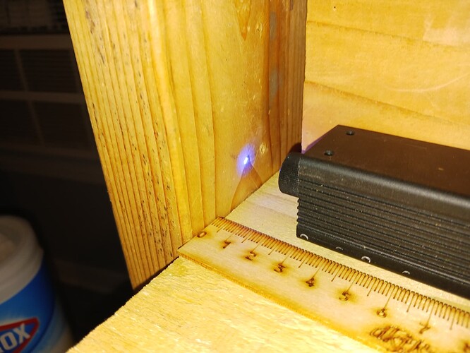

Something that you might check and think about…
I often check out a laser before mounting it on the machine. I set up a few scraps of wood and a ruler and then simply slide the laser back and forth, along a straight edge, to get a sense of where best focus might be set… and also see the spot geometry and orientation. I also use this setup to pre-adjust the focal distance to a convenient gauge-block value… say 50mm, bottom of housing to surface of material.
Here, too close…
about right…
and too far…
Clearly, the rectangular shape of the “spot” is seen in these last photos… and maybe, a bit surprisingly on this module, the die seems to be set on a diagonal to the actual X/Y orientation of our machine. It’s common to hear of people complaining that their laser cuts/engraves better in one direction than the other… and it’s easy to see how that could happen if the long dimension of the “spot” aligns with one axis or the other.
OTOH, in our case, maybe it would be advantageous to mount and align the long dimension of the “spot” with the direction of scan and then use “dot correction” to effectively “shorten” that “spot” dimension… and leaving the short dimension of the spot to determine the shortest line interval (best resolution) in the other axis?

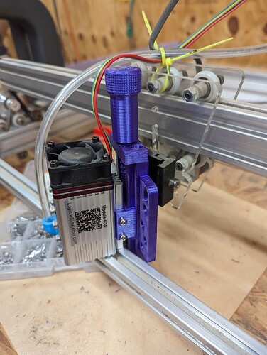

I don’t remember which thread had the fancy z height adjustment build info, but I wanted to thank you for the design.
I finally got around to printing it today. I don’t have it fully installed, but I did play with it some. I’m at the point where I have to completely disassemble my gantry to install it, but had to go inside to help get the kids ready for bed.
Well, thank you… but I’m sorry about you needing to dismantle the carriage to install it. I put so many mounting holes on that backplate to accommodate different machines… I guess I missed yours.
Actually, I later settled on a completely different Z-lift design that is a lot simpler… and uses that Neje mounting clamp for a sturdier hold. I designed it specifically for the $79 Amazon machine so the hole pattern would need to be altered for your machine… should you want to adapt it to your machine.
I like that purple filament BTW…
