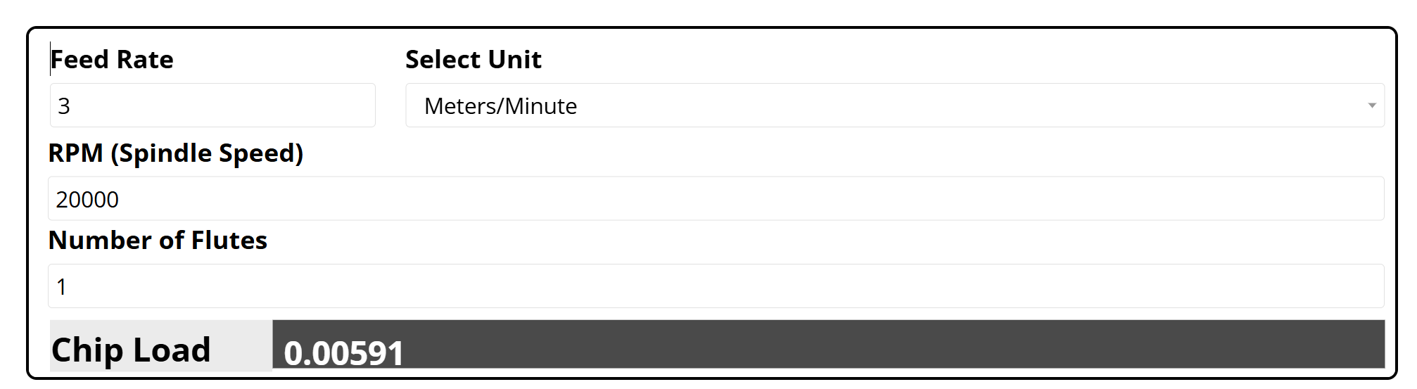

So as an update it seems it was the bit that was dead. The tip was bownish/rusty color so didnt look good. So when the bit is effed? why it causes the cnc to loose steps? its because it grips too much in the wood so does a lot of resistance?
Now that you say it it seems in my cuts mostly dust is produced. Its not like solid chips. Even if I used the chipload calculation I was suggested in another post. Im runing witha single flute 1/8 straight upcut endmill and i set the rpm to aprox 22000rpm

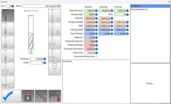

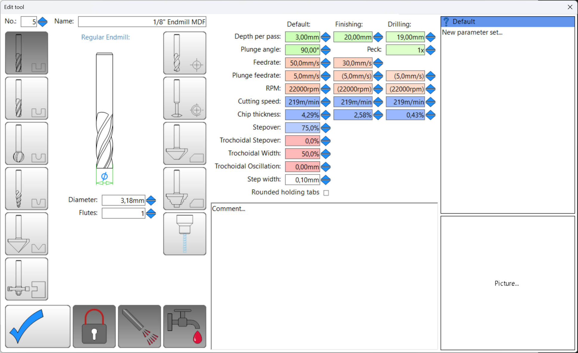

These are the settings

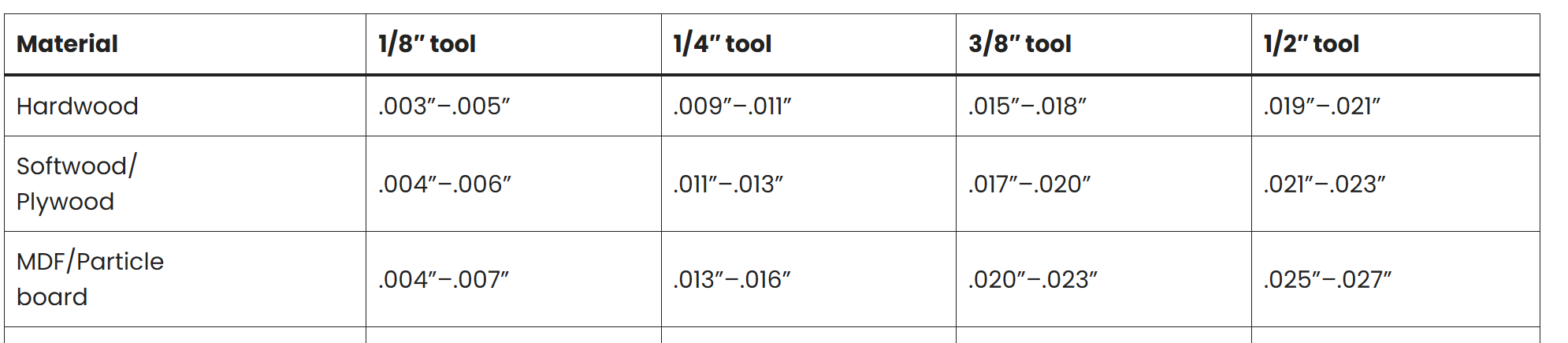

With this and if i made the calculations correctly chip load should be in the good range for MDF
I can try reduce a bit the router rpm cause speed 4 in the makita is 22K rpm and I made this calculation with 20K
For an 1/8" single flute endmill I would be running the router from 1-3max, 12-40mm/s, 3-6mm deep.
Pretty much the opposite. If the bit is travelling too slowly, or is spinning too quickly, it isn’t removing good size chips, it is “rubbing” against the material instead.
Chips remove the heat from the material, whereas rubbing just generates more heat. You can toast a bit within a couple of minutes by moving too slowly and not creating chips.

Note that the chip load settings in that table are in inches/tooth. Your feedrate is in mm/min.
Selecting MDF 0.004-0.007, let’s pick 0.005 as a mid range starting point.
0.005 in/tooth x 25.4mm/in = .127 mm/tooth
As Ryan suggests, running the router in the lower range (15-20k max) is preferred
Plugging this into the Chip load calculations: CL = FR/(RPM * # of teeth) therefore FR = CL * (RPM * # of teeth)
FR = 0.127mm/tooth x 1 tooth/rev X 15000 rev/min = 1905 mm/min, or 32 mm/s. Using 20000 RPM, the FR would be 2540 mm/min (42 mm/s)

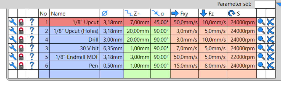

Now we are kinda getting piecemeal info. If you are burning through endmills and this is costing you money take a little break and give us all the details of your CAM. Exactly what endmills are you using? What router?
Click the wrench icon and show us, screenshot, all the details for your feeds and speeds for each tool you are using.

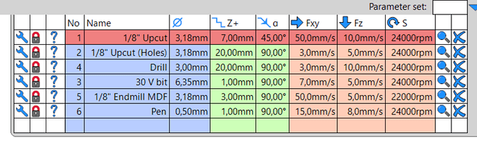

My tool configuration is this but really i only use the number 5 for all the project
The CAM has holes that are supposed to be 2mm in diameter but I use the 1/8 endmill anyway cause I figured out it will work as well that diameter of hole and this way I didnt have to change the tool
To reduce the heating on the bit youll notice I made the endmill just to drill up to 12mm or so from the total 19 of the board. My plan was to finish the holes by hand with an actual drill
So Z step is 3mm (same as the tool diameter), feedrate was 50mm/s, plunge speed is 5mm/s
The reason I didnt wanted to use a drill bit is because I had no idea how to configure it for the router (no idea whats a good rpm value then or plunge speed etc) and I never tested the tool change sequence neither.But thats on me reallyWith this sheet everything went more or less fine until it got to start cutting the first big squarish piece from the left. So prior to that had already made all drills (normal and helical), cut all the holes, cut the 5 smaller pieces on the right of the sheet.

lets run through your settings. I am going to say this as if you are using an upcut, if you try a downcut start with all values halved.
Slow down your plunge a little. ~8mm/s
Default column.
try 20-30 mm/s feedrate
stepover never more than 45% - I like 35-40.
Finishing
20-30mm/s with a 10%D pass so 0.3mm finishing pass.
Drilling…
3mm depth, this will force peck drilling. you can go a little more after you prove this works.
plunge 3-6mm/s
But i had a plunge rate of 5mm/s. Wouldnt 8 mm/s be faster?
Sorry plunge is listed in two places. You are at 5, that’s fine, the main one shows more.
These are values to get you started. Some of these values we go much must faster, but we need to figure out what is going on with yours first.
