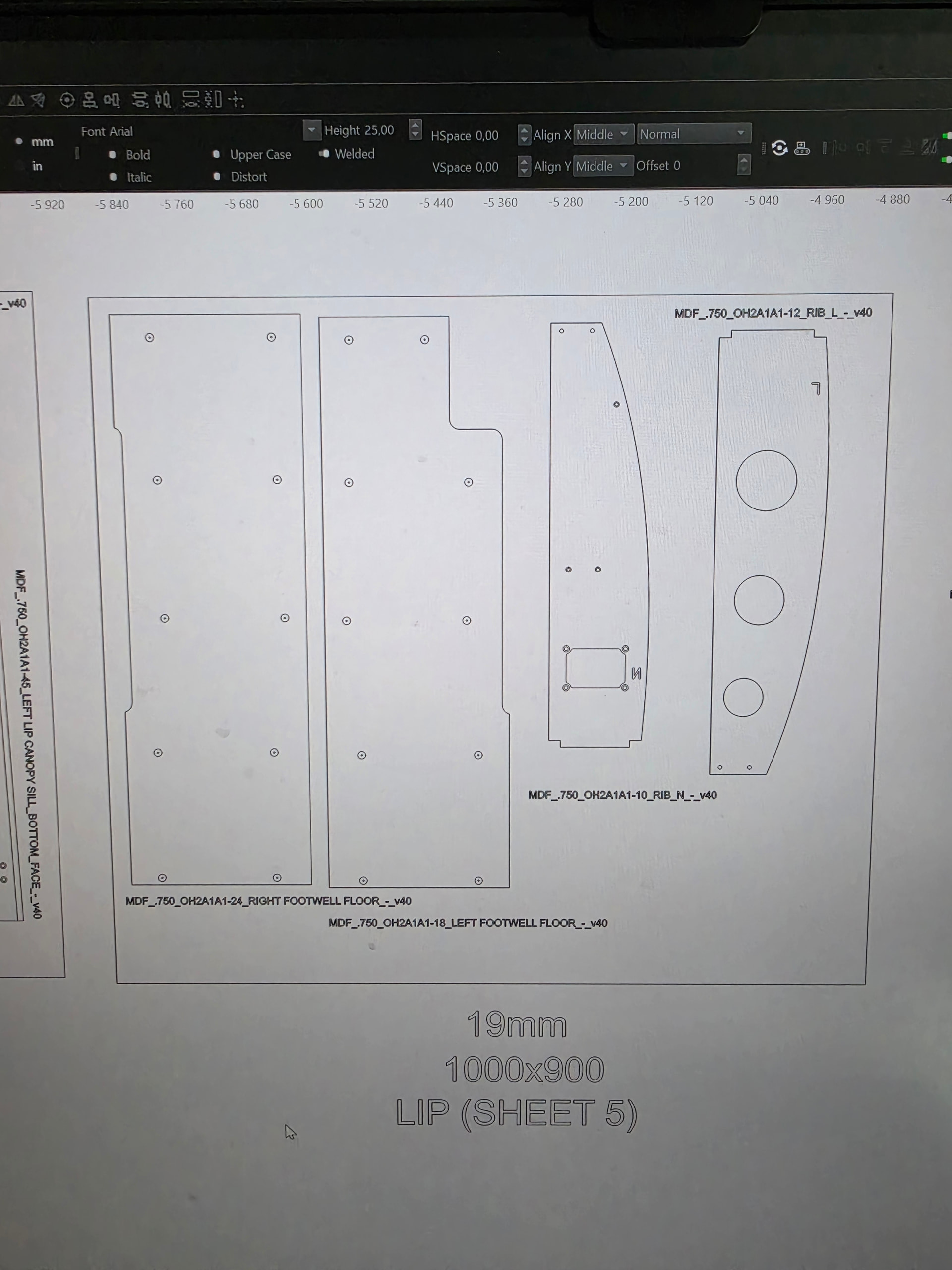

I must say Ive been cutting successfully with my cnc several sheets of MDF by now and Im amazed the amount of precision I can get with it. Its still dumbfounding to me!
Yesterday though was the first time the cnc did something strange and ruined some pieces and I have no idea what could have gone wrong.

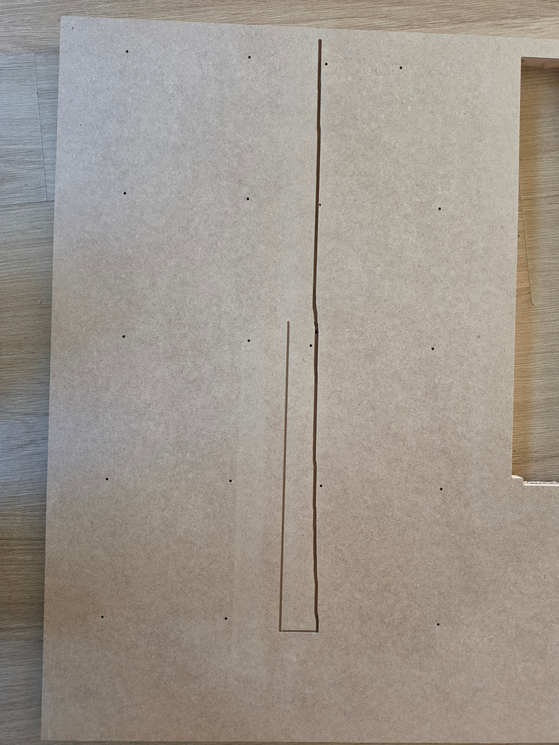

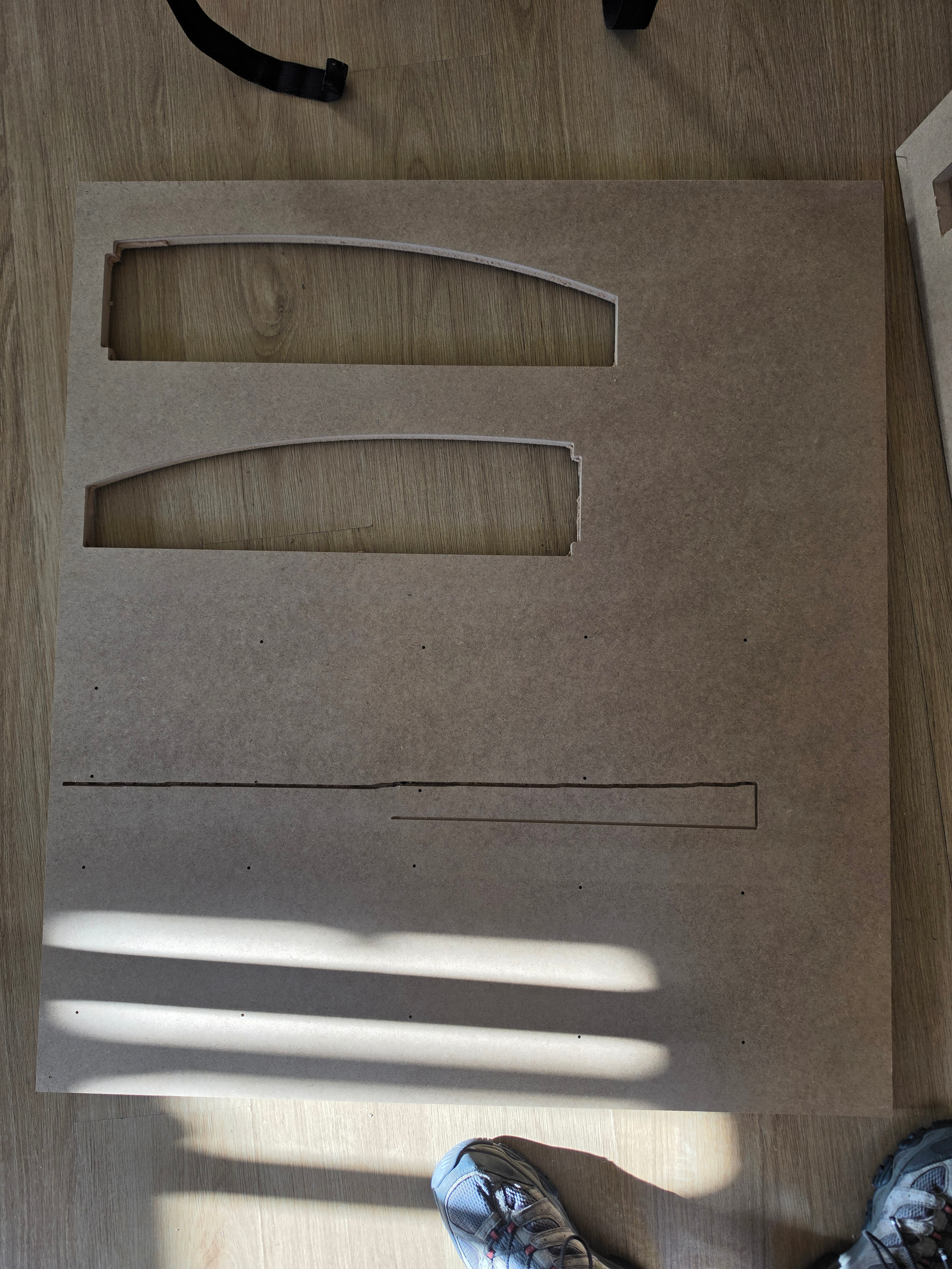

I was cutting the sheet I post , which actually is one if the simplest. The lr4 did all the holes right and cut the two rib pieces on the right correctly. But when it started with the big piece in the middle something happened. It didnt go the full width of the piece and all of a sudden is almost like movement in the X axis was non existing or it was struggling with it.
I turned off the machine and restarted it and jog it both in X and Y and seemed ok. So I dont understand what could have happened. Any ideas?

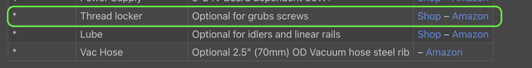

Part of the problem is that the instructions say these are optional for grub screws:
( @vicious1 - I’ve never liked that; I don’t think thread locker on grub screws is optional…)
I don’t actually use thread locker on mine, and the kits don’t include it. Back in the 3D printer days I remember robo having a hard time shipping thread locker, I would have to look into it again. Maybe LDO has some insight.

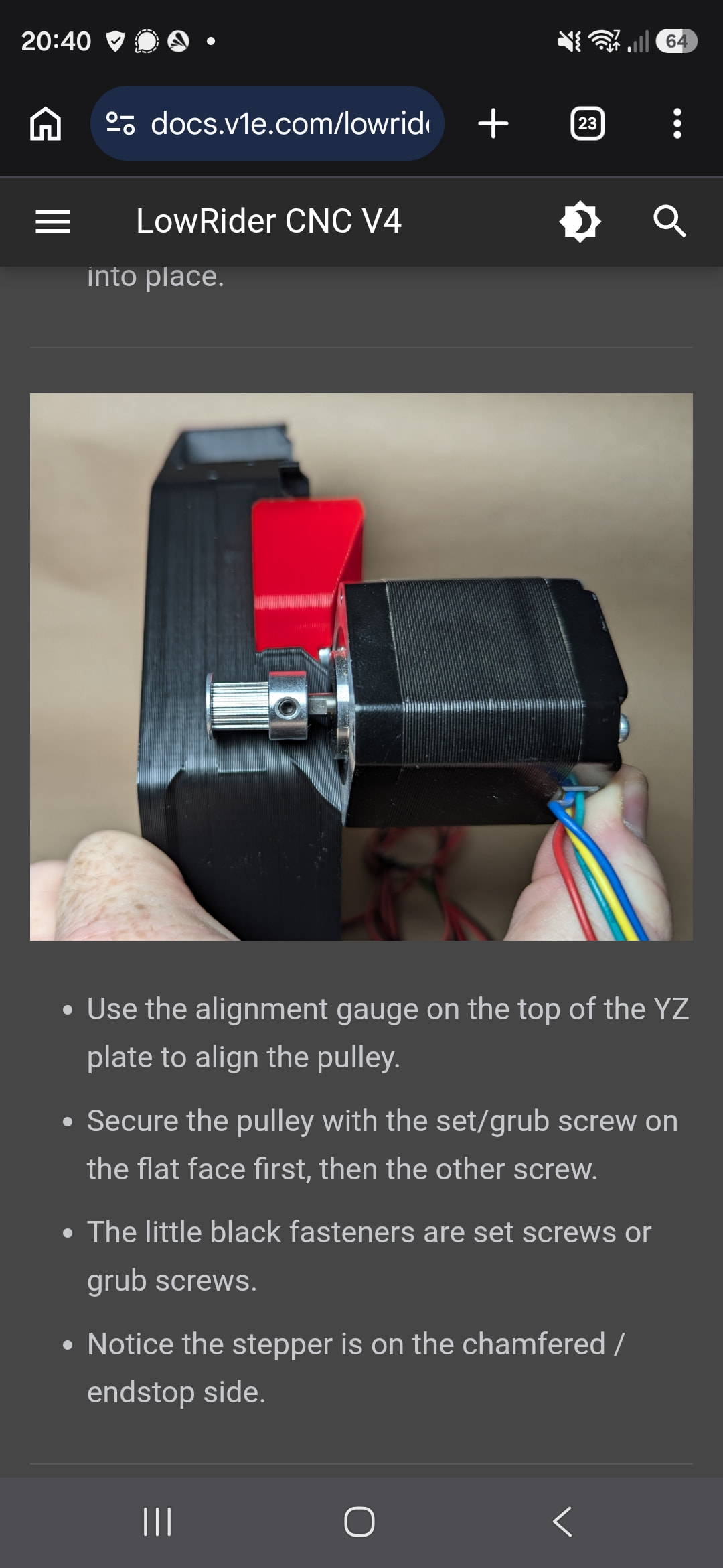

But maybe as I go through the instructions in the part where tells you to put the pulleys in the steppers and make sure one of the grub screws is facing the flat part, having an image applying the threadlocker and saying: if you have any available now its a good moment to apply threadlocker on the screw. Will avoid it later becoming loose and the pulley sliding on the axle. Like at this point:
Think this at least makee me aware of a problem that could happen and how to solve it

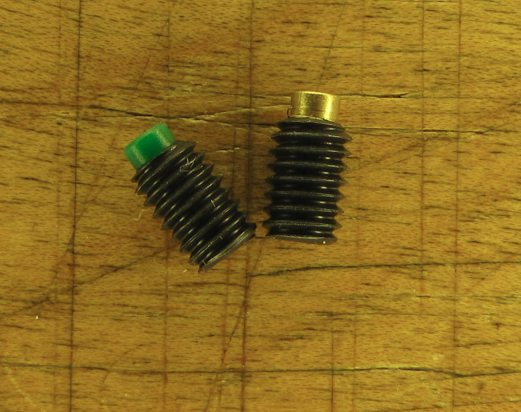

I’ve been using these for many years .
Nylon tip on the left, brass on the right. Got them at McMaster-Carr.
