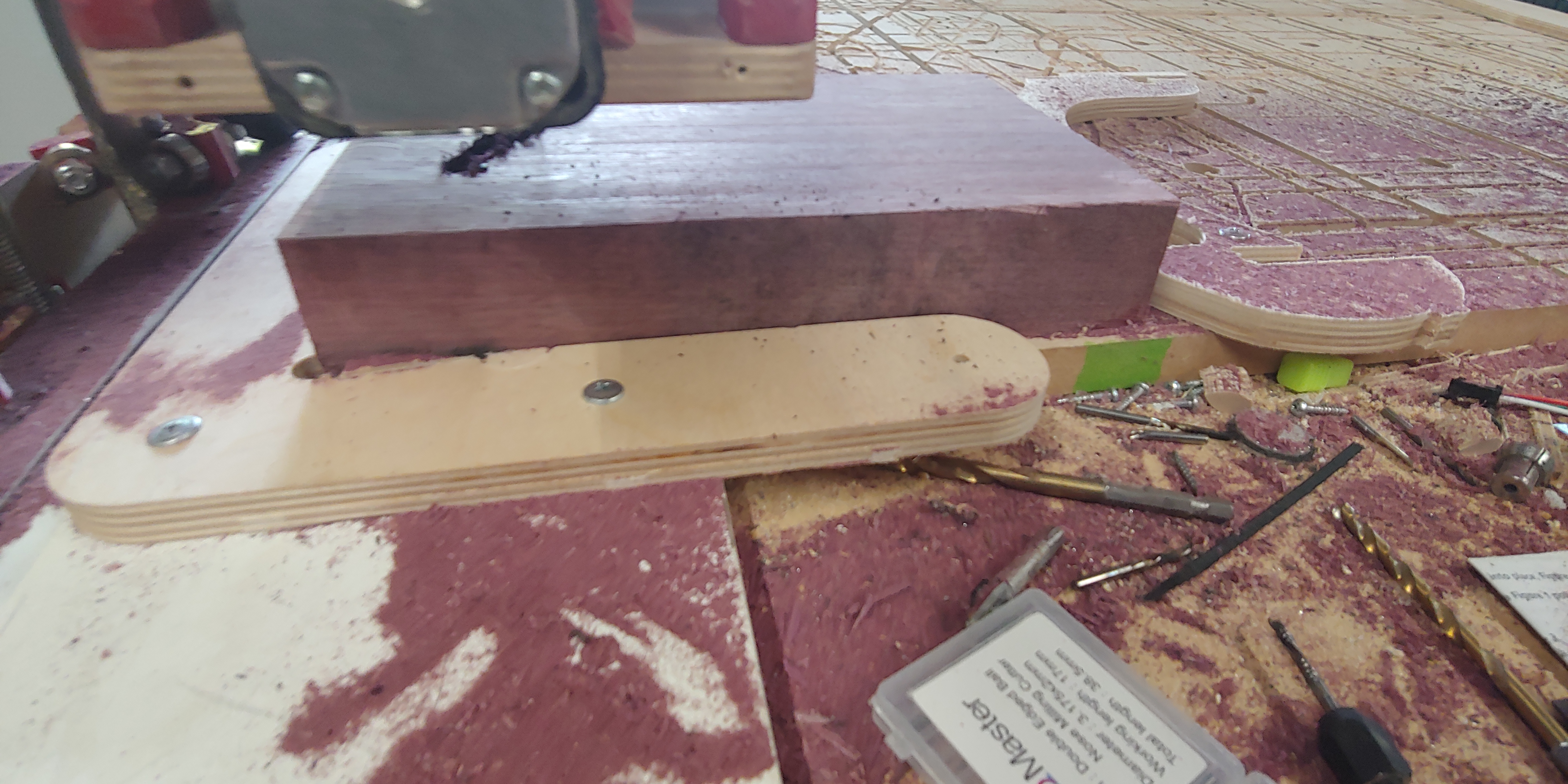

Making sawdust with the good (expensive) stuff today… A chunk of Purple Heart with a Walnut inlay, if I have time to finish it. Mother in law is celebrating a milestone birthday today, so she gets the equivalent of a “Mom” tattoo in the woodworking world…

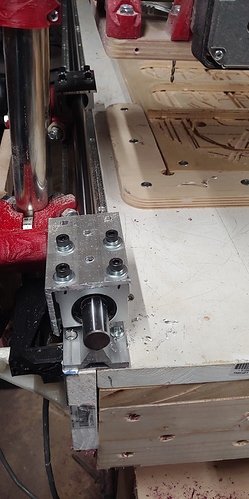

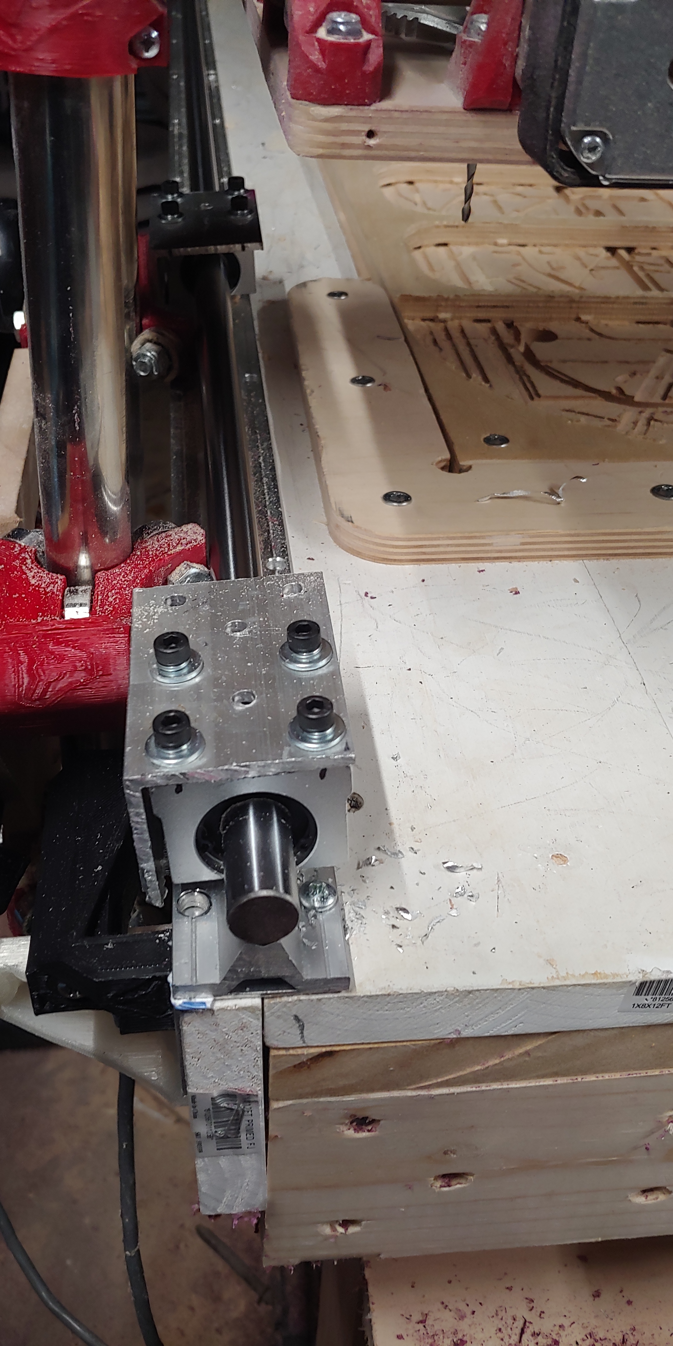

It’s a bit snug where the upper z bearing guide and bolt is, but it clears by 1/64th of an inch all the way down.

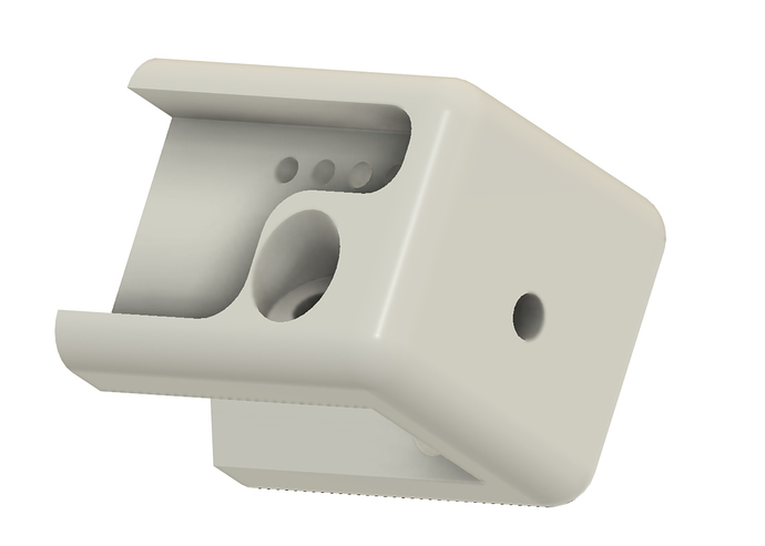

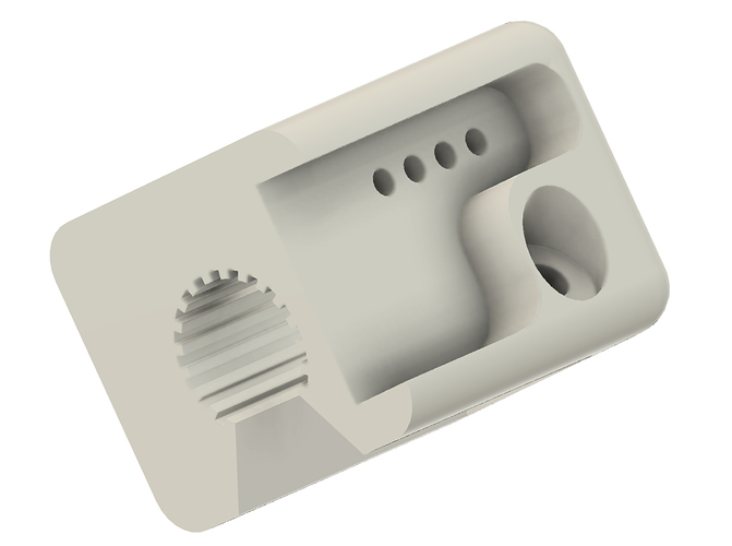

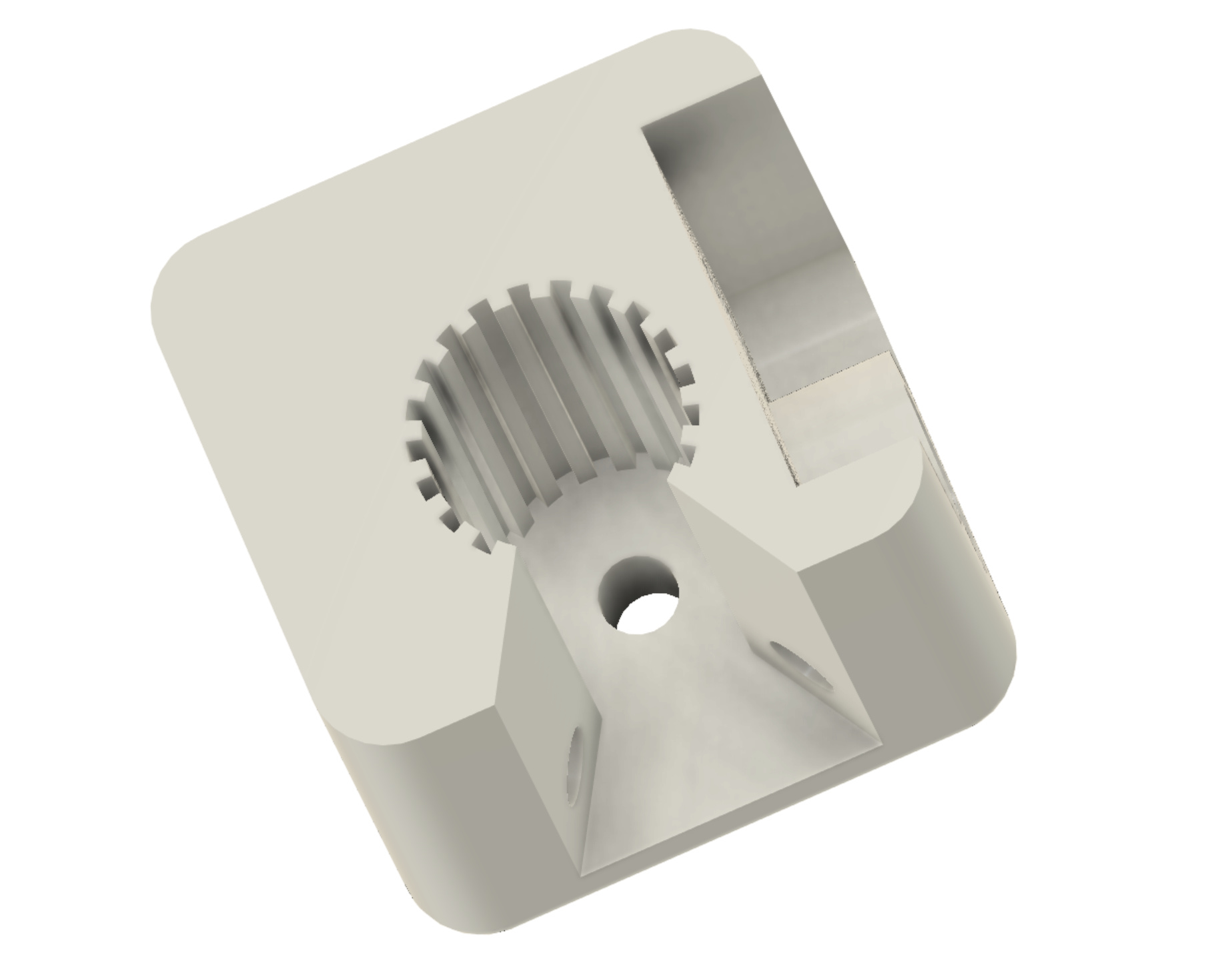

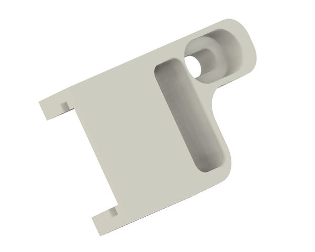

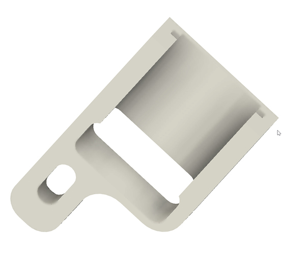

End Stop Block mockup is complete and initial print has started.
The design has two screw pockets (bottom back corner on either side) for mounting to the linear rail mount. The linear rail rod slides into the large round pocket with the splines, and there is a hole in the end for linear rods that have a hole drilled for alignment pins. The interesting shaped side pocket with the four holes is for the end stop switch adjuster. The switch mounts inside the adjuster, and there is a slot for a screw to fit into one of the four holes and adjust fore/aft by a couple of millimeters for fine tuning.

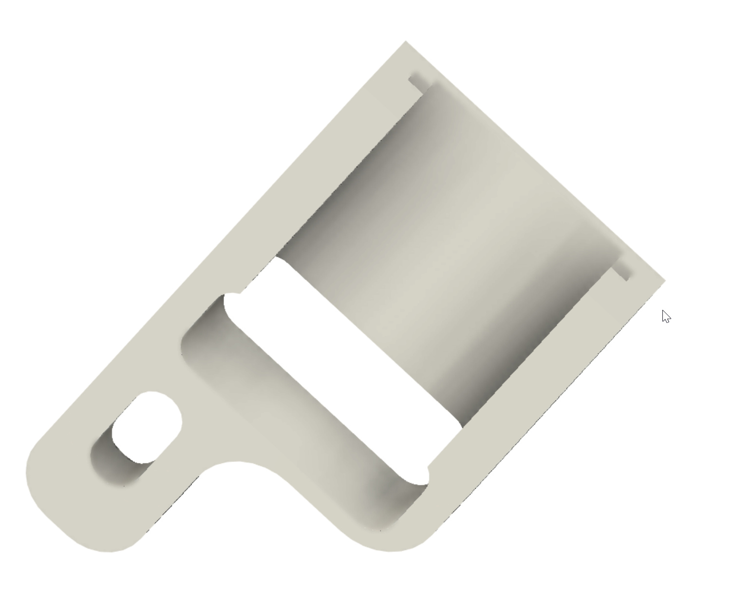

I’m frustrated with the noise of the Makita. I knew what I was getting into when I built the machine, but it really makes the shop space unusable when running. As such, I decided to convert to a 500 watt DC Brushless spindle with speed/direction control. This meant having to design and 3D print a mount for the spindle to replace the Makita.
I started out by loading the Makita plate into Fusion 360 and stripping away every line except for the through holes for the various items that mount to the plate. I then loaded the vac-shoe mesh, aligned it with the mounting holes, and proceeded to design from there.
A 10 hour print with 50% in-fill later, and I have a finished product that fits the spindle snuggly, and will allow me to mount it to the plate using the same holes that the Makita mount uses. In testing the mount with the spindle, I noticed the spindle gets warm to the touch. I expect some warmth, but not as much as I was feeling. Because of this, I’ll be reprinting the mount with some modifications to allow air flow channels between the mount and the spindle body. There should be enough left in contact with the body of the spindle to hold it rigidly, while allowing some air flow.

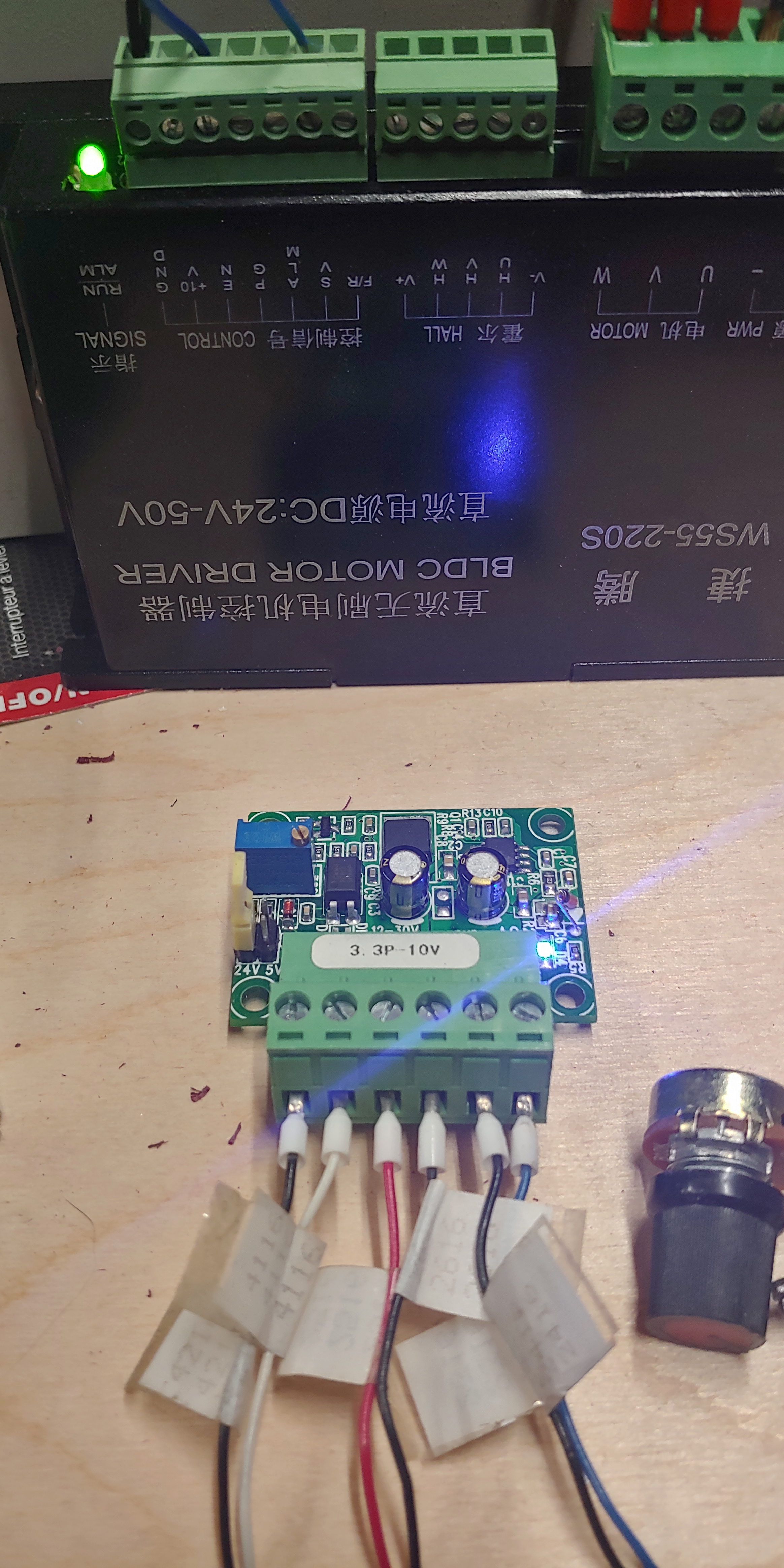

I set the spindle up on the CNC table, connected the brushless motor driver, and then started on the tinkering portion of the project.
What you see here is a PWM to Analog 0-10v converter. The left two wires connect to the Fan 0 output on the SKR Pro v1.2, and some creative pin-mapping in the Marlin 2.0.7 firmware uses this as the speed control output whenever M3 is run to turn on the spindle. The converter is powered with 12v by the red and black wires in the center, and the black and blue wires on the right connect to the motor controller ground and speed input, respectively, sending an analog signal between 0 and 10v back to the speed controller.

Setting M3 S6000 sets the Fan 0 PWM on the SKR Pro to 128 (out of 255), which is 50% duty cycle (6000 being the desired RPM of the spindle, which is a 12,000 RPM spindle). The converter reads the input PWM and outputs a voltage between 0-10v that corresponds with the input PWM. In this example, the output would be exactly 5.00 volts DC. The blue potentiometer on the left adjusts the output voltage, so the way you tune this is to set the Fan 0 output to 128, meter the two terminals on the far right, and adjust the pot until you hit 5.00 on the nose. Then you can monitor the full range of speed from 0 to 255 and confirm your voltage moves from 0-10v across the range.
In my Makita configuration, the Heat 0 output is mapped so that running M3 turns on a solid-state relay. Rather than enable a relay, I left the config for this as-is, and simply moved the wires over to the motor controller to control the Enable function of the controller. Finally, I mapped PC4 in the Extension-1 connector to control the Reverse/Forward function of the controller.
I now have control of the spindle, speed, and direction, and should be able to get the revised mount installed tomorrow.
New spindle mount design done and printing.
