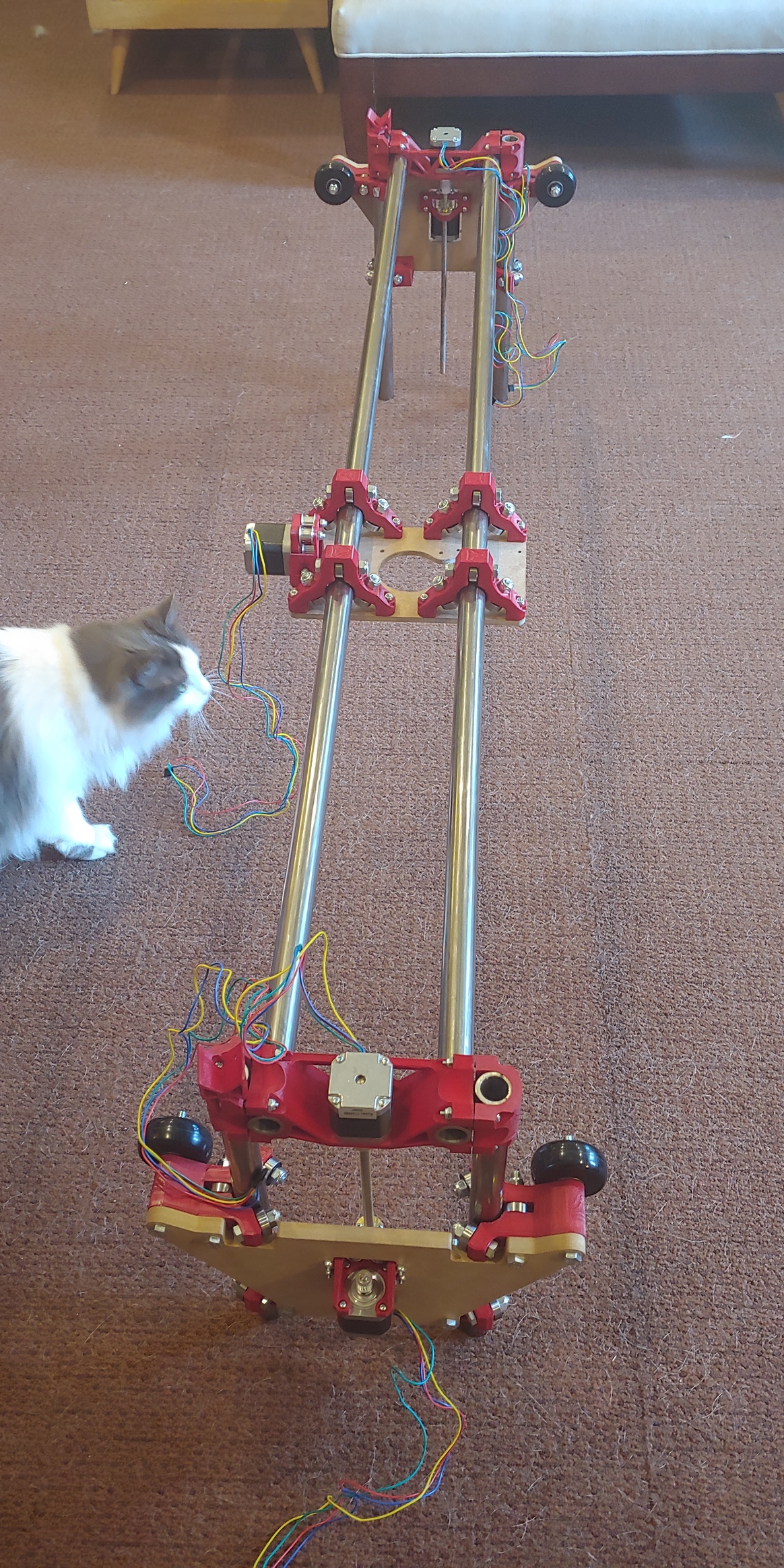

All of the hardware arrived today, and it took about six hours to bolt the entire gantry together and get it ready to set on top of the frame I build tomorrow night and Saturday to start dialing things in.
Please forgive the mess in the pictures. Too many pets and the robovac can’t keep up. I also realized by looking at these that I have the upper hose brackets on the wrong ends and need to reverse the covers so the X-axis belt mounts are in the right place.
