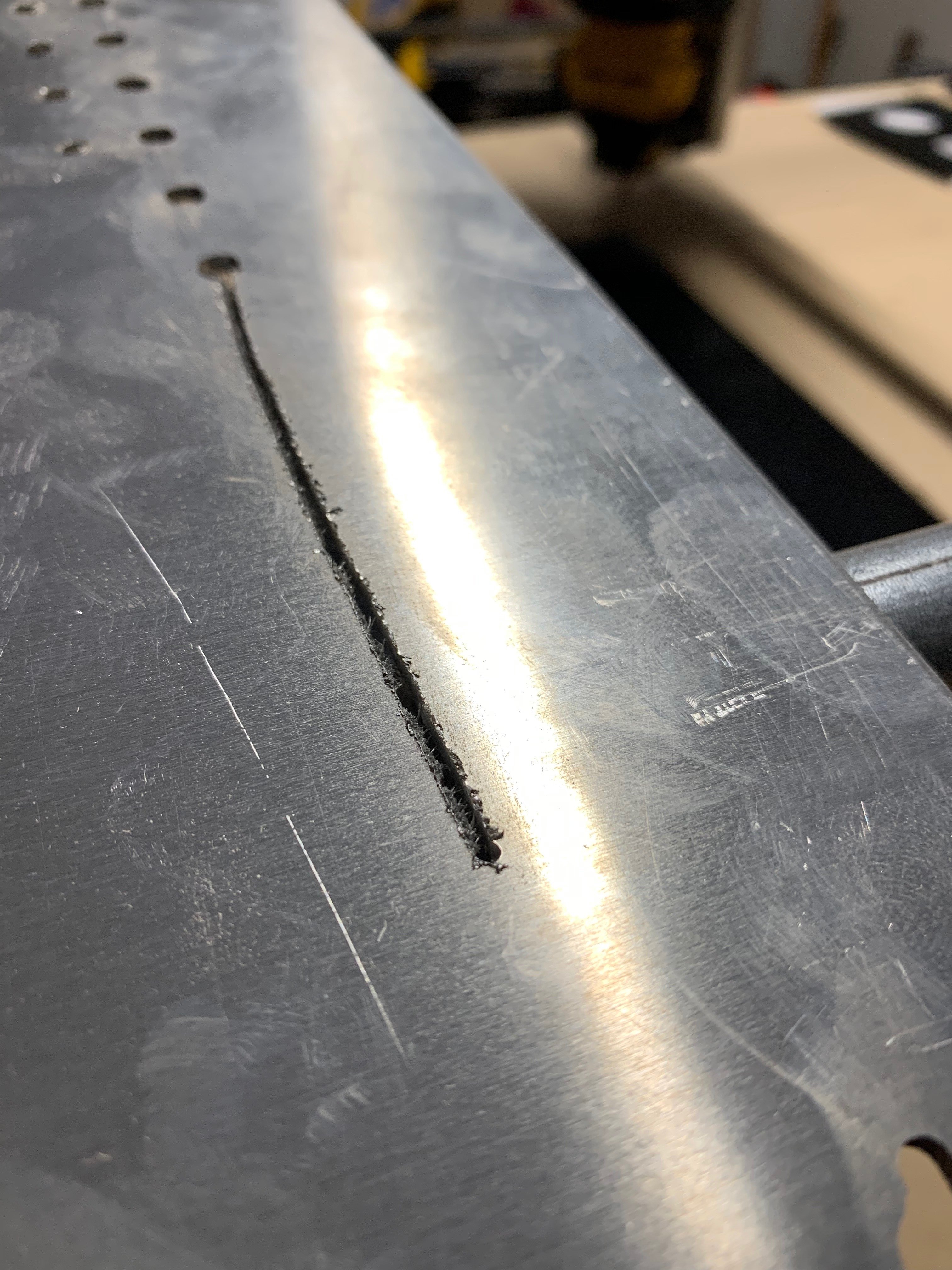

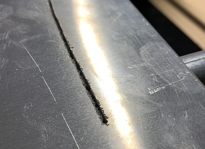

I had the same thing happen twice this week, the machine went from drilling a hole to taking off in one direction cutting through the stock ruining the material.
