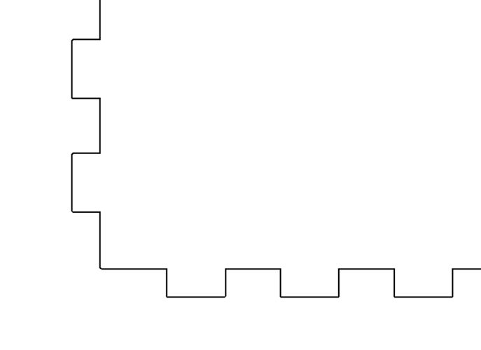

I am on my second day learning MM. I brought in a SVG of a plywood box with tabs. I see the pocket dogbone operation but how do I produce inside corner overcuts to accommodate having square corners?

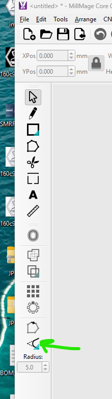

Click the little green/blue arrow to get the tools you need. Took me a minute to find them as well. For CNC I think we use dog bone more than radius.
Thanks found it. I am getting used to the little drop down icons. Do I have to click on literally each inside corner? On Estlecam is a simple command under Automation.

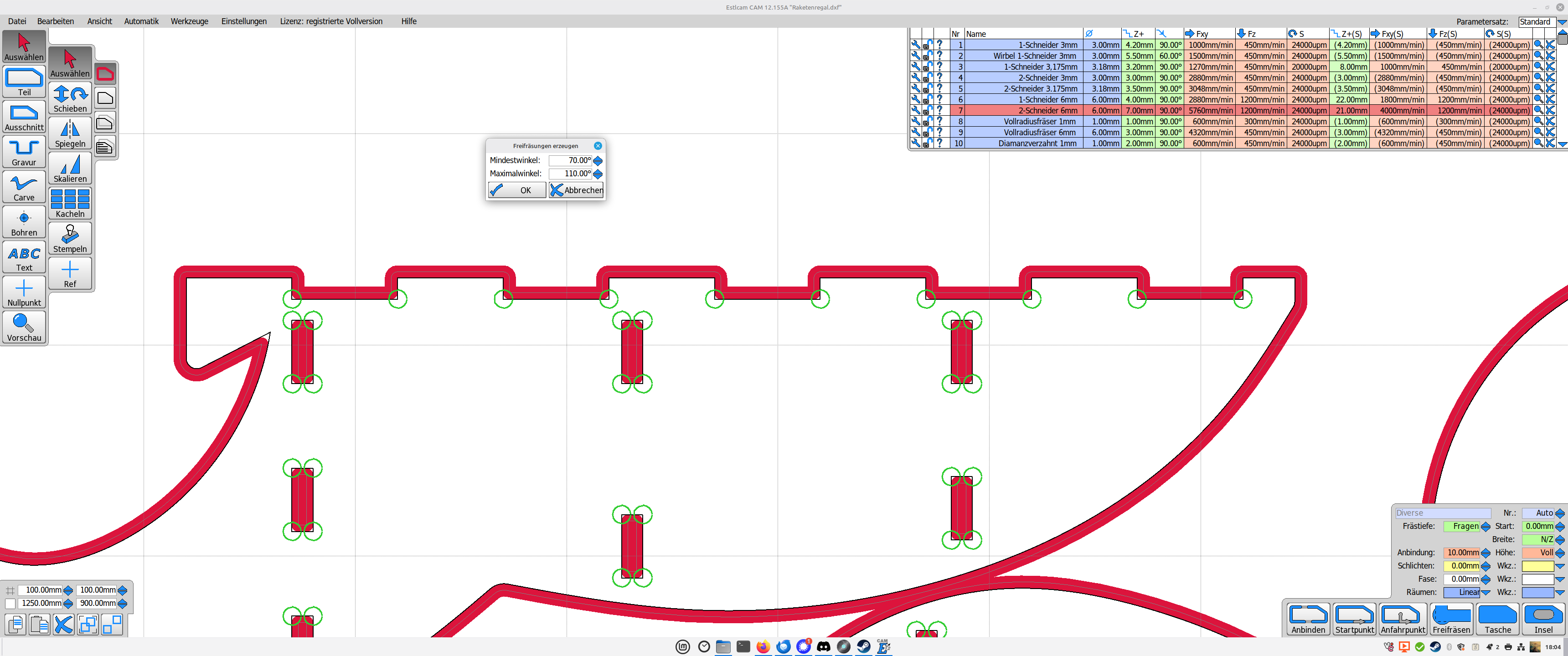

You can specify the angle of the corners you want to be cut out after you set toolpaths and it automatically does it for all of them.

It’s for corners, any degree basically. Really important for finger joints. I’d not want to klick every corner one by one. :smiley:

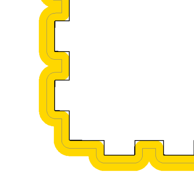

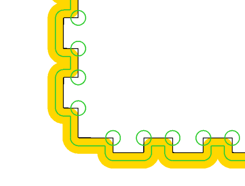

Once you create a “Part” cut path, an exterior profile, you can then optionally do an automatic operation to Add Corner Overcuts and the tool path gets modified.
I tend to do smaller ply boxes and this is not too critical as I use Fusion often and create the inside corner overcuts easily. I asked because I was curious if I missed something.

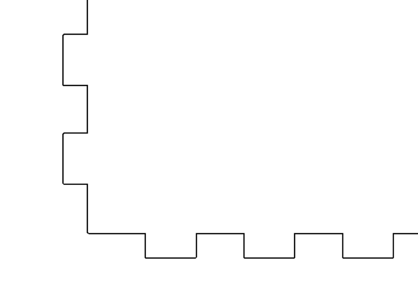

Typical 6mm Baltic Birch
After creating the exterior tool path
And then after doing the Automatic Inside Corner Overcut it highlights first
Upon accepting it creates the toolpath change

Side Note: You can set the desired min-max inside corner angle it is applied to…As clearly shown by @Tokoloshe 's post!! :slightly_smiling_face:
To be seen on my screenshot. :stuck_out_tongue:
On my screen the dialog box is small. Just wanted to highlight for others. Did not mean to step on your reply. :grin:
I know, just pulling your leg. :stuck_out_tongue: :heart: Your answer is a lot more in-depth than mine and explains the whole process. :slight_smile:

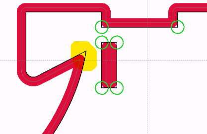

So, if your interior corner angle setting was small enough, would this corner have also worked?
Yes. :slight_smile: I just slapped it together quickly without checking, but this corner is just optical so I just might have left it like it is. :slight_smile:

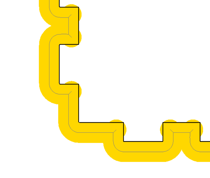

After having it processed the green rings disappear and the dogbones are being shown in red as well like in @CABix’s post.
