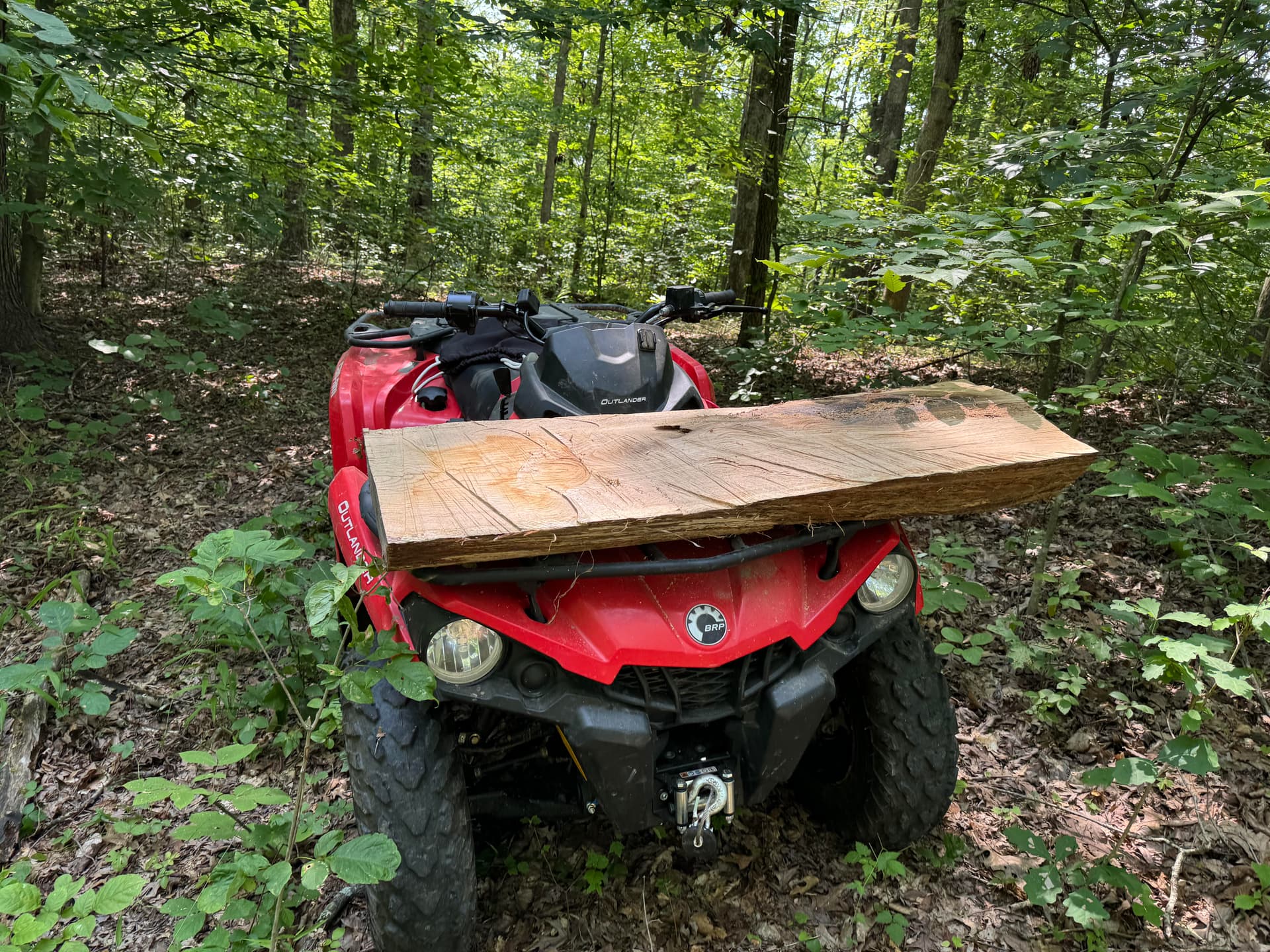

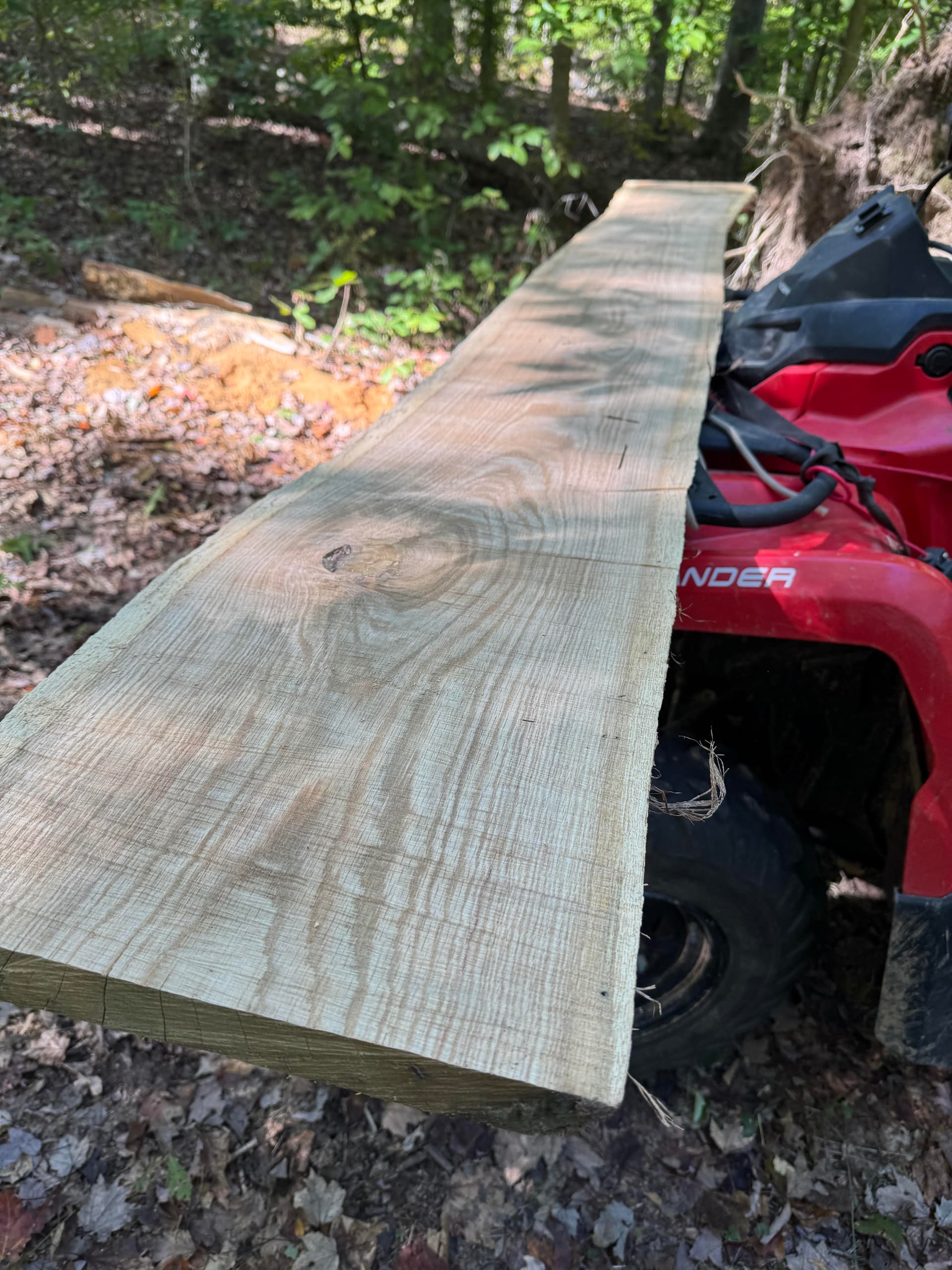

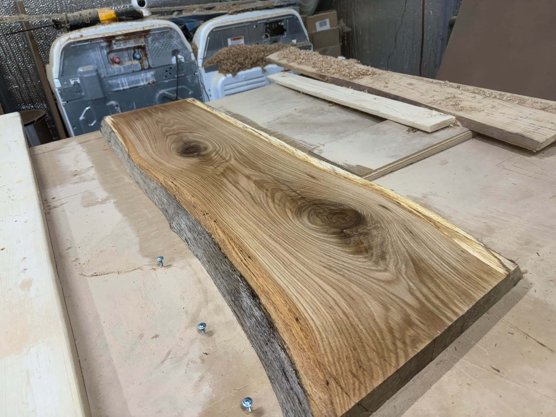

It’s not “made” yet, but it came from a tree I fell and using a chainsaw mill to get flat slabs to play with on my Lowrider! The pictures at the bottom are a coffee table I’m making from one of the slabs. I am getting much better at keeping the saw flat now!

For the most part the boards under 1.5" will dry pretty quick in the sun. I have a moisture meter and during summer I was getting 1.5" boards dry in 4 weeks from out of reading to 5%. It was a stupid hot and dry summer though, so that might have helped!
I also have a workshop that has a dehumidifier so I paint the ends and let them sit in there temperature controlled in the winter, we’ll see how long they take in the winter though!
Still wet but free minus my labor! I had a tornado go through our property and bring down about 30 trees, so I have a bunch of lumber that I’ll get to play with in the coming years!

I can tell you it’s not all butterflies and rainbows, I had to buy an electric hand plane because my first few warped like 2-3 inches of warping lol
