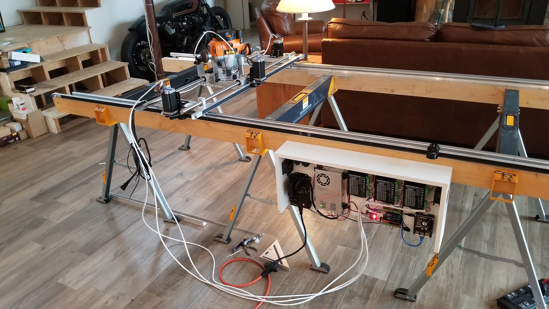

I bought a bunch of slabs a few years ago. Looked into building one of those router sleds to plane them after they dried. One thing led to another and I wound up building a machine that could handle 10’ long slabs.

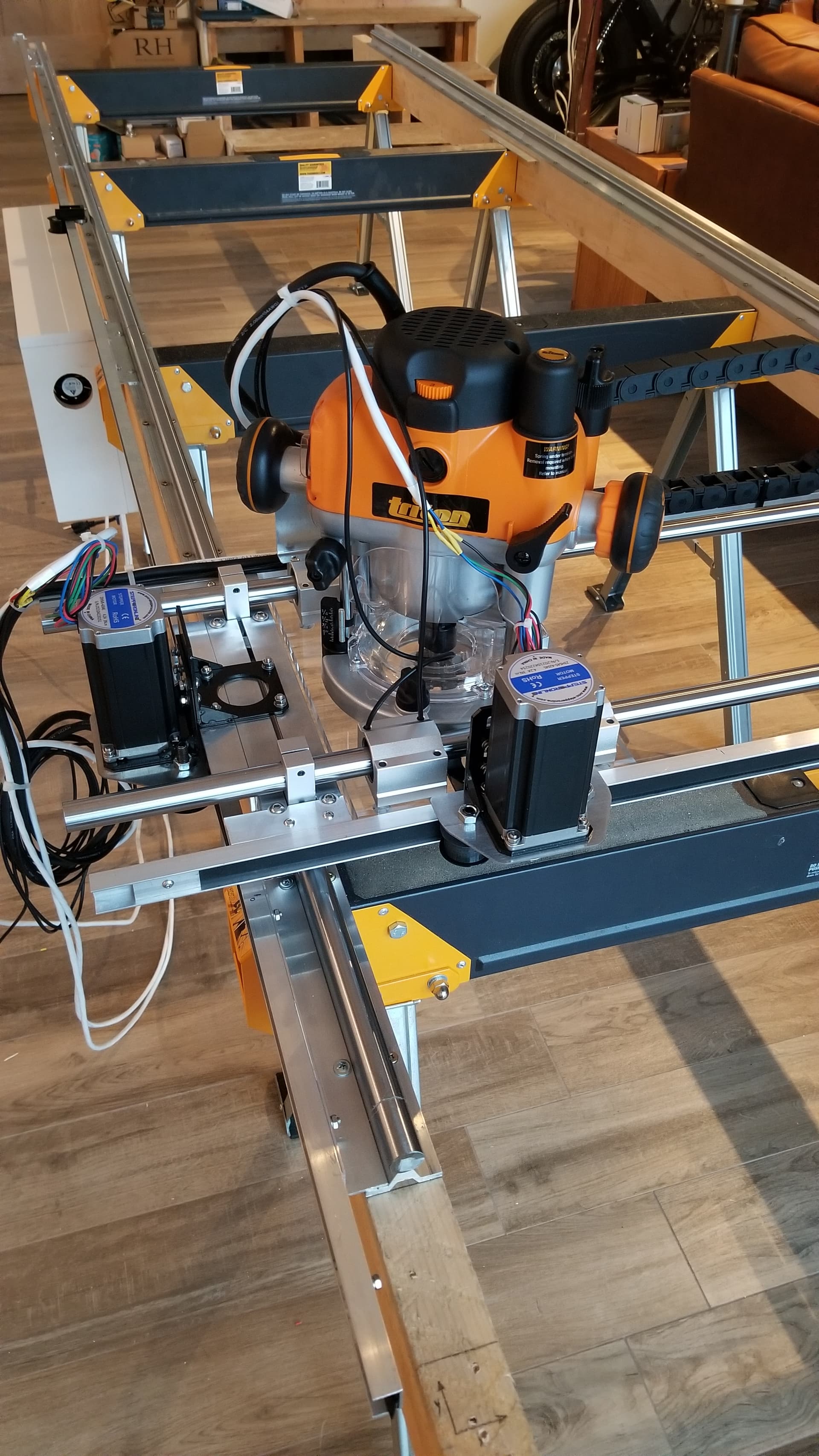

I used an Arduino Uno running GRBL and a RPi to control it wirelessly. Would have been easier with a Jackpot board.
Much easier on the back watching the machine do the work instead of pushing the router back and forth all day.
Quick video of the thing in action

Ask away. I may not always reply right away, but I’ll get back to you eventually. There is no automated Z-Axis. I do that manually (adjust router height) before each pass. Typically take off 1/8" each pass, then do 1/16" on a final smoothing cut. Requires very little sanding when done.
