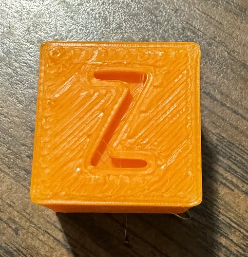

Ok. I know that pictures of printed parts always look terrible, and a lot worse than they do in person, but here’s my baseline calibration cube.
The only calibration I have done so far is E steps because it was ridiculous
I threw together a profile based on one of my Ender 3 Pro profiles as a starting point.
Layer height: 0.24
Print time: 17 minutes
Nice to see your V5 squirting. Printing a few hollow two wall test cubes helped me dial in better flow percentage.
Yep, I’m going to run all the way through Teaching Tech’s calibration, and then move on through the Ellis guide as well.
Just wanted to get a starting point documented, for both quality and time
