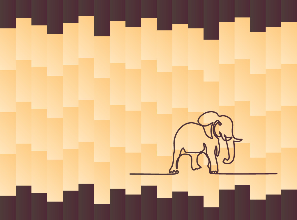

It’s getting to that time of year again where gifts need to be given and nice, end-grain cutting boards are generally well-received. I’ve been playing around with some inlays and an extra fine 30° x 1/4" V-bit with what I believe to be some solid results. This is one of the models I worked up.
Oh my goodness that is absolutely flawless!! The details and tiny edges are extremely impressive, I zoomed all the way in and see no signs of imperfection. WOW!
I couldn’t have done it without the Primo. Excellent accuracy and precision on the inlay parts.
I probably should have noted that I did use my little Harbor Freight shop press to set the inlay. It certainly helps in setting those clean edges. It doesn’t get a ton of use (no pun intended), but it served its purpose here.
Certainly easier than trying to mess with clamps and even pressure.
I’ve seen a few videos on youtube of endgrain cutting boards with inlay, and I’m starting to think that the endgrain orientation is a contributor to getting good detail. I’m thinking that the fibers vs. lignin is helpful in not losing small details when oriented as end-grain, whereas with long grain, the strength of the fibers contribute to breaking when the feature is supported only by lignin.
In my recent inlay experiments I’ve made some endgrain veneer (approx 5 mm thick) and had no issues. Although I haven’t really pushed the limit as far as detail, it has been very good so far.
just a minor aesthetic thought… If you decide to do the whale, either flip it 180* or move it to the other side of the board. That way it’s flowing onto the board.
Otherwise, your board looks awesome! I need/want to do some cutting board inlays soon. I need to finish getting the new CNC up and running to start doing this.
