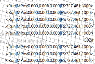

G0Z1 commands does nothing still, green bar adds up
Until I fix the code try this…
Send your gcode commands with full coordinates.
Instead of G0Z1 send G0X0Y0Z1 an see if it moves. I tested this in a Arduino Simulator and worked.

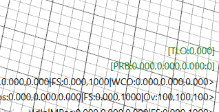

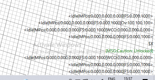

So after $X worked but not G0X0Y0Z1, I turned off the arduino, and now when I try to connect it doesnt show the green text at the start of the status messages - image is the start of them as soon as i hit connect
Now I just restarted the arduino from the ramps button, disconnected the serial and reconnected, connected on OpenCNCPilot and
Part of the green text already went past, $X worked!

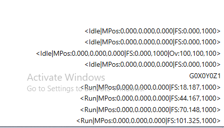

G0X0Y0Z1 didnt move anything but the command went through? Didnt add to the green bar
Btw i keep on unplugging the arduino to turn it off/restart it, should I be doing it some other way?
Added the
Connects fine, unlocks fine but no movement even with G0X0Y0Z1

Position seems to be still 0, 0, 0

same as before, pos still 0,0,0 - green bar goes to 9/120
