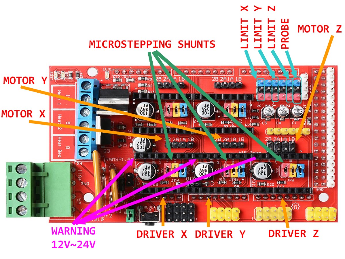

This will get you started
microstepping
Now for uploading µCNC:
DO NOT POWER YOUR PRINTER…
Just connect the USB cable. It’s enough to power the Mega board and program it.
Install Arduino IDE. Go to µCNC github page download the code from the delta robin nano branch and unzip it
Go to the folder with the contents and enter folder uCNC.
You will find a uCNC.ino file there. Open it with Arduino IDE.
Then follow this…
If everything went well and you open OpenCNCPilot to connect to your Mega COM port communications should start…

I was wondering, before mounting the stepper drivers, how much micro-stepping should I set up?
EDIT 1: If it matters, on the MKR board all three shunts for every driver were on.
You can go with the full 1/16th microstepping (that is all shunts on). TMC2208 will do some interpolation microstepping of it’s own. I usually use any value from 1/4th to 1/16th. 1/4th will give me more torque but noisier steppers and less resolution. So just use the same configuration. It will do fine.
Edit: just for reference I think (depends on the drivers and motors of course) but as a general rule you loose about 30% of torque with each microstepping factor you introduce.
Drivers, motors and endstops installed as well as z probe!
Everything except for power, my printers power supply is 24V…looking into videos of how to deal with a possible conversion of RAMPS 1.4 to 24V
EDIT1:
Should I:
  1. Just cut the D1 diode on the RAMPS board since the Arduino will be running off of the Serial port no matter what and add new fuses to the ramps to handle the 24V
  2. Keep the D1 diode and replace the voltage regulator on the MEGA to handle 24V to a L78S05
Both conversions are quite easy, wondering if one is better than the other
Replacing de voltage reg Will leave you the option of running marlin (if you latter reuse this board for a 3d printer) with a LCD controller and print from sd card. From that point of view this option is more flexible. For ths case it won’t matter because uCNC Will be comunicating via USB.
If you don’t mind the component replacement operation and can get locally go for it. I myself have a third option on mine. I reverted the motor voltage Pins on the drivers I run on higher voltages. I have RAMPS running the heated bed and extruder and z azis @12v and X and y @ 24v.
Yeah it seems I can easily source the parts and the swap is within my soldering skills!
The third option is interesting but I assume it wouldnt really make sense in my case since Im running delta kinematics!
Ill be back once the swap is done :slight_smile:

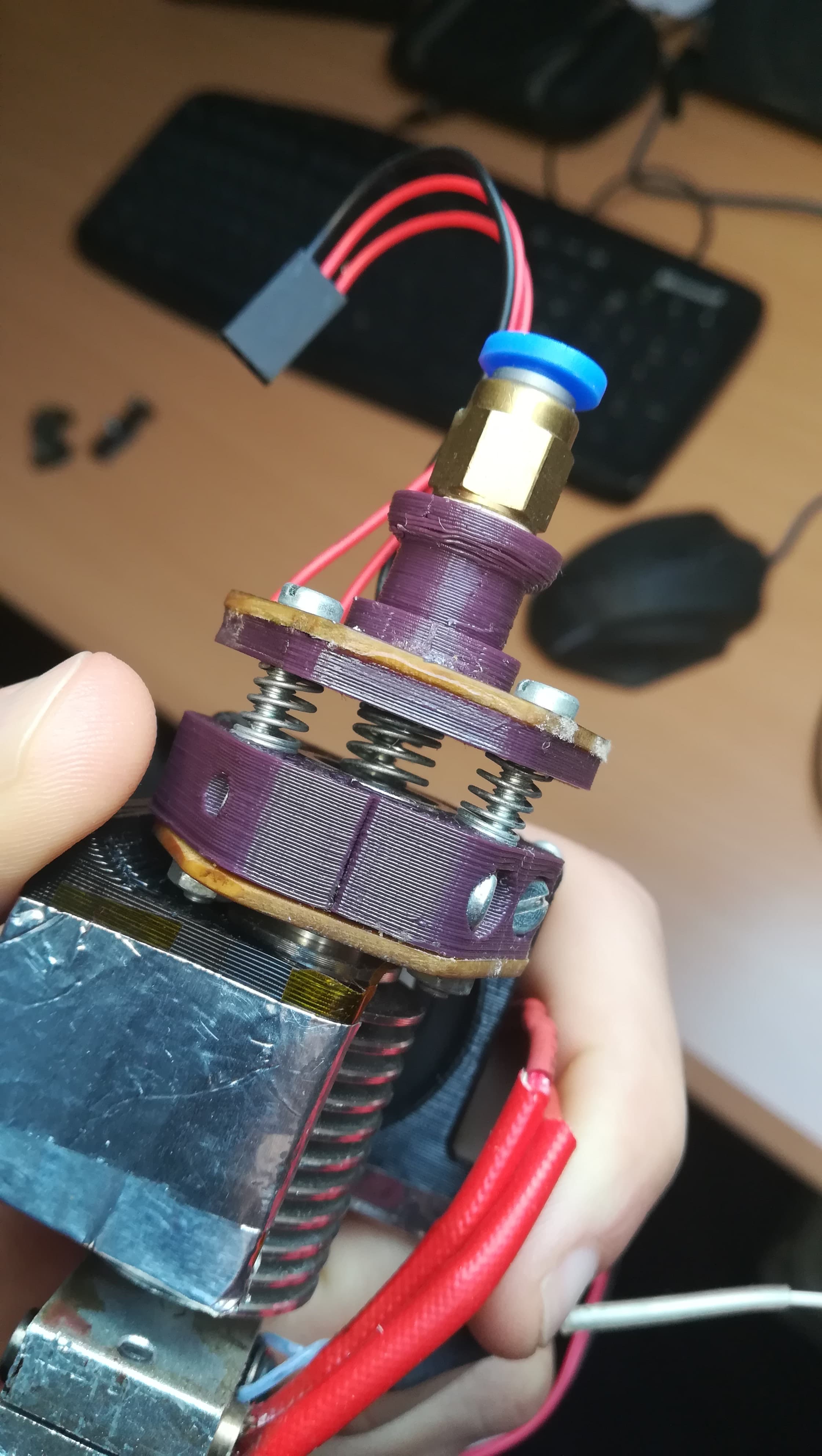

EDIT: By the way (although I never picked up on improving my design) this kind of printable renishaw probe might be a viable alternative (also depending on the precision your trying to achieve) and all most all parts (don’t know about the magnets) can be found in the local hardware shop.
EDIT2: On my 3d printer I have a different implementation of the same concept but to use the hotend as a probe itself.
Here is a picture.
Indeed initially it was going to be a BLTouch but I sent it back, because I figured it would be more complex to make it work with µCNC.
My main reason for the BLTouch was the actuation force is extremely low, so much so I could not find any data on it and just had to buy it to find out for myself!
The “nozzle” will be plastic, more info on that down the line :wink: If its a circuit closing the nozzle probe idea wouldnt work, if its a piezo it could, but Im not a fan of the idea because of design complication with my eventual endeffector! Although it does have its pros and cons, any opinions on them? Could a piezo probe be used in µCNC with my current hardware? Asking bc as far as I know they dont act like switches and need some calibrating, and I read theyre snsitive to vibrations too so idk. But probing with the nozzle is really cool and easy (theoretically :sweat_smile: )

No my nozzle doesn’t have a piezzo sensor. It’s actually a mecanical switch that is closed in 3 points. I can send you pictures of it later… But it’s too stiff for your application.
EDIT: and here are the pics. Let me explain
This is the top contact plate. It has 3 cuts isolating 1/3rd of the hexagon for each screw. The 3 wires (red-red-black) are soldered to each contact zone.
This is the bottom contact plate. Although it shows that it’s cut its actually a single contact surface (it’s soldered-I just used that PCB from an other top place and shunted the 3 parts). The nuts are tight against this plate connecting the 3 screws eletrically. You can’t see but there are counter nuts on the other side to keep the contact.
The springs force the top plate against the head of the screws, closing the contact.
And this is the circuit board. Kind of hard to see but it’s basically 2 transistors, 2 leds and a few resistors (all smd). The transistors act like a AND or OR gate (I don’t recall what I did exactly). Each led gives me the info of wich contact is open. One led is contact 1, the other contact 2 and both is the common (GND) contact that is trigggered. This is then connected to the normal switch pins of the RAMPS.
This was my 3rd iteration at this hotend-as-probe kind of system. It’s far from perfect but it has stick around for a few years on my printer now. It allows me to swap a hotend in about 30 seconds or so.
