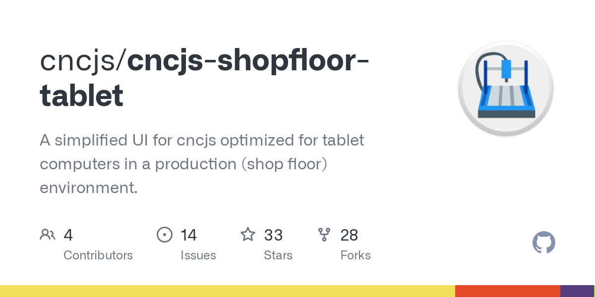

And I have disappointed that there is lack of gcode senders adapted to touch and small resolutions. Octoprint has touch ui plugin and repetier server (in trial/paid version), but they both dedicated to 3d printing needs.
Cncjs in stock version doesn’t fit even to bigger of my screen. There are 2 third party skins for it, but i haven’t test them yet.
