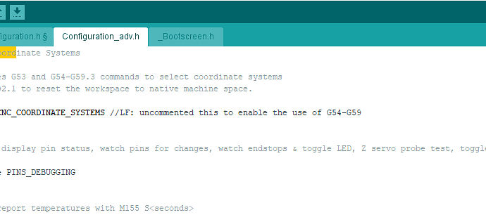

Marlin has g54-g59, but you have to uncomment define (CNC coordinate systems). I guess Ryan enabled it in latest update
You may try to use it this way:
Use g54 as machine coordinate system. Then move to required offset, switch to g55 (as example) and then perform g92 x0 y0 z0. So 55 coordinate system will have the offset.
I didn’t try that, but i saw marlin sources. I think it should work

#define CNC_COORDINATE_SYSTEMS is located in Configuration_adv.h and indeed it has been commented out!

Guys, I uncommented the line, but I get “G55 unknown command” in the serial monitor when I run test G Code containing G55. So does it actually work?
[attachment file=79958]
[attachment file=79959]
I also tested sending G53, G54, G56, G56 X10 Y10 but none of these commands were recognised by Marlin 2.0.x bugfix

Maybe it is a pronterface thing, try repetier or straight from an SD to verify. I am pretty sure a few others are using it.
The G-code file was on an SD card and in that test Pronterface was only listening to the serial port (I could have read those error messages with Arduino’s serial monitor too). Also note though: unless you listen on the serial port with a serial monitor, you would never get those errors - they are never reported on the LCD.

I was wanting this functionality for a certain thing I’m working on with MPCNC, and I can confirm it is not working (“Unknown command”), even with CNC_COORDINATE_SYSTEMS defined (which it is by default in Ryan’s fork).
I went digging in the code and it appears to be only missing the parsing commands in gcode.cpp. I tried submitting a pull request against Marlin bugfix-2.0.x but I am a newbie when it comes to GitHub workflow. So even though the code appears to work, there is a decent chance I might have messed up the submission.
Anyway the patch is fairly simple and if anyone is interested it’s available through the PR: https://github.com/MarlinFirmware/Marlin/pull/13654

i had already made same fix a month ago (just didn’t find a time to make pull request) and tested commands.
it seems g54-g59 works well.
but g53 looks like still broken. i didn’t spent time to find a reason.
I could not tell if G53 was working or not. It appeared it was not working but I did not look closely (and I’m not confident in my expectations for what it should be doing). I could easily believe that G53 is still broken.
All I tried was G54 and G55 together with jogs and G92 and M114 and it looked like the workspace coordinates were being respected, but it was just a few minutes of testing.
If upstream Marlin accepts it, then it should propagate and we should be good officially. If not, then anyone who truly needs G54-G59 (which is almost nobody) can still patch their own copy with 11 lines of code.
