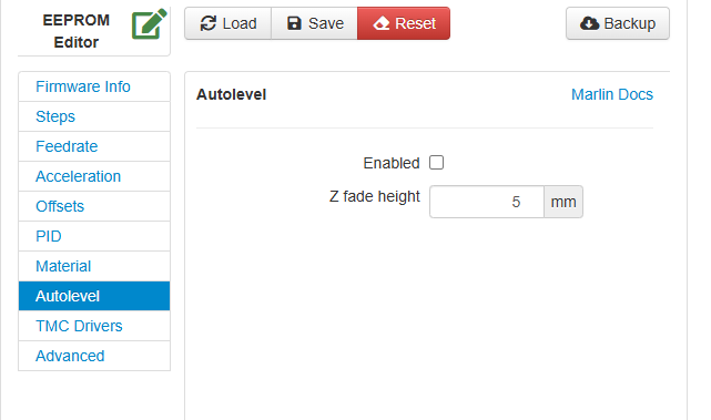

However. Clicking a few things this morning on a whim and I discovered this little oppsie.
I wonder what clicking that checkbox does :confused:
That’s not it. That’s just turning it on ‘right now’.
