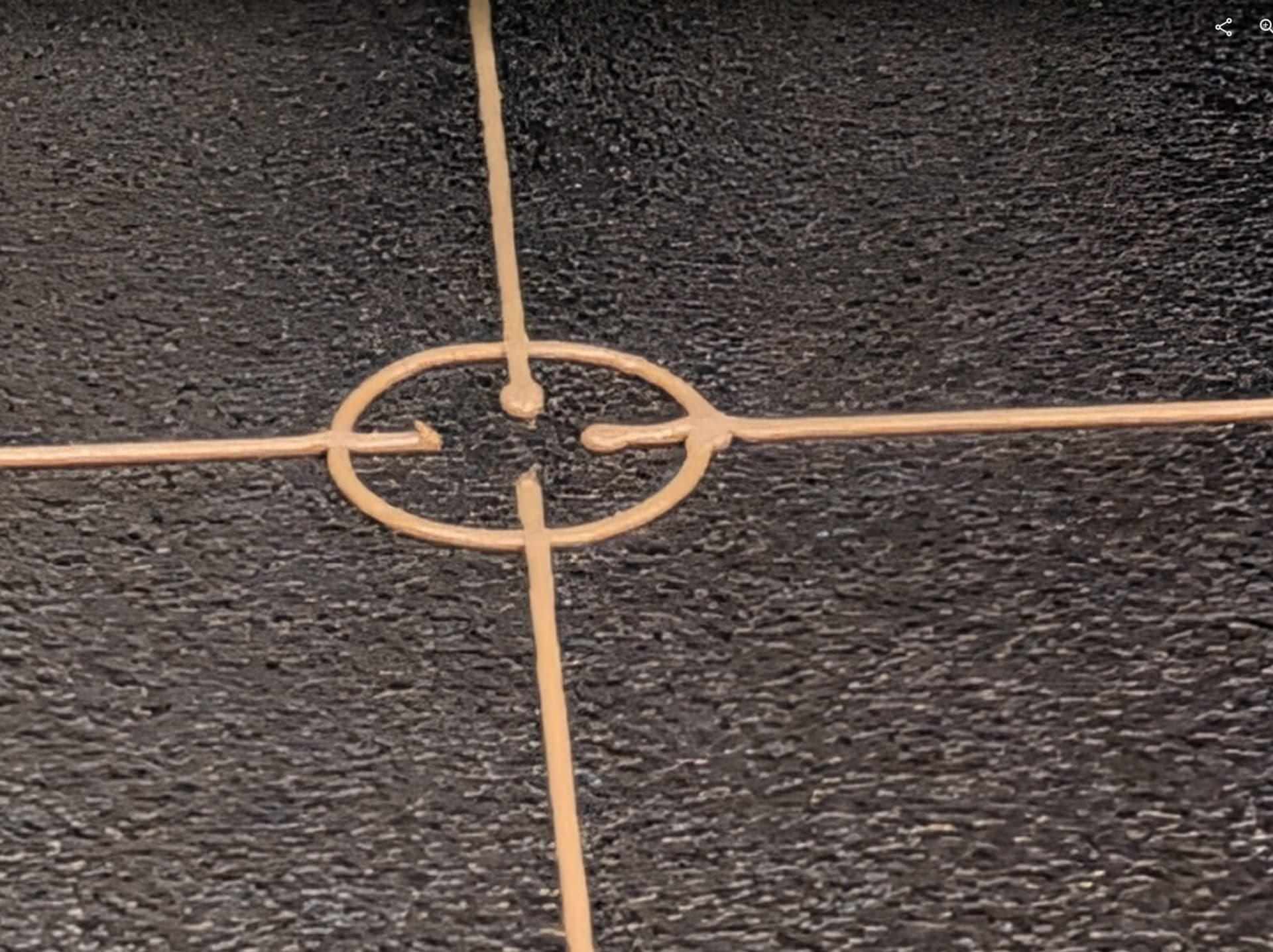

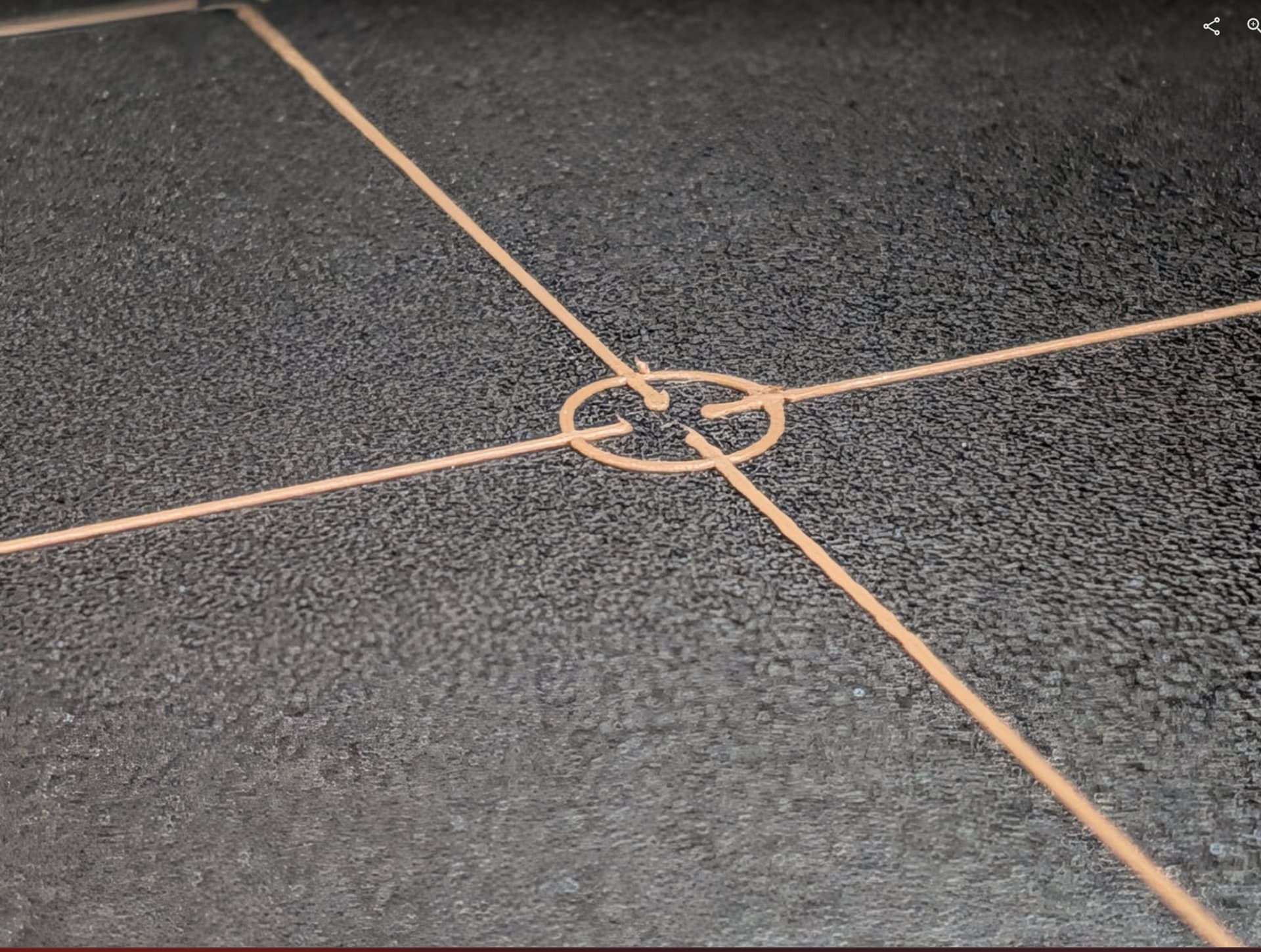

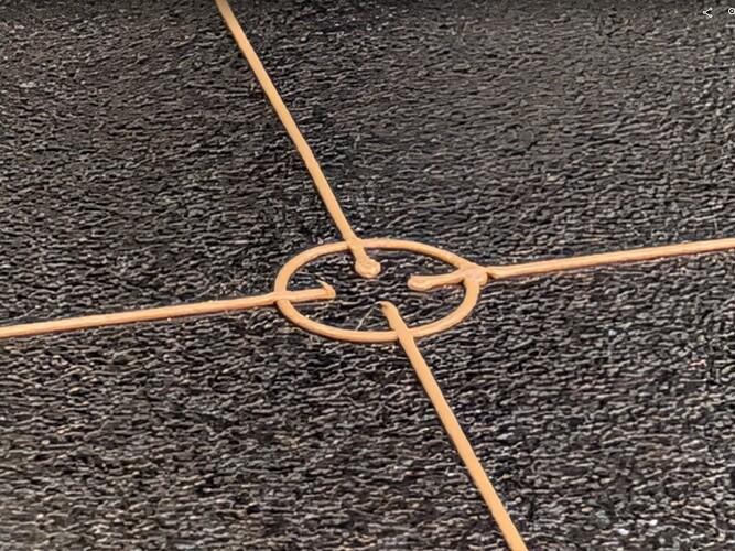

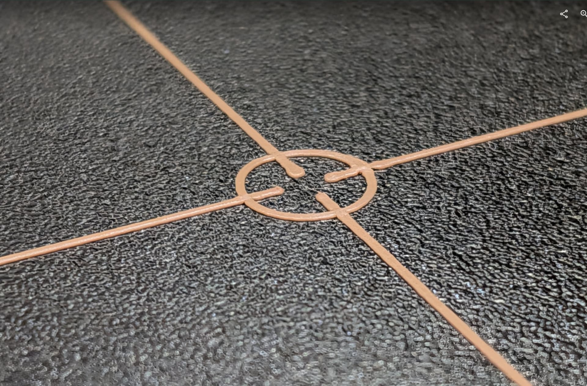

Here’s some pictures of the G26 print. I zoomed in on a few of the spots along the outer edge. They look fairly even to me.

And no printer is perfect. As long as the mesh isn’t compensating for too much, it is well within tolerance of any other printer error. It should be able to lay down a nice first layer.
