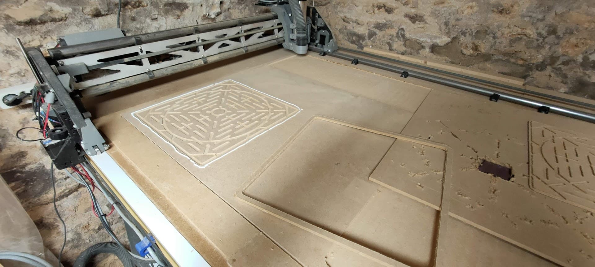

So, what do you do when you have a CNC and your wife shows you something like this? :slight_smile:

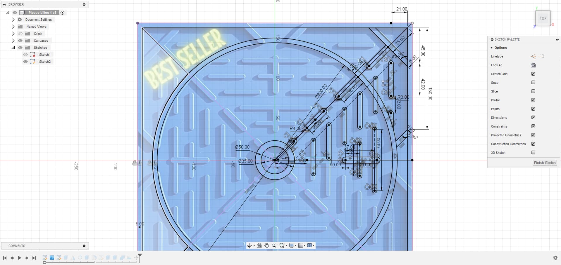

The design is pretty straightforward and I used one of the pictures as a canvas
Then it’s just a quite simple machining, although F360 had a really hard time navigating through this maze trying to build the adaptative clearing toolpath

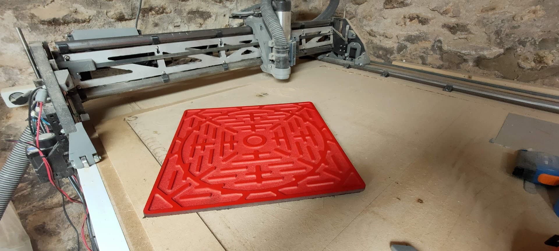

Note: I found a better/faster way to machine this, but that’ll be for the next one…

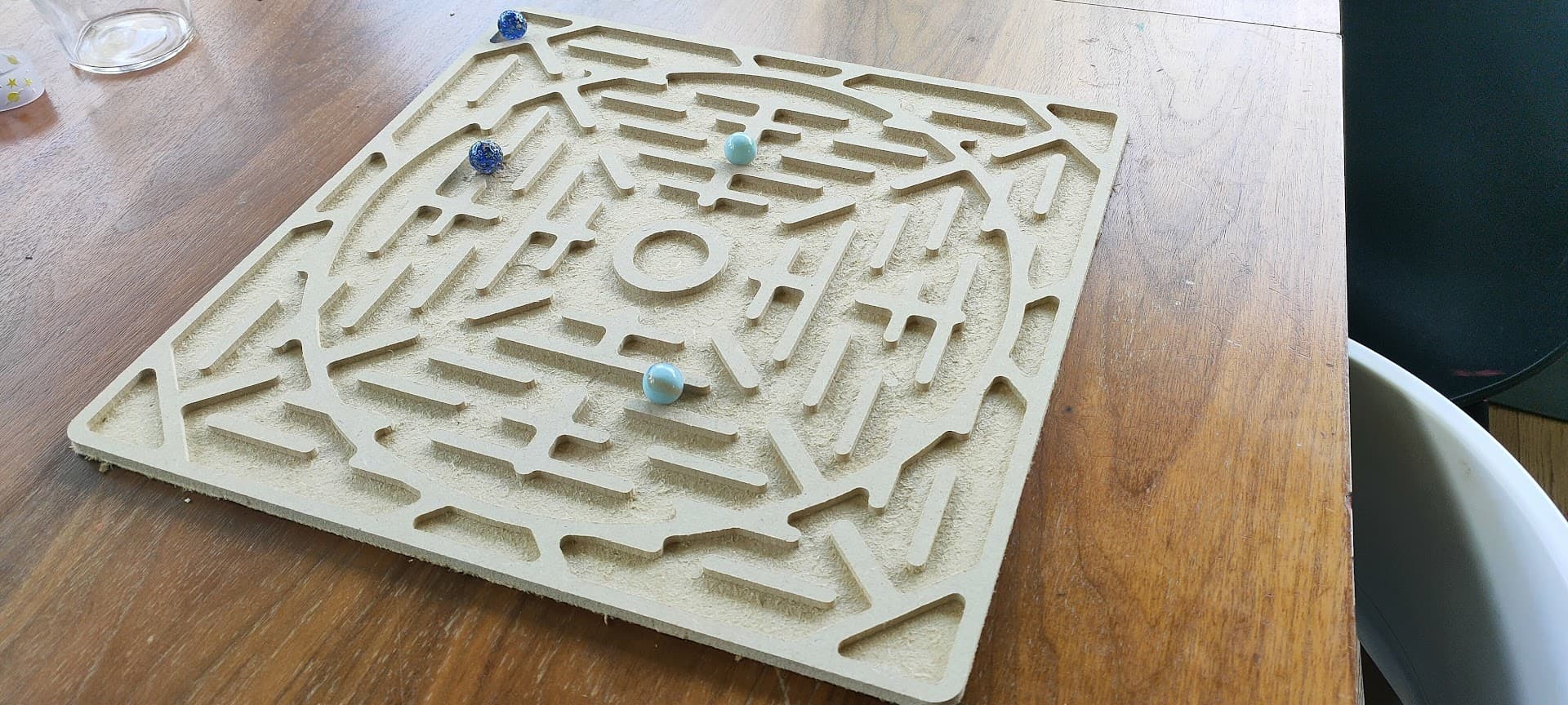

Quick coat of paint, and it’s good to go…
Nex step is to test this out tomorrow with the kids, and maybe if I feel brave, try to machine a mold and make a silicone cast…
I made this one out of MDF, do you think it MDF can be used as a mold for a silicone cast? or should I use plywood? hardwood maybe?

MDF is perfect - but you will have to seal it well first, and that can be a bit tricky - I’ve had a lot of luck with auto body filler/primers that flash off very quickly. Apply it in lots of thin coats is the trick.

First test for the mold went pretty badly
Guess I need to re-surface the bed again -_-
Second try is a bit better…
This time I only carved the “tracks”, without the lip around
Then I added the “ring” I salvaged from the previous failed attempt
And finally I contoured the whole inner and outer perimeter to get a straight edge
Now I need to sand this and seal it somehow…

I’m thinking about painting some epoxy into the mdf and re-milling it after it’s dry…
Would that work as a sealent ?
