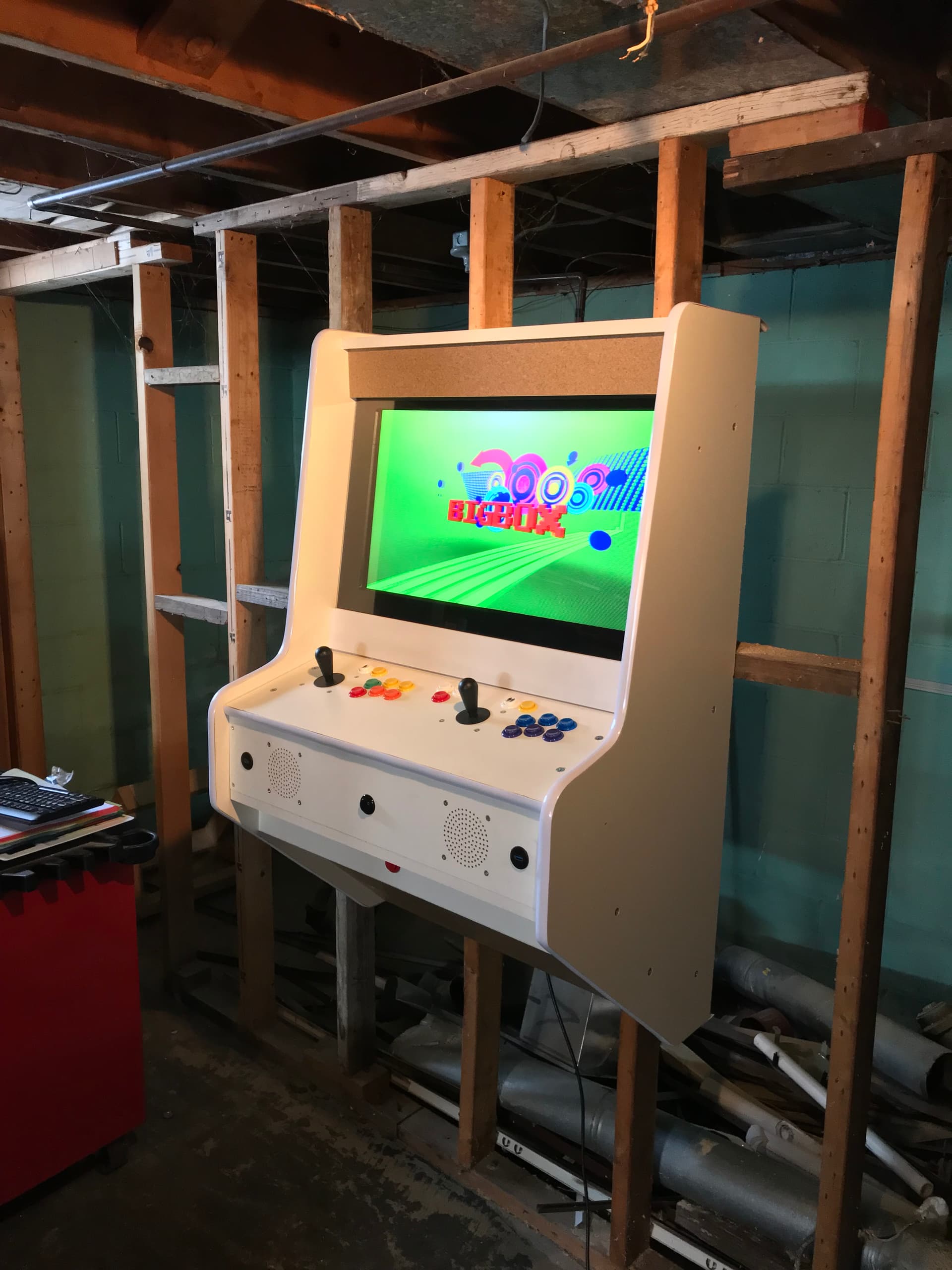

I made something like this about 7-8 years ago. Don’t remember much about the build and ended up parting it out to build a full size cab for a friend. It was nice having it off the floor.

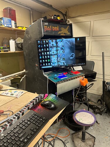

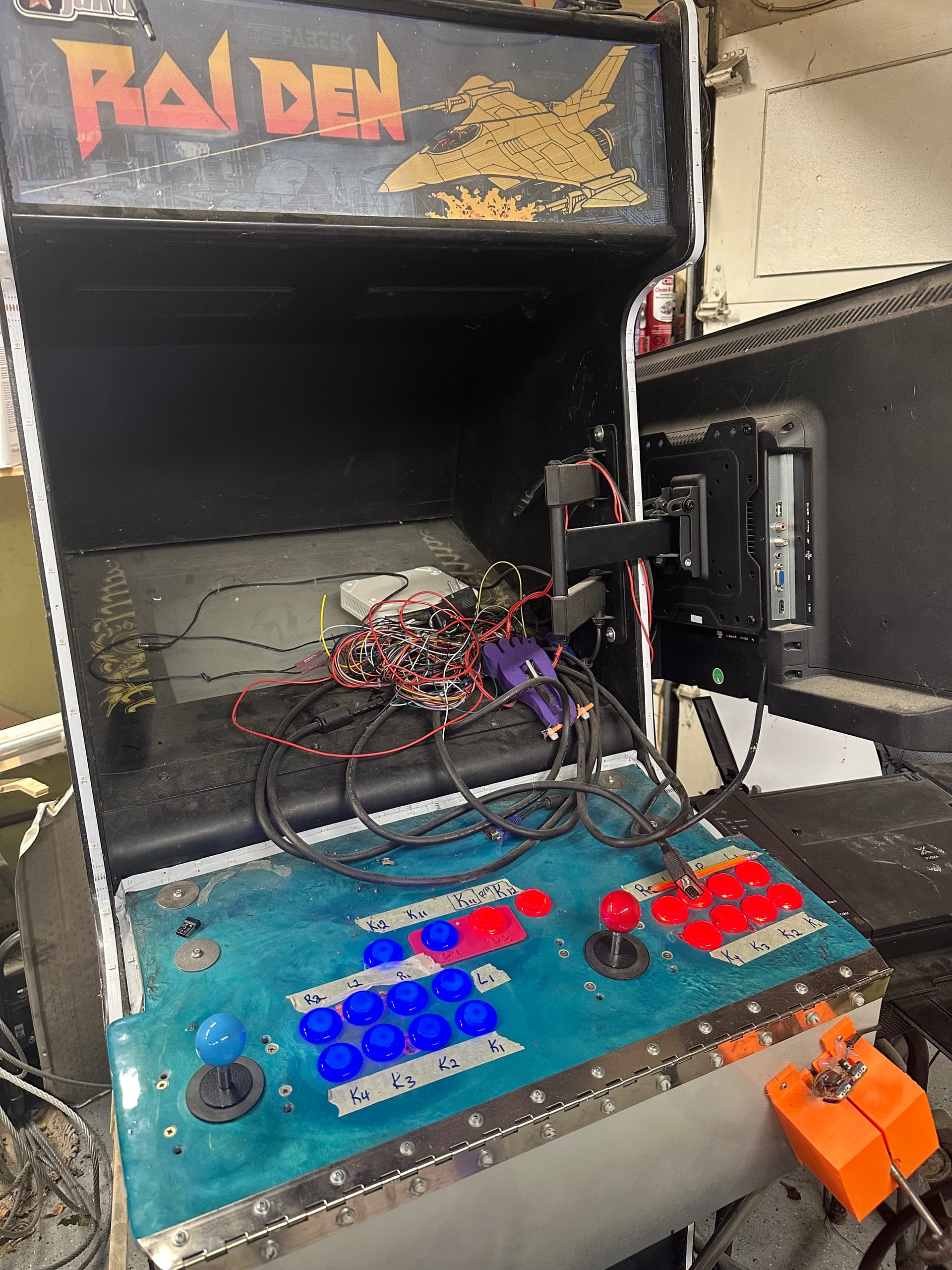

My stuff is all janky and messy but I kind of doubled my arcade for a work station. Mounted a pc on the side of an old cab. Couldn’t bring myself to get rid of the old crt.
Word of warning if you go the CRT way there is some capacitor shorting to consider.

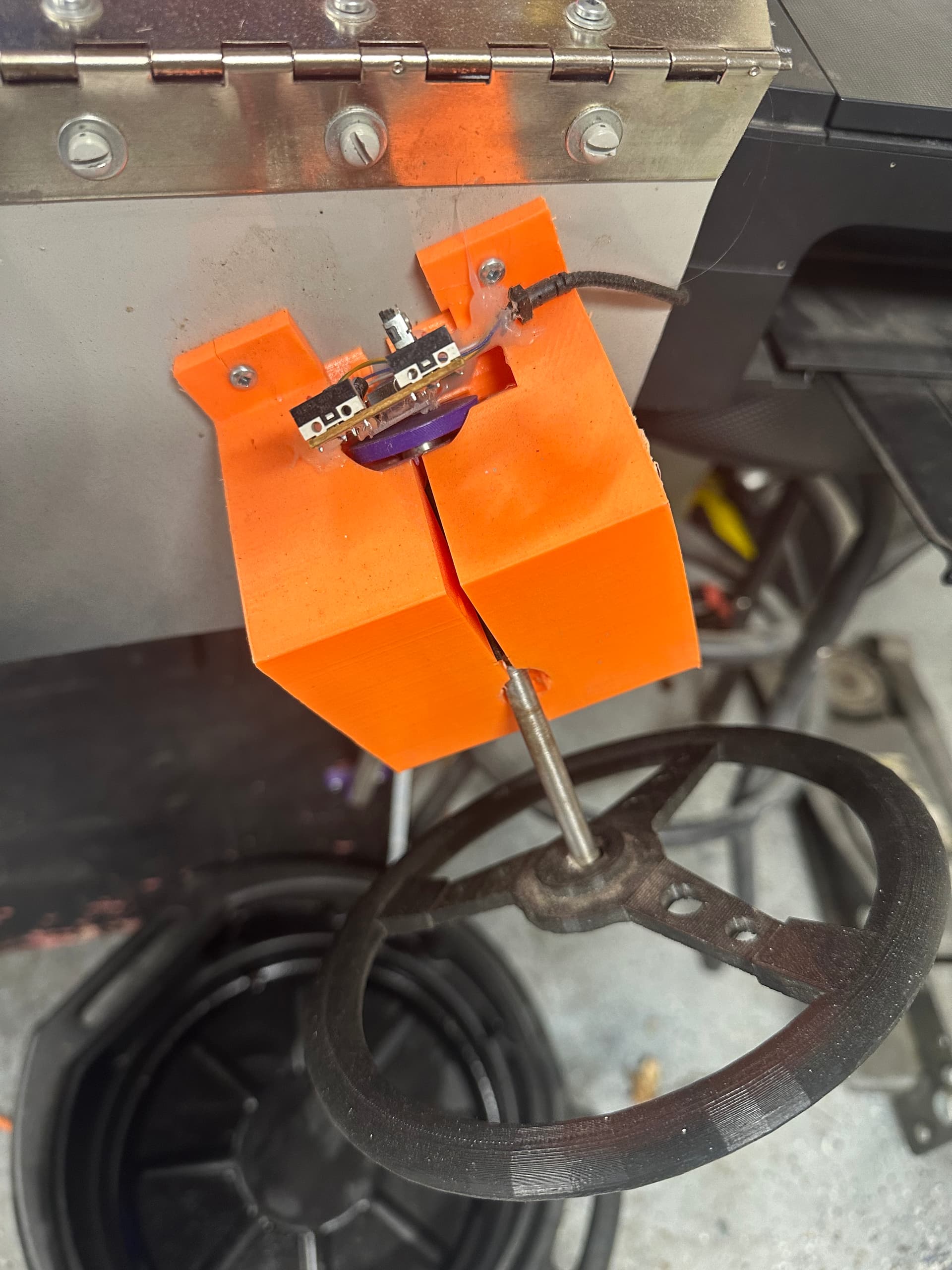

Lots of fun things you can do like use a old optical mouse and make a spinner steering wheel etc.
That lcd mounted on the side is deceptive with the mini PC strapped on the back. Nice!

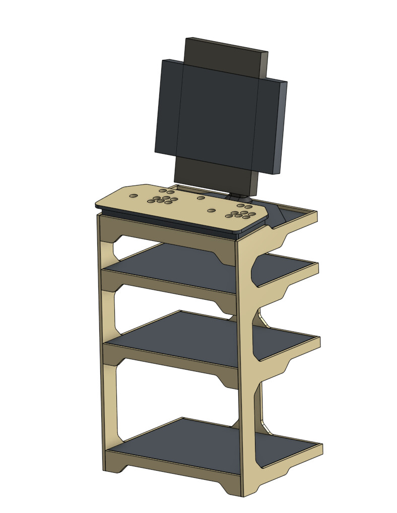

I was just about to cut this after finalizing a few sizes. Then I realized I should probably use a lot more dado’s since I have a recently surfaced CNC. All joints will probably get a 2-3mm dado. Easier assembly, and I can probably just use glue and no fasteners. Quality of life stuff.
Boring wood, maybe painted edges, and painted OSB shelves, I think. If I does not look good natural, I will just paint it later.

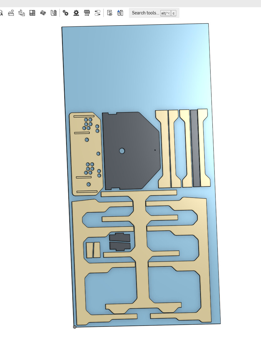

What are you using to get this layout?
That is just a onshape assembly. I made a 4x8’ sheet and used a planer mate so I can easily slide all the parts around. When I am ready to cut I will join them with a real mate and 4mm gaps (if I use a 1/8" endmill). Less wear on the end mill and easy tabs.
