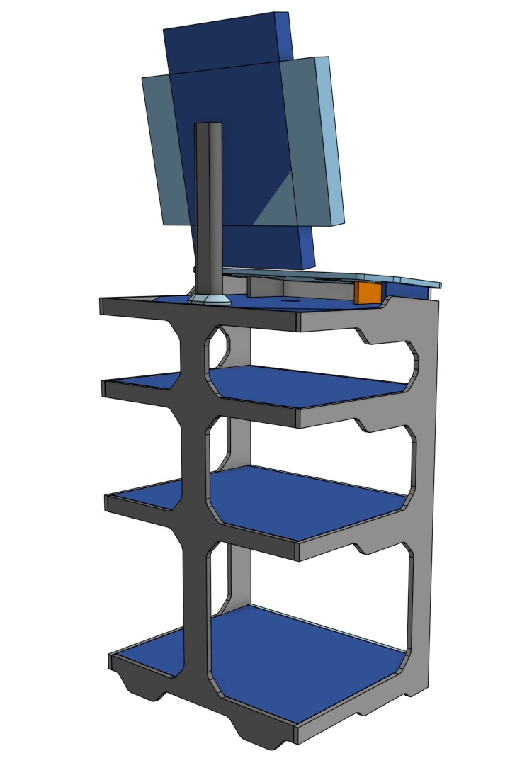

Not sure if you can call this one an arcade “cabinet”, but I think it is going to suit my use case.
Final picture will go here…if I ever finish it.
What I want
I just want some casual games, quick and fun. If I want to sit down and play for hours there are better ways to do that. So this is just games that work with an arcade joystick and 6 buttons or less. Inexpensive since I do not think it will get all that much use. Less expensive is more fun.
Design

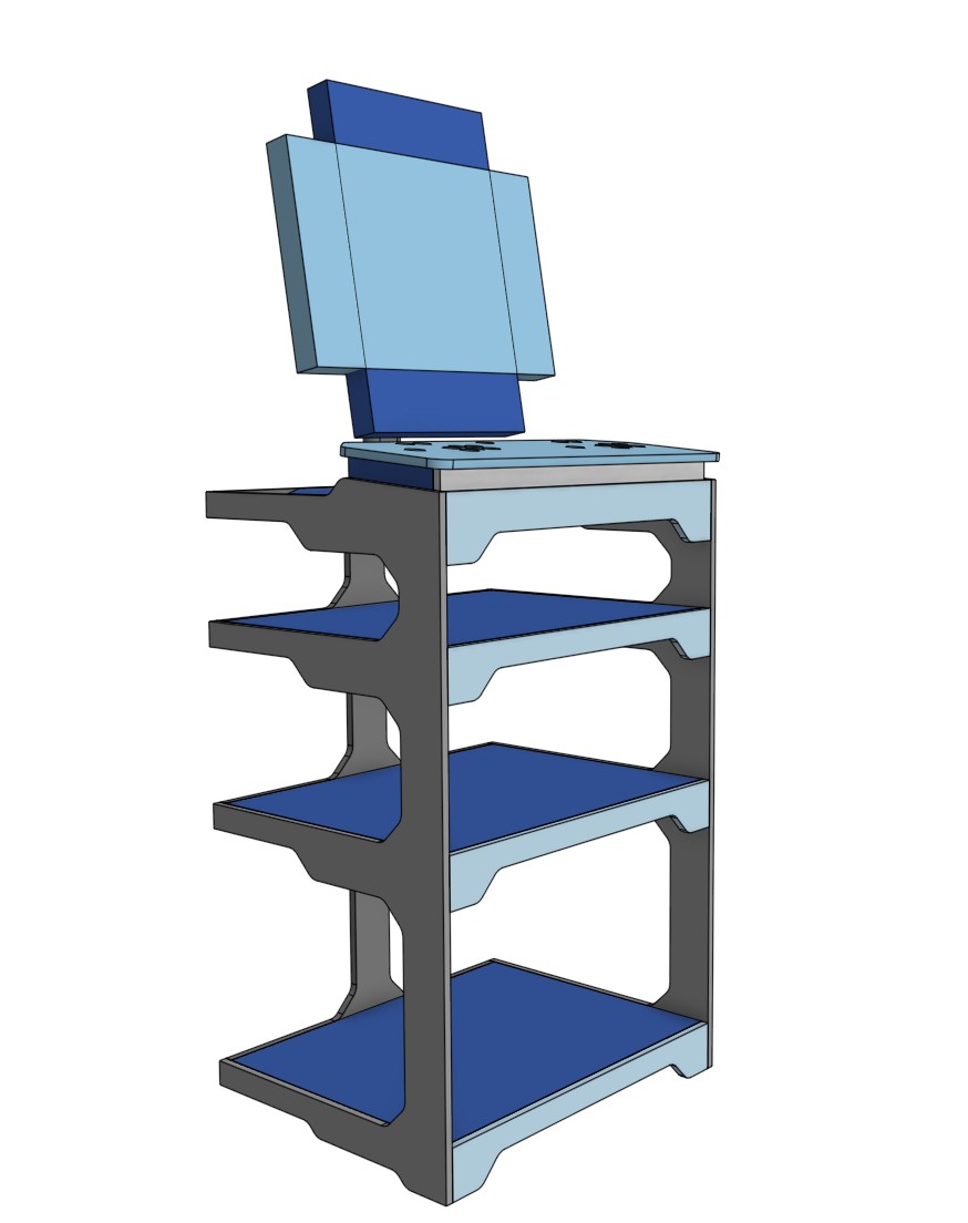

Not sure if I want table-top, or standalone so I made it convertible. Everything fits under the controls so no need for a “cabinet” so I made shelves. I wanted to be able to rotate the monitor for vertical games.
Controls are pretty wide open in the setup so I knew I would need to make a prototype. 6 buttons in case we play some fighting games though.
The top section is removable, going for a semi “space / future” vibe. That might be a fun interesting CNC project.
I will add the CAD link here when I test cut the parts…

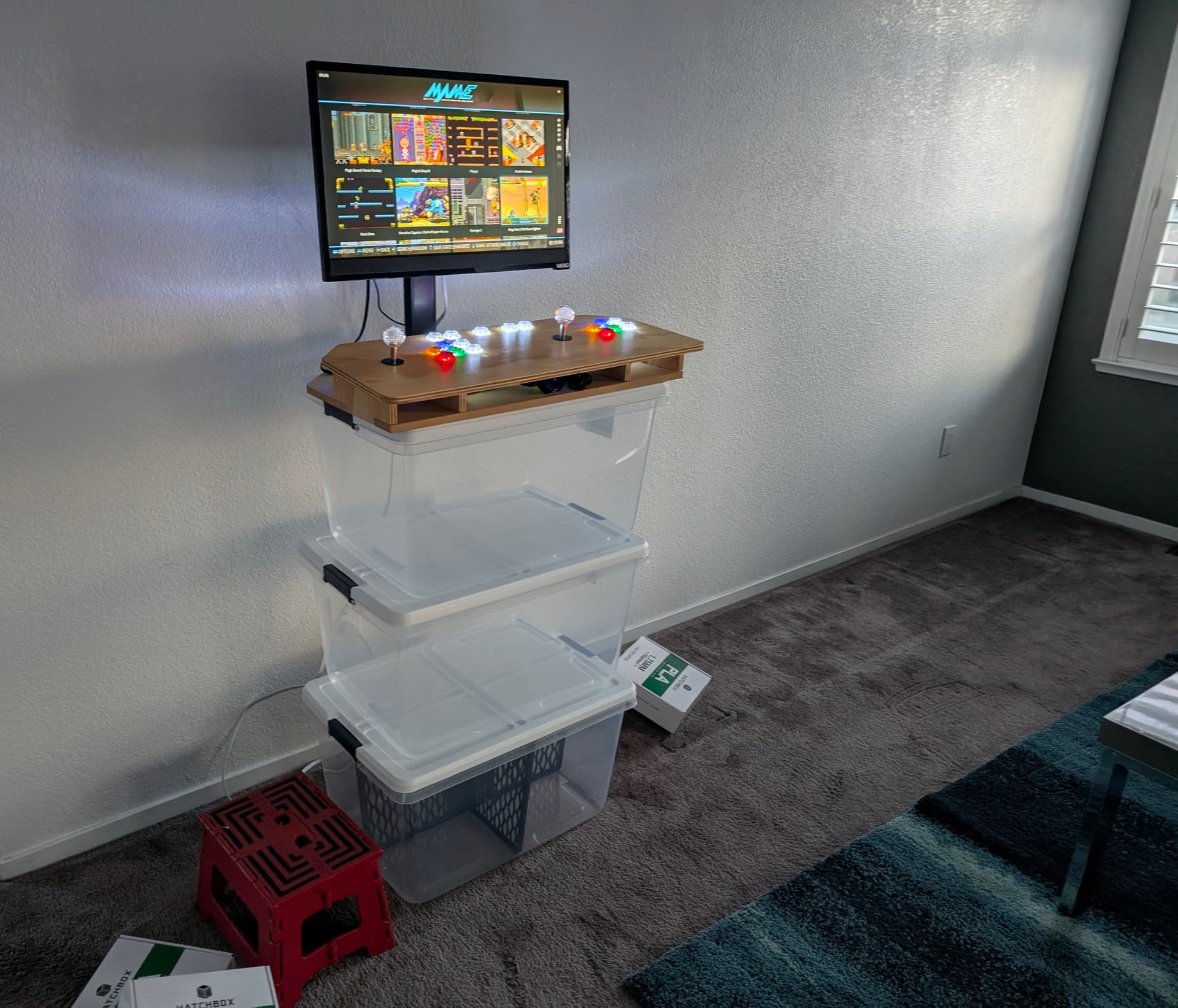

Prototype
How tall should it be? How much room do I actually need between controllers, or the edges? Is the TV too close? Control angle?
I had to whip something up and try it out.
I used the bins, filament boxes, and the stool to test different heights, and angles, and stuff.
I made the CAD semi parametric so I could easily change the biggest unknowns.
My final build! (Use TATE mode for mame rotation)

Setup
I used Batocera, I tried it out a few times and it was easy enough to install. The included scraper handles the pretty stuff very easily as well. There are some built in sorting features that are cool, vertical games, by genre, two player, decade, system.
Games are pretty easy to get these days. I did use a program to kind cull the herd a bit. I used a rom manager to sort out the top 200 ever, top form the 80 and top from the 90’s. I will start there. That leaves me with ~250 games, and I delete some stuff each time I play. Less is more in this case.
Gotchas
These are things that stumped me for a while and wasted a lot of time.
The controls are mappable, but both sides need to have the buttons in the exact same plug on both USB hubs for some reason. Random button reassignment happens otherwise. There are ports for start and select.
Map player two first, then player one. My player one has the hotkey (center button) player two does not have a hotkey.
Games that only had one joystick and buttons, might be two player but they are two play from only one set of controls. For example if I play two player dig dug, both players take turns on the player one control set. Regular two player games use both controls.
I sorted out the vertical games but still have to rotate them in the settings the first time I play them. save the settings and they will always play turned. Might be able to select them all and do it.
Hotkey and player one start are my “exit” this system buttons.
While in game hotkey and “south” button bring up a different setting menu, lots of fun stuff in there, scan lines and resolution tweaks.
Use the hotkey to shutdown the system properly as often as possible.

You can see it in the picture, that is tabletop mode. I would like to find a way to ship it though.

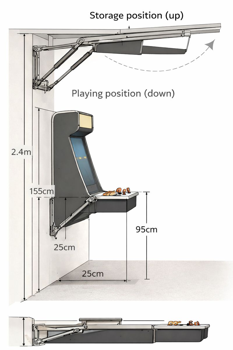

I haven´t really though about the space it takes up but I guess you could hang it with a french cleat, perhaps have it movable on the left and right direction with a rail.
Another option would be a wall mounted arcade with something foldable. Perhaps the button/joystick part could fold downwards.

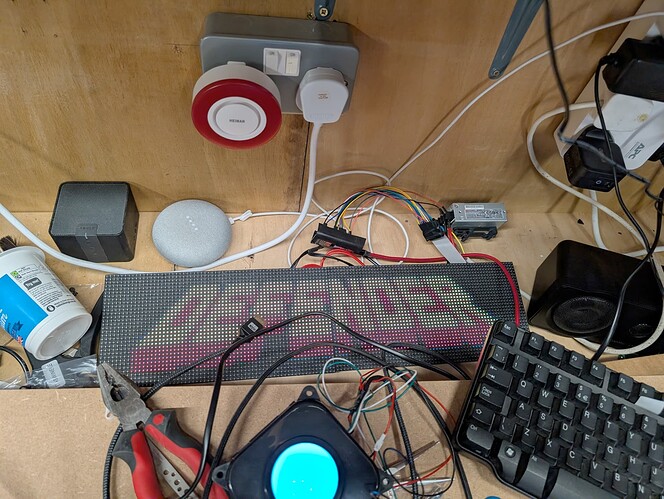

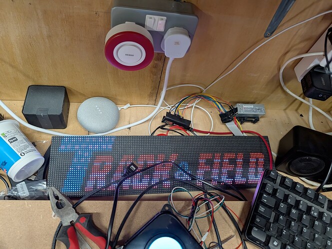

Oh I did a POC of GitHub - PPUC/ZeDMD: A real DMD for virtual pinball machines and PPUC driven real pinball machines which works quite well with Batocera too.

Did some quick ai ideas.
