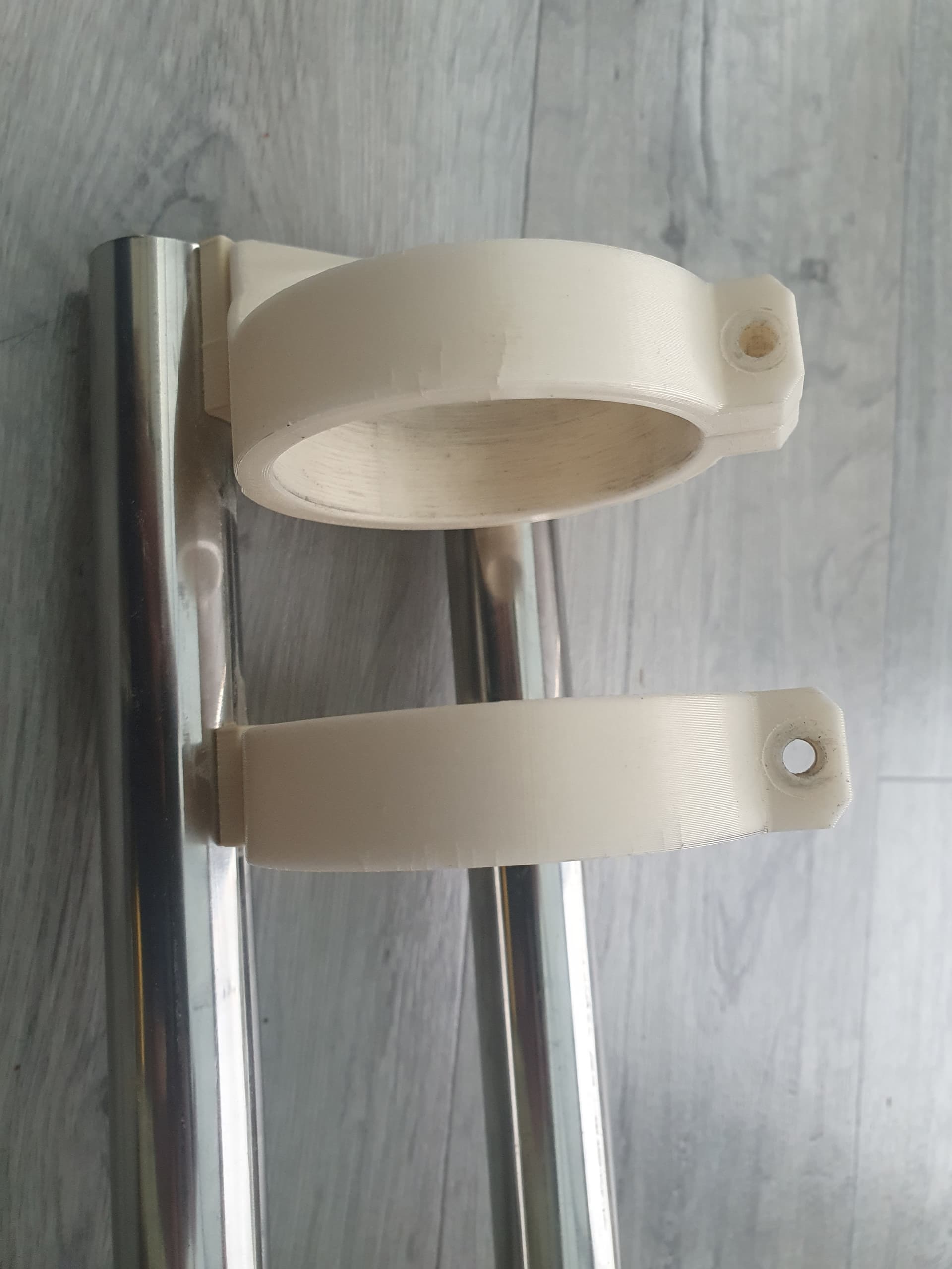

I had to emergency stop a simple wood milling job due to my MPCNC Primo Makita Rt700(X) clamps no longer holding the router tight; the router very gradually slid through the clamps whilst in use.
It seems that after a couple of years use, the two PLA clamps (45% infill) have somehow deformed so that the two end faces where the bolt goes through are now touching …see in the two photos.
This is still the case when the router is inside the clamps, with barely any space to tighten effectively.
Would the visible hair line cracks in the clamps cause this deformation? Or does PLA stretch/deform over time? Anyone got any idea please?
Yes, both.
Cracks means it has gotten brittle, and creep does happen over time. Small fast print, best to just replace it. If you need to keep using those you can add a small shim and keep going.
For a temporary fix while printing new ones, maybe a strip of thin rubber between the router and clamp, both for shimming and for grip.

Inthe years ive used mine i have had to replace the claps 2 times since the beta tests. I can’t remember how ling ago that was now but time and pressure does not make PLA into diamond :heart_eyes: But it is cheap to replace :neutral_face::sweat_smile:
