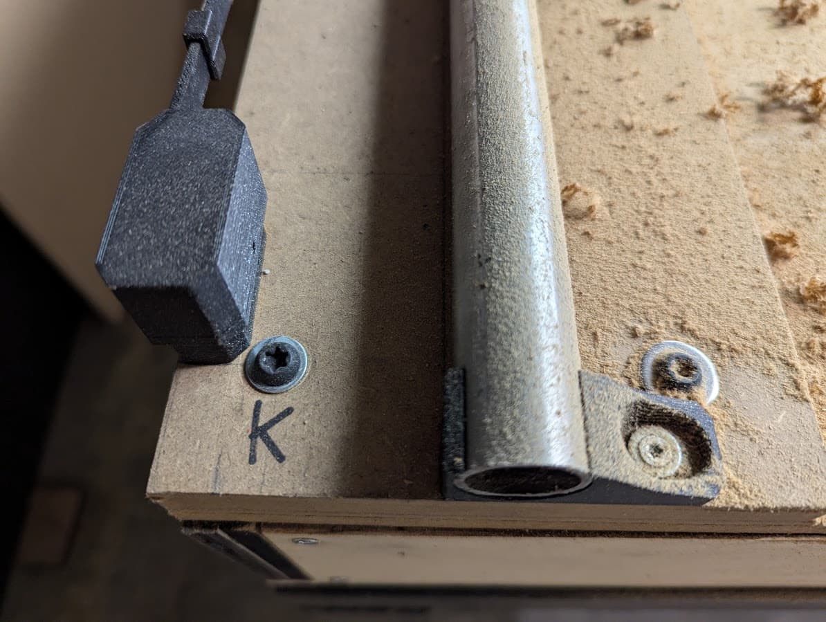

If I’m going to have to put in more bolts, how much clearance do I have for the bolt heads (I was originally thinking of getting wing bolts to make things easier)? Looking at https://docs.v1e.com/img/lr3/LR3%20Dims.jpg it seems like I’ll need to account for the gantry moving over them.
Looking at the “Fancy” pictures in the docs it seems like my best bet would be to put the bolts below the belt and in between the rail supports on the rail side, and below the belt and just inside of the gantry (next to the bearing path) on the other side? How tall can I go in these spots?
You can see in my build (Der Froschkönig - Lowrider 3 in Oldenburg, Germany - #64 by Tokoloshe) where I put most of the screws (you might also want to put some on the other side), but there is enough clearance. You could also cuntersink them a bit. I also actually left more space in between than the 20cm I said. :smiley: But not a lot.

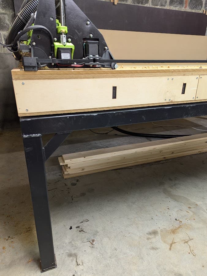

Finally got around to calibrating the machine (turns out it didn’t need it, yay for me and my precise construction :smiley:).
I’m currently in the process of milling the bed flat. I’ve ended up with 1245 x 2500mm workable area.
The side slats are attached with 10 M6 bolts each, through threaded inserts in the slats into threaded inserts in the bed, which is a big torsionbox mounted to a welded frame. I can remove or put back the machine in a few minutes when I want to go between CNC or assembly table. (I have a nice plate of what we call “betonplex” (concrete plywood?) to put on top when using it as an assembly table, both for the nice surface and to protect the bed.
I use a full 244x122 12mm plate of MDF as spoil board, which nests right between the slats.
I’ve got to say I’m amazed with what the machine can handle, it’s currently milling the bed with a 26mm face mill, 2mm step down, 10mm step over, at 1200mm/min (I started my tests with 0.1mm step down and 5mm step over, which has now been relegated as a last finishing pass).

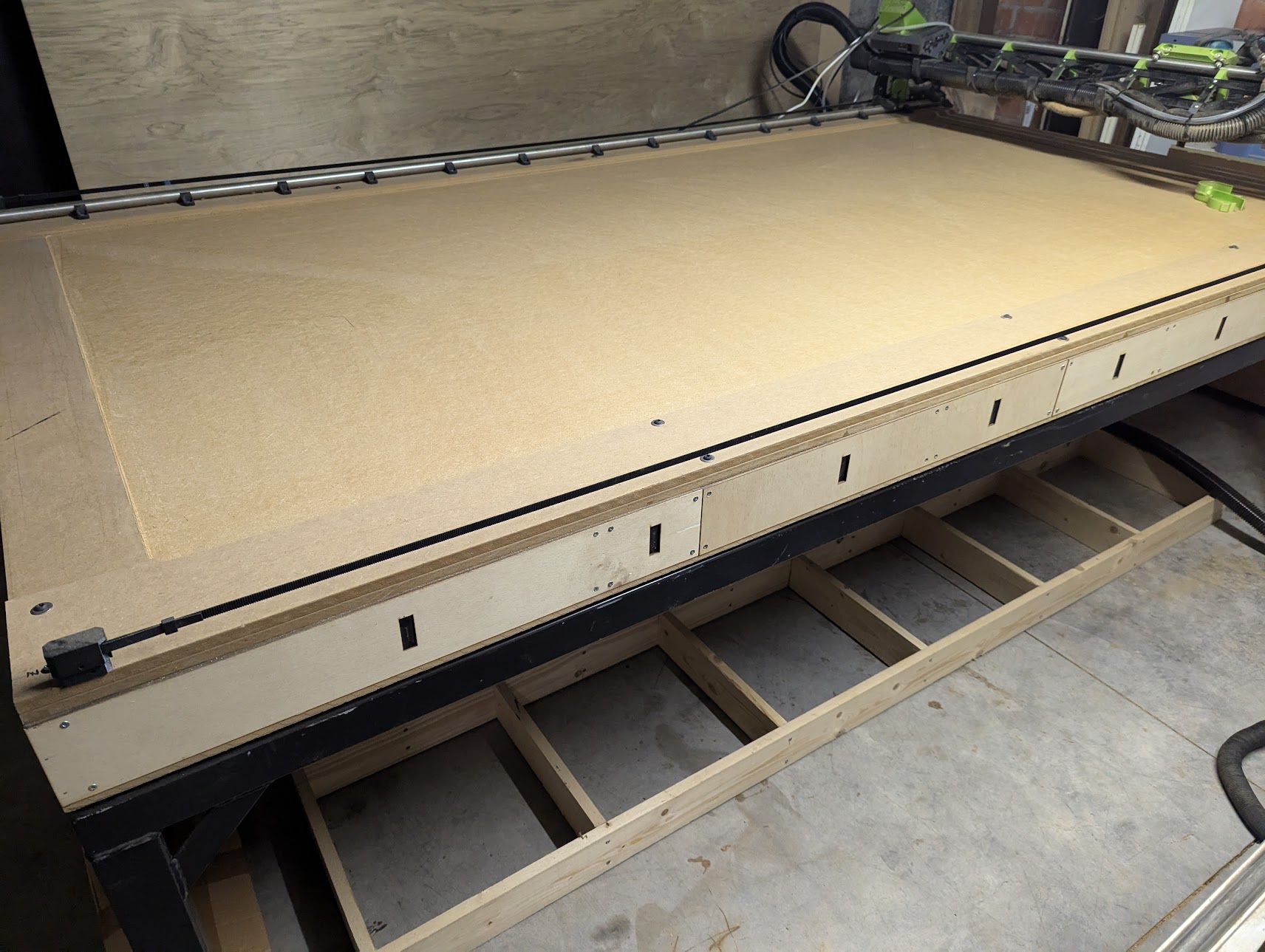

Just finished milling the bed.
I had to take a few detours, first the router needed tramming (front to back). Then my hose (which runs the other way from the documentation) was pushing the X carriage a bit away from the rails after some 20cm from X0.
But I now have a nice baby-cheek-smooth, and very level, bed :slight_smile:

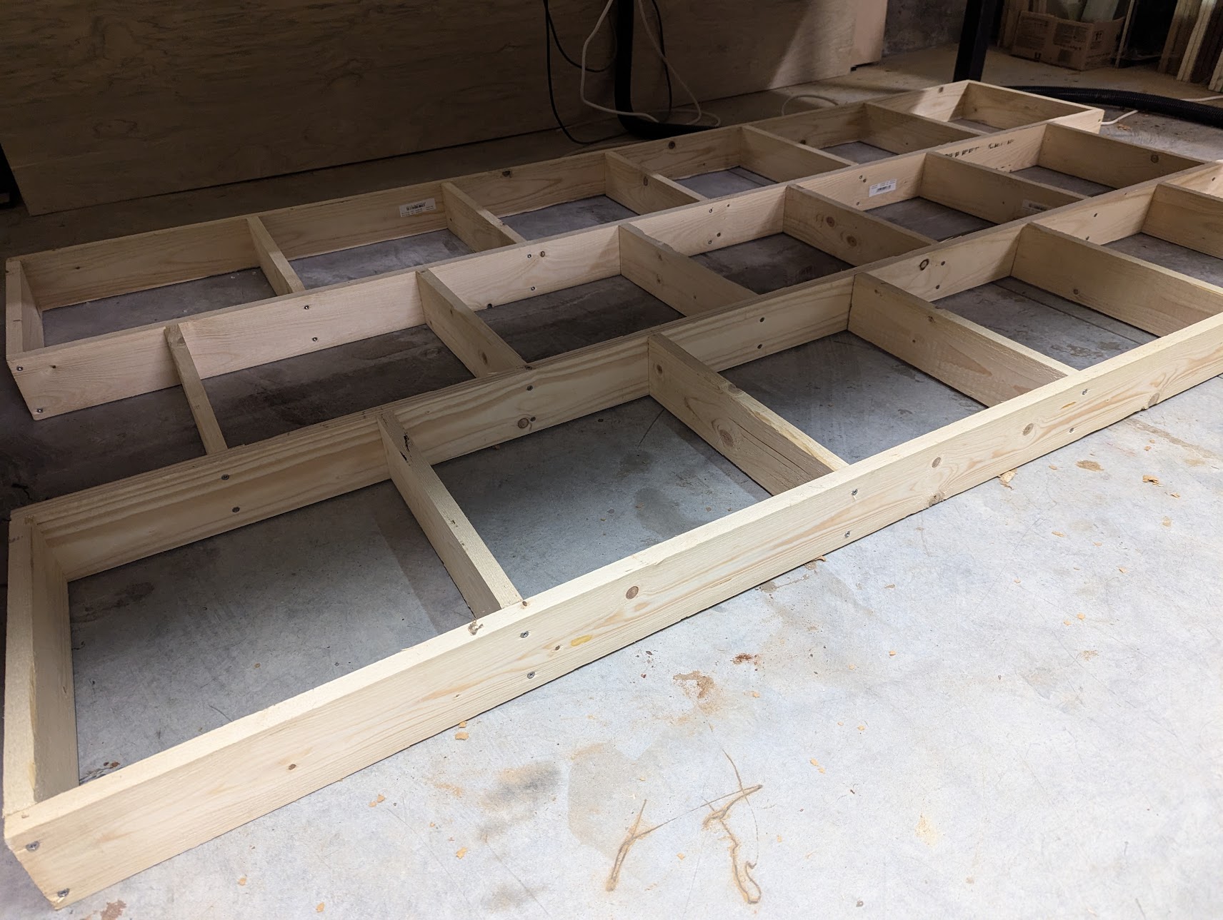

I also built a rack to store my sheet material below the router.
