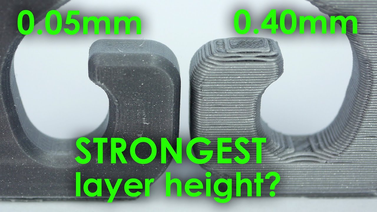

Curious how they crack, along or through layer lines? If along layer lines, have you already tweaked temp, flow, overlap, layer height and other settings to maximize part adhesion/strength? Cracking part pics appreciated
For me, for some reason matte PLA delaminates more easily than regular PLA, yet others say silky PLA causes them more problems

How about more walls and tops/bottoms? From my experience, generally adding walls and top/bottom layers does far more to increase strength vs infill. This is also supported by the science of structural engineering… because walls/tops/bottoms actually form the shell of a monocoque structure (hollow thin shell structure pretty much).
When I was slicing my first parts for my primo, I played with these settings and observed what happens to the resulting layers around critical stress areas (bolt holes, etc). With the slicer preview, you can imagine how much stronger the 4wall part might be. It takes more time and filament, but I think worth it especially if you find standard prints too weak.
CarbonX petg-cf or pla-cf are my choices for high stress parts. It’s in it’s own league as far as strength (and unfortunately price). It’s just one of those things you have to try to see what’s up. I used to break clamps with some frequency on my primo… haven’t broken a 4-wall carbonX clamp yet… and if you’ve seen my rig or some of the projects it’s done… that says a lot.

Also, adhesion seems to drop off with layer heights > 50% of nozzle width.
Haven’t done any testing, but am happy with my 0.6mm nozzle parts with 0.32mm layer height seem strong enough. Using Cura 5.0+, so slicer will vary layer width (impacting adhesion/strength) to an extent for model accuracy.
Would be interesting/insightful to see the cracks, especially if they’re happening in the same location, and maybe a look at the slicer view to understand what was extruded in those region(s).
I have watched that one a few times, I didn’t remember the 50% thing (although he did not test it on bigger nozzles. I think I need to lower my layer heights a bit now. I am at 70% ratio.
So layer height, infill density, wall thickness, temps, speeds, cooling. I need to watch the whole series again and get the “CNC Kitchen Ideal” and test a real world part of mine to see how it does as compared to how I print them now.
